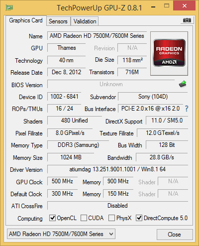

SiddRamesh Posted January 24, 2015 Share Posted January 24, 2015 Installed Windows 8.1 to dump vbios still no success used AIDA64 Extreme Edition GPU-Z (Bios not redable) Link to comment Share on other sites More sharing options...

SiddRamesh Posted January 24, 2015 Share Posted January 24, 2015 ok not that, the Model (edit your post and remove the S/N NOW) Sony Vaio E Series SVE15127CNB http://www.sony.co.in/support/product/SVE15127CN Link to comment Share on other sites More sharing options...

SiddRamesh Posted January 25, 2015 Share Posted January 25, 2015 Nope vusun how did u dumped ur VBios ROM ! GPU-Z ! Bios Not Readable Link to comment Share on other sites More sharing options...
vusun123 Posted January 25, 2015 Share Posted January 25, 2015 Nope vusun how did u dumped ur VBios ROM ! GPU-Z ! Bios Not Readable Darwin Dumper can't even do that ? Weird, the VAIO I got dumps perfectly with Darwin Dumper. GPU-Z is famous for not working with Mobility GPU, you don't know ? Link to comment Share on other sites More sharing options...
SiddRamesh Posted January 25, 2015 Share Posted January 25, 2015 can u tell me the process with DarwinDumper ! Ill try. Link to comment Share on other sites More sharing options...
vusun123 Posted January 25, 2015 Share Posted January 25, 2015 can u tell me the process with DarwinDumper ! Ill try. Check only Video BIOS and let it dump ??? 1 Link to comment Share on other sites More sharing options...

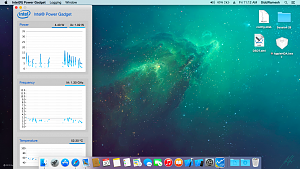

SiddRamesh Posted January 31, 2015 Share Posted January 31, 2015 M getting broken Frequency in Intel Power Gadget.Is it OK And also this !1/30/15 10:26:07.000 AM kernel[0]: X86PlatformPlugin::setRingTable - AICPM failed to load ring table with status 0x0: Get=0, Load=0, Install=01/30/15 10:26:07.000 AM kernel[0]: X86PlatformPlugin::configResourceHandler - Failed to set ring table!1/30/15 10:26:07.000 AM kernel[0]: IOPPF - Found another boot volume.SuperIODevice: [Fatal] found unsupported chip! ITE sequence ID=0xffff, Winbond sequence ID=0xfc111/30/15 10:26:07.000 AM kernel[0]: [AGPM Controller] unknownPlatform1/30/15 10:26:07.000 AM kernel[0]: IOPPF: AppleIntelCPUPowerManagement mode1/30/15 10:26:07.000 AM kernel[0]: X86PlatformShim::sendPStates - Success!1/30/15 10:26:07.000 AM kernel[0]: X86PlatformShim::sendPStates - Success!1/30/15 10:26:07.000 AM kernel[0]: X86PlatformShim::sendPStates - Success!1/30/15 10:26:07.000 AM kernel[0]: X86PlatformShim::sendPStates - Success!1/30/15 10:26:08.000 AM kernel[0]: X86PlatformShim::sendStepper - Done!Is Everything OK Link to comment Share on other sites More sharing options...
midi-sama Posted January 31, 2015 Author Share Posted January 31, 2015 Send us the whole AICPUPMInfo.kext log. ALL OF IT. Link to comment Share on other sites More sharing options...
