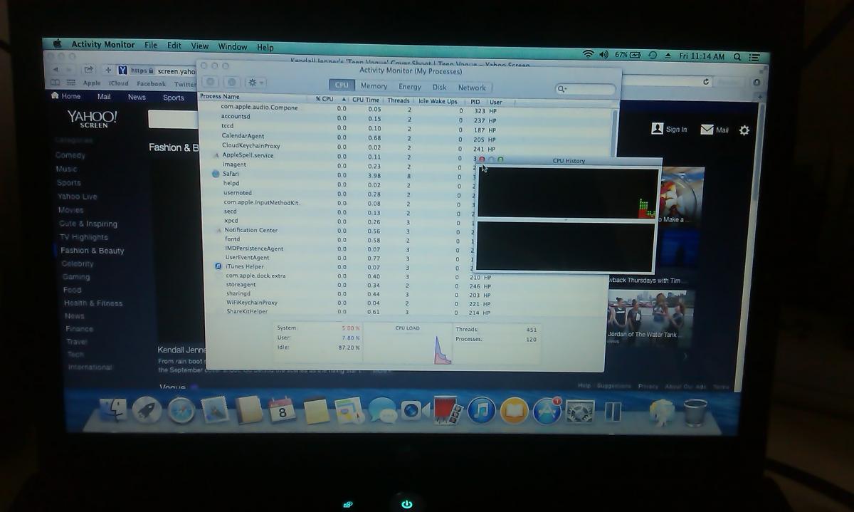

Then using CPUS=1,successfully installed, with VodooHDA for Sound, Drivers for ATI4330 and change of 80211IOfamily for AR9285,Smart Battary.Now the MAC os can recognize the dual core and works with only one core which is slow of course.
Well, I know there is no Cool and Quiet support in Mavericks, so one core is working at full speed without dynamic adjusting it's frequency.
One core is really slow, when playing some online videos, it has only sound with still image and this works well in WIN7.

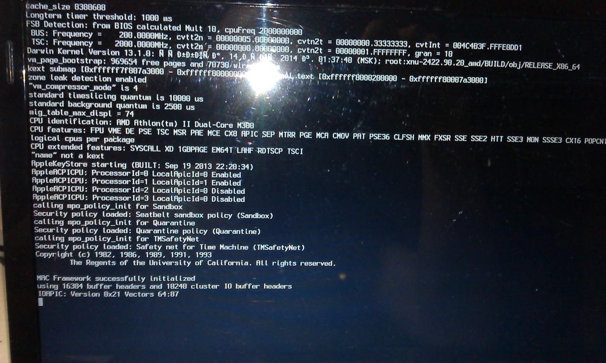

1. INSTALL VodooTSCSyncAMD.kext,it showed started,then hangs at IOAPIC VERSION: 0x21 Vectorss 64:87.

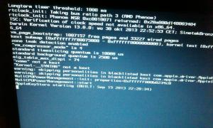

2. Install Chameleon in MAC partition,change it into primary partition and activate it.Hangs at AppleStore starting.Install the
    patch /Extra/modules/KernelPatcher.dylib,still hangs at "AppleStore starting". I guess the patch is for intel CPU, other users of HP with intel CPU have made it work.

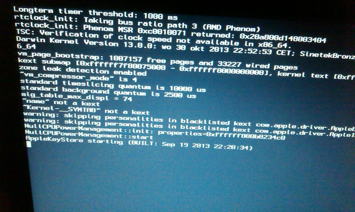

3 Change other kernels from Sinetek V6 or Andy R9, all recognize the CPU as Phenom and got kernel panic even with CPUS=1.
