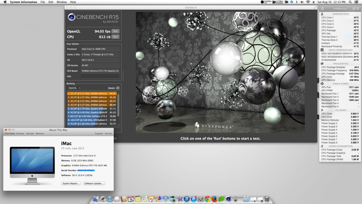

I just finished my new mini-ITX build this week
here are the main components :
  1. Asus Z97i-Plus Motherboard
  2. Intel Core i5-4690
  3. Asus GTX 770 DirectCU II
  4. Corsair 8GB RAM
Install configuration :
  1. Using Apple Store installer
  2. Clover bootloader (v2k r2795) check file below
  3. VoodooHDA (VoodooHDA_V286_MAV.pkg found in on sourceforge)
  4. iMac 14,2 smbios
what works :
  1. The Wi-Fi card + Bluetooth + Ethernet
  2. GTX 770 (this is just works, I think you need disable the intelHD on the bios )
  3. Sound (using VoodooHDA)
  4. Native Power Management, generate using clover
  5. Sleep (I think it works)
This is the best hackintosh build that I made so far
I hope this information useful for some peoples

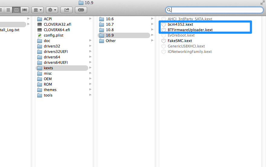

clover-EFI-folder.zip
Thanks, just saw that.. works like a champ.
I am confused though now.  I just used your EFI files.. I had Ethernet enabled by using the AppleIntelE1000e.kext.  You don't have that, yet networking is working fine now.  Did you do something in the config.plist to get networking to work?  I'm just confused as to why this is working now with no AppleIntelE1000e.kext.
Thanks
Thanks
I enable FixLAN_2000 on the config file
so clover fix/patch your DSDT for the Ethernet to work
There are also "IONetworkingFamily.kext" on the kext folder
I think I read somewhere on the forum about this :P

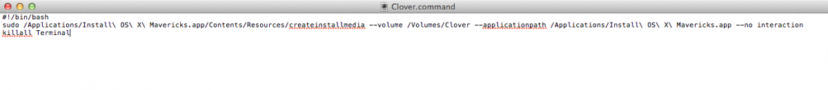

This is how I made my installer
http://youtu.be/ewC_zeQxx4Y
good luck

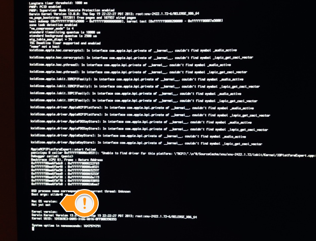

I saw you screenshot, I see that the problem is this line
can you send me another screenshot of the clover screen.
When clover boot there will be some icon for the HDD and some smaller icon
go to the smaller icon that says "Options" and then go to DSDT fix mask
there will be some long checklist, take that screenshot

Hey,
Unfortunately, no more luck...
I have followed your video step by step. Except the one where you launch the rampagedev command line, I assume it's the famous "sudo [..] createinstaller [..]" command line to copy the MacOSX Mavericks Installer into the Clover GUID partition in that case (I already performed so and it's taking sooooo much time....)
Here are the settings I changed right after I reloaded my BIOS defaults:
  • AI Tweaker/X.M.P Profile = Auto
  • Advanced/USB Config/xHCI Mode = Auto
  • Advanced/System Agent Config/Graphics Config/Primary Display = PCIE
  • Advanced/System Agent Config/CPU Config/Intel Virtualization = Disabled
  • Boot/Secure Boot/OS Type  = Other OS
  • Boot/CSM Launch = Disabled
I have also tried disabling everything from the BIOS:
  • Bluetooth
  • WiFi
  • Both Ethernet Controllers
I copied the Kext files as shown in your video, the only thing is you package seems to be missing the following files:
  • AHCI...3rdP....SATA.kext
  • ExOreboot.kext
  • GenericUSBXHCI.kext
  • IONetworkingFamily.kext
My EFI/Clover/Kexts/10.9/ folder contains only the following files:
  • bcm4352.kext
  • BTFirmwareUploader.kext
  • FakeSMC.kext
And my EFI/Clover/Drivers64UEFI folder the exact same files as per your video.
I edited the config.plist and replaced nvdia_drv=1 by -v to get to verbose mode everytime.
It's stuck right after it shows my root UUID number...
My DSDT fix mask shows the following selected (a little plus sign)
  • Drop_DSM : 0x0000
  • AddDTGP
  • Fix Darwin
  • Fix Shutdown
  • Fix HPET
  • Add SMBUS
  • Fix Display
  • Fix LAN
  • Fix Sound
  • Fix Regions
I'm using my 2 x 4GB RAM modules, I shall try to use just one, but I'm pretty sure I'll get the same ... nothing...
What am I doing wrong...

yes the command line is pretty much for copy the installer to usb stick
