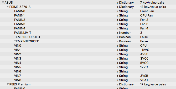

unixb0y Posted December 9, 2020 Share Posted December 9, 2020 (edited) Hmm something's off with my fan stats. I had it working a long while ago, then it somehow stopped working (HWMonitorSMC 2.x). With the latest Kext files and HWMonitorSMC 1.X (?) I now do get the three fans that I have connected in my system (actually 4 but on 3 fan headers) but all display probably the maximum value in the data type used (14 bit data type? weird But it's exactly 2^14-1 on all fans) : Spoiler I did copy over my W836X config that worked in the past: Spoiler EDIT: I just realized that it doesn't even pick up the "ASUS" config, instead using "Default".. Weird. Might need to post in though. Edited December 9, 2020 by unixb0y Link to comment Share on other sites More sharing options...
Slice Posted December 9, 2020 Author Share Posted December 9, 2020 To pick up ASUS name you have to use DataHubDxe.efi. It has become fashionable to call it unnecessary. Link to comment Share on other sites More sharing options...

Slice Posted December 9, 2020 Author Share Posted December 9, 2020 In this case I can't guaranty sensors will see ASUS name. It sent by Clover through DataHub protocol. I may propose you to write your sensors configuration as default one. Link to comment Share on other sites More sharing options...
unixb0y Posted December 9, 2020 Share Posted December 9, 2020 Okay :-) Yeah that would be an idea, to paste it into "default". I did try it, but the readings were still 2^14-1 :/ Link to comment Share on other sites More sharing options...
