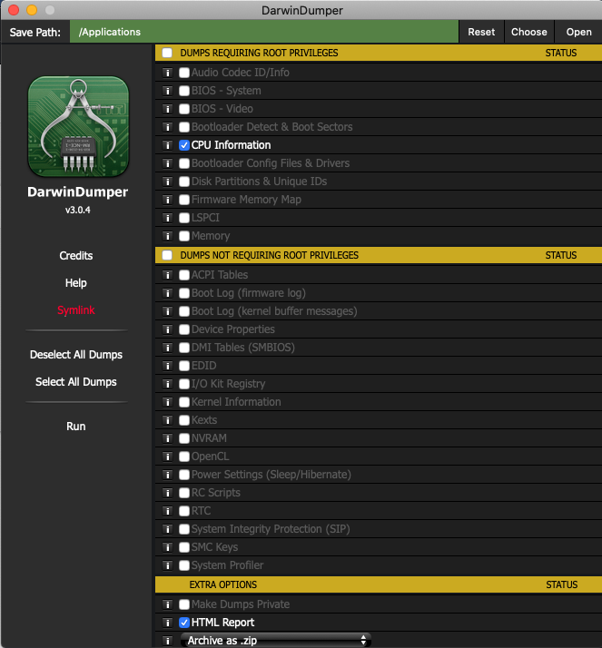

9 hours ago, tyufhl said:
@vector sigma hi, after the launch of DarwinDumper / CPU 2077731448_2020-01-2322_04_32.png.7c4ab1ff3615431c17ec53f828b3f261.pngsuch a picture
DarwinDumper contains Pike R. Alpha's' AppleIntelInfo.kext v2.9. which is very wrong and dangerous.
Exclude it from
/DarwinDumper.app/Contents/Resources/public/drivers/AppleIntelInfo.kext
Move to trash!

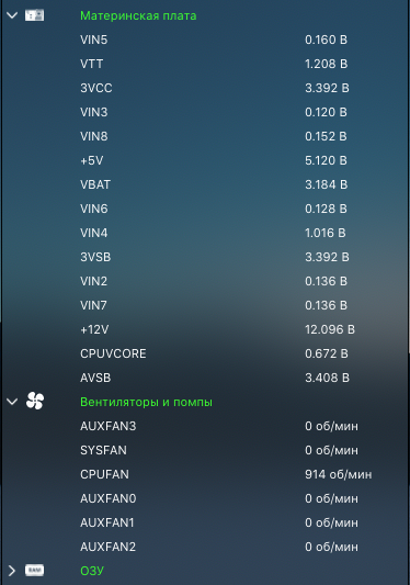

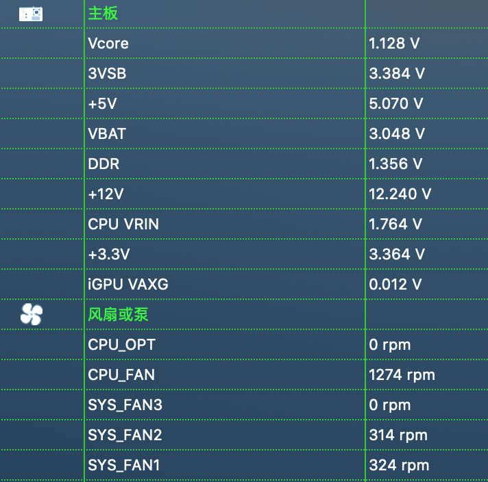

On 1/22/2020 at 7:18 AM, jinbingmao said:
On 1/22/2020 at 7:26 AM, Andrey1970 said:
Thanks, but wait a moment. If we are going to create a database, we need rules naming things:
1)
SYS_FAN2 or Sys Fan 2?
What is CPU_OPT?
What to do with unconnected sensors? My NTC sensor has more fans than the motherboard have, so I'm going to skip the sensor:
Is that the case for your CPU_OPT? I mean, if the LPC chip has has an unused line (no connector on the motherboard), this must be skipped.... my 2 cents.
2) if we have a convention for naming things, and we follow it, the app can translate SYS_FAN2 (or Sys fan 2) into your native language.
What do you think?

It can be done at app initialization, in alphabetical order, what ever will be. I'll take a look on it when I have more time with out priority.

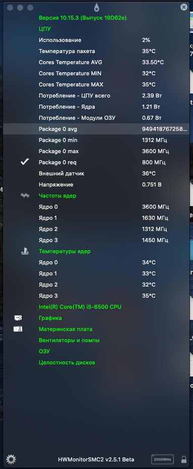

On 1/23/2020 at 1:03 AM, Mike Ranger said:
Ideally, HWSensors could be configured (e.g. by plist) to only show values of interest.
So I can select what information I can display in what order.
As an example... most fans are not active or relevant, so it makes a lot of sense to only pick the relevant ones.
That is why I say we need rules. Once a configurations is made, that configuration must contains all the fans that a motherboard can really have: you cannot have the chassys Fan for your own purpose (the noise) but the configuration must include it because this will help other users.
Later I'll add the possibility to load a config from the nvram (a path to a plist), so anyone can customize even more names or skip unused sensors. This can be usefull when you doesn't have Fans... but Pumps.

I wrote as on the motherboard. CPU_OPT it for cpu pump or cpu fan2.
Parameter skip is good idea.
I offer such names:
System Fan Х
CPU Fan Х

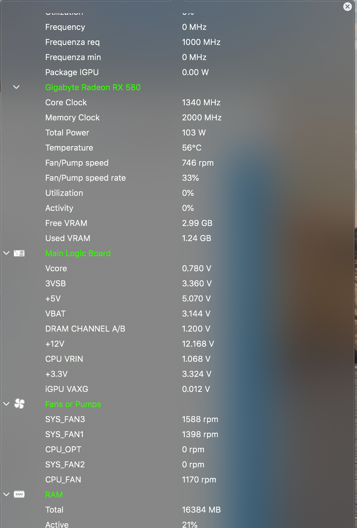

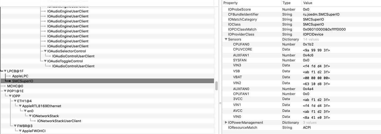

16 hours ago, vector sigma said:
@Slice, I propose to do that as well:
429681868_Schermata2020-01-24alle13_23_23.thumb.png.555b2951f97b361904e5000f4ad4d8b2.png
maybe we can switch from smc keys to that using a boot flag  ..like '-hwnokeys'

5 hours ago, Slice said:
Real Macs have SMC keys for FAN, temperatures, voltages.
Why we should take values from ioreg data that absent in real Mac?
Oh no, I did not suggest to abandon SMC keys, otherwise third party Monitors will stop working, of course. But I ask for a possibility to do that (with a boot flag? and switch from fakeSMC->callPlatformFunction to something else?) and so reuse common configurations (Raw data should be the same, I guess)...  which I see peoples start posting... .
Other than that there will be no encoding and so no decoding, no open and closed of the smc driver, with a little visible cpu usage in less (is not my imagination, in my lappy is).
P.S. HWMonitorSMC2 looks (once) for a children of IOPCIDevice->LPCB that contains "Sensors", if present, it will not search for SMC keys. Will do it otherwise, as usual.
