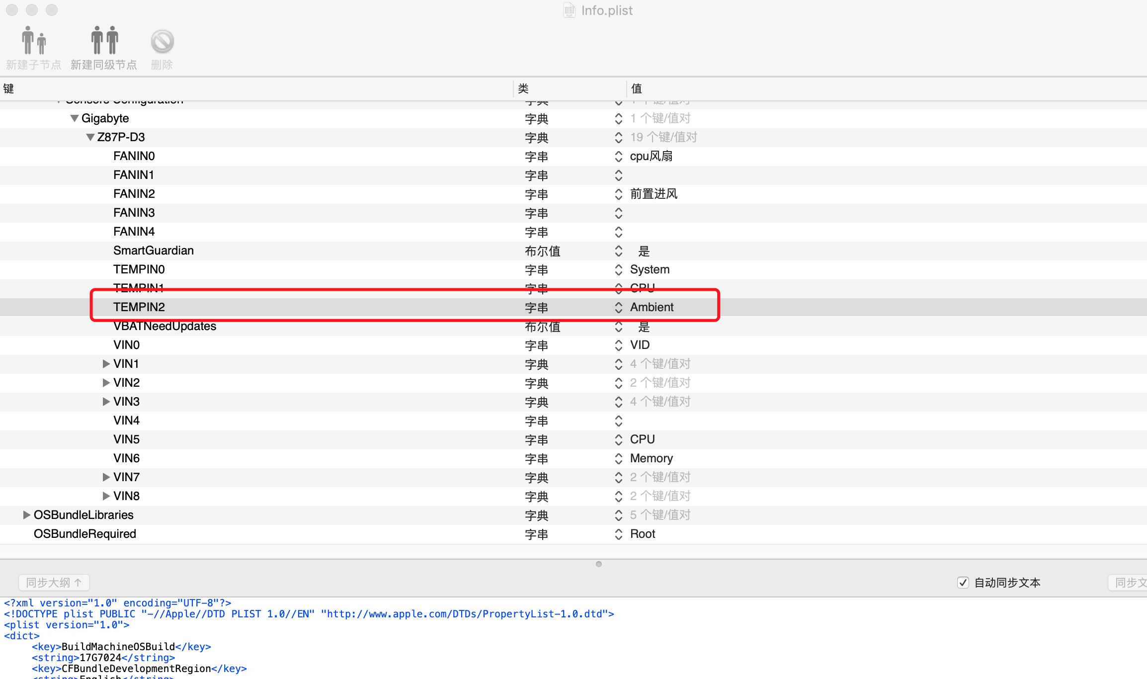

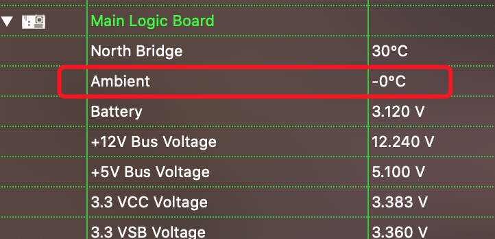

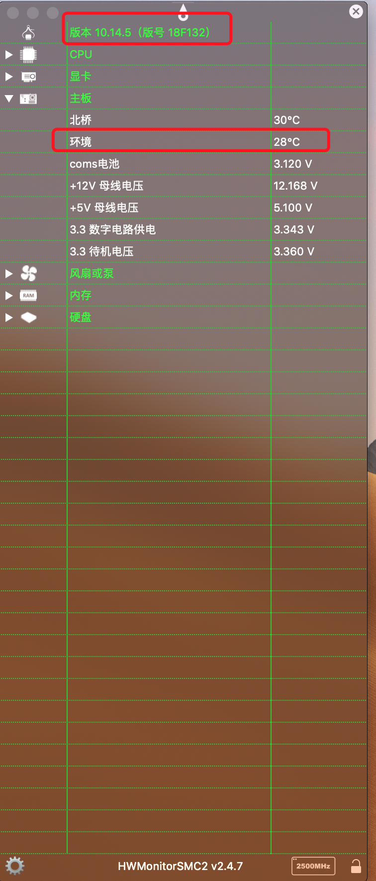

Loss of key after awakening。 The computer restarted and returned to normal。2.png
Edited by jinbingmao
Suppose you have this controller with an input pin where you expected to see an ambient temperature value.
To do this you have to be sure there is an thermodiod which actually measures the temperature of environment and is connected to this input pin. I am not sure if the thermodiod exists.
Existence before sleep, loss after awakening.
There were no problems in earlier versions.
