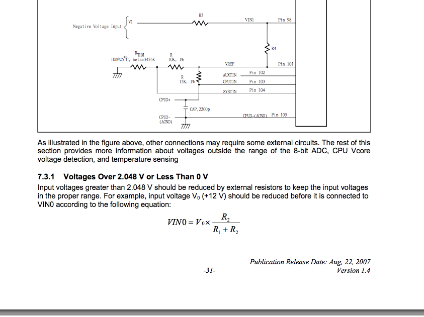

Slice Posted May 20, 2016 Author Share Posted May 20, 2016 I have several news here. Revision 32. * HWMonitoSMC.app - added observation for AVCC voltage (+3.3V) * Added temperature sensor for AMD Radeon Hawaii family * Added possibility to define nominator/denominator for voltages with Winbond/Nuvoton chips. It was only for ITE early. Explanation in datasheet RadeonMonitor.kext.zip W836x.kext.zip HWMonitorSMC.app-1.2.2.zip Or full installer HWSensors3-rev32.pkg.zip Link to comment Share on other sites More sharing options...

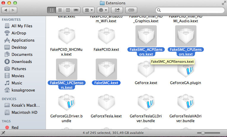

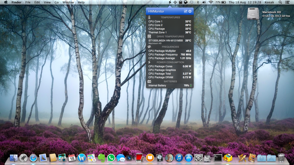

kosakgroove Posted August 18, 2016 Share Posted August 18, 2016 Slice, what is the difference between HWSensors normal branch and your HWSensors 3 when speaking about an ASUS X550LDV? They work fine right now, Does your version of FakeSMC have advantages, fixes and updates? If so, what should I install for Mavericks in this laptop? Some other HWSensors installations have rendered the Hack useless, so I will proceed to do a Manual installation , following your expected guidance and your advice on what plugins to install. Thanks Sergei Link to comment Share on other sites More sharing options...
Slice Posted August 18, 2016 Author Share Posted August 18, 2016 My FakeSMC+plugins+HWMonitor works from 10.6.8 up to 10.12 Public Beta. This is an advantage #1. I don't know if you got any difference changing from working version to another version. My version is updated to recent hardware but also not for all. Link to comment Share on other sites More sharing options...
kosakgroove Posted August 18, 2016 Share Posted August 18, 2016 So for a laptop with i7 and HD4400, running Mavericks, ASUS X550LDV, what plugins should I choose? Link to comment Share on other sites More sharing options...
Slice Posted August 19, 2016 Author Share Posted August 19, 2016 So for a laptop with i7 and HD4400, running Mavericks, ASUS X550LDV, what plugins should I choose? It's a pity very few sensors can be observed on laptops. HWInfo - this is just a part of FakeSMC IntelCPUMonitor ACPIMonitor - this required manual DSDT editing. [HOWTO] ACPI access for monitoring My HWMonitorSMC works in Sierra without problem 1 Link to comment Share on other sites More sharing options...
kosakgroove Posted August 23, 2016 Share Posted August 23, 2016 It's a pity very few sensors can be observed on laptops. HWInfo - this is just a part of FakeSMC IntelCPUMonitor ACPIMonitor - this required manual DSDT editing. [HOWTO] ACPI access for monitoring My HWMonitorSMC works in Sierra without problem Screen Shot 2016-08-19 at 07.48.45.png What about AppleSMC.kext? should I install that as well? Link to comment Share on other sites More sharing options...
Slice Posted August 23, 2016 Author Share Posted August 23, 2016 What about AppleSMC.kext? should I install that as well? No, there is antispam version needed for some DP OSes. Link to comment Share on other sites More sharing options...
