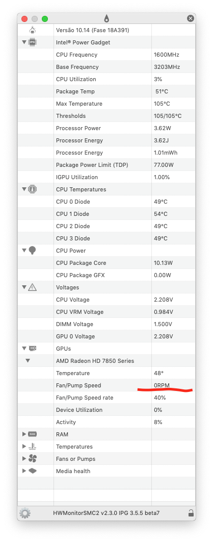

JorgeMax Posted October 21, 2018 Share Posted October 21, 2018 Vector. Here only the GPU fan monitoring and management of the VRAM of the board does not appear, the rest is normal: Spoiler Last login: Sat Oct 20 13:05:29 on console iMac-de-Jorge:~ jorge$ /Volumes/Arquivos/Downloads/Safari/smcdumpswift ; exit; smcdumpswift v1 beta, vector sigma 2018 key: #KEY, code: 592135513, size: 04, type: ui32 [1969828658], attr: 00, value: <00000052> key: FNum, code: 1179546989, size: 01, type: ui8 [1969829920], attr: 00, value: <05> key: HWS0, code: 1213682480, size: 08, type: ch8* [1667774506], attr: 00, value: <47696761 62797465> key: HWS1, code: 1213682481, size: 07, type: ch8* [1667774506], attr: 00, value: <5a373750 2d4433> key: RPlt, code: 1381002356, size: 08, type: ch8* [1667774506], attr: 00, value: <64380000 00000000> key: RBr , code: 1380086304, size: 08, type: ch8* [1667774506], attr: 00, value: <64380000 00000000> key: TC0D, code: 1413689412, size: 02, type: sp78 [1936734008], attr: 00, value: <3300> key: TC1D, code: 1413689668, size: 02, type: sp78 [1936734008], attr: 00, value: <3700> key: TC2D, code: 1413689924, size: 02, type: sp78 [1936734008], attr: 00, value: <3400> key: TC3D, code: 1413690180, size: 02, type: sp78 [1936734008], attr: 00, value: <3400> key: TCAD, code: 1413693764, size: 02, type: sp78 [1936734008], attr: 00, value: <3700> key: MlC0, code: 1298940720, size: 02, type: fp88 [1718630456], attr: 00, value: <1000> key: CC0C, code: 1128476739, size: 04, type: ui32 [1969828658], attr: 00, value: <00000640> key: MlC1, code: 1298940721, size: 02, type: fp88 [1718630456], attr: 00, value: <2100> key: CC1C, code: 1128476995, size: 04, type: ui32 [1969828658], attr: 00, value: <00000ce4> key: MlC2, code: 1298940722, size: 02, type: fp88 [1718630456], attr: 00, value: <2100> key: CC2C, code: 1128477251, size: 04, type: ui32 [1969828658], attr: 00, value: <00000ce4> key: MlC3, code: 1298940723, size: 02, type: fp88 [1718630456], attr: 00, value: <1000> key: CC3C, code: 1128477507, size: 04, type: ui32 [1969828658], attr: 00, value: <00000640> key: CCPA, code: 1128484929, size: 04, type: ui32 [1969828658], attr: 00, value: <00000b87> key: PCTR, code: 1346589778, size: 02, type: sp78 [1936734008], attr: 00, value: <0dca> key: PCPC, code: 1346588739, size: 02, type: sp78 [1936734008], attr: 00, value: <07ec> key: PCPG, code: 1346588743, size: 02, type: sp78 [1936734008], attr: 00, value: <0000> key: TZ0C, code: 1415196739, size: 02, type: sp78 [1936734008], attr: 00, value: <1bcc> key: TZ1C, code: 1415196995, size: 02, type: sp78 [1936734008], attr: 00, value: <1dcc> key: $Adr, code: 608265330, size: 04, type: ui32 [1969828658], attr: 00, value: <00000300> key: $Num, code: 609121645, size: 01, type: ui8 [1969829920], attr: 00, value: <01> key: ACID, code: 1094928708, size: 08, type: ch8* [1667774506], attr: 00, value: <85fc044d d8127af4> key: ALI0, code: 1095518512, size: 04, type: {ali [2069982313], attr: 00, value: <07010200> key: ALRV, code: 1095520854, size: 02, type: ui16 [1969828150], attr: 00, value: <0001> key: ALV0, code: 1095521840, size: 10, type: {alv [2069982326], attr: 00, value: <01100675 012000b6 0ee0> key: LsNM, code: 1282625101, size: 01, type: ui8 [1969829920], attr: 00, value: <01> key: LsbV, code: 1282630230, size: 05, type: {rev [2071094646], attr: 00, value: <01040a00 06> key: MSLD, code: 1297304644, size: 01, type: ui8 [1969829920], attr: 00, value: <00> key: MSSD, code: 1297306436, size: 01, type: si8 [1936275488], attr: 00, value: <05> key: MSSP, code: 1297306448, size: 01, type: si8 [1936275488], attr: 00, value: <05> key: NATJ, code: 1312904266, size: 01, type: ui8 [1969829920], attr: 00, value: <02> key: OSK0, code: 1330858800, size: 32, type: ch8* [1667774506], attr: 00, value: <6f757268 61726477 6f726b62 79746865 7365776f 72647367 75617264 6564706c> key: OSK1, code: 1330858801, size: 32, type: ch8* [1667774506], attr: 00, value: <65617365 646f6e74 73746561 6c286329 4170706c 65436f6d 70757465 72496e63> key: REV , code: 1380275744, size: 06, type: {rev [2071094646], attr: 00, value: <02110f00 0016> key: RMde, code: 1380803685, size: 01, type: char [1667785074], attr: 00, value: <41> key: RVBF, code: 1381384774, size: 06, type: {rev [2071094646], attr: 00, value: <01300f00 0003> key: RVUF, code: 1381389638, size: 06, type: {rev [2071094646], attr: 00, value: <01300f00 0003> key: BEMB, code: 1111838018, size: 01, type: flag [1718378855], attr: 00, value: <00> key: EPCI, code: 1162888009, size: 04, type: ui32 [1969828658], attr: 00, value: <06900700> key: Tm0P, code: 1416441936, size: 02, type: sp78 [1936734008], attr: 00, value: <2c00> key: TP0D, code: 1414541380, size: 02, type: sp78 [1936734008], attr: 00, value: <1900> key: TC0H, code: 1413689416, size: 02, type: sp78 [1936734008], attr: 00, value: <2f00> key: VC0C, code: 1447243843, size: 02, type: fp2e [1718628965], attr: 00, value: <8d4f> key: VV2S, code: 1448489555, size: 02, type: fp2e [1718628965], attr: 00, value: <d76c> key: VV9S, code: 1448491347, size: 02, type: fp4c [1718629475], attr: 00, value: <c2b0> key: VV1S, code: 1448489299, size: 02, type: fp4c [1718629475], attr: 00, value: <50a3> key: VC0G, code: 1447243847, size: 02, type: fp2e [1718628965], attr: 00, value: <8d4f> key: VS0C, code: 1448292419, size: 02, type: fp4c [1718629475], attr: 00, value: <0f8d> key: VM0R, code: 1447899218, size: 02, type: fp2e [1718628965], attr: 00, value: <6000> key: VV7S, code: 1448490835, size: 02, type: fp2e [1718628965], attr: 00, value: <d70a> key: Vb0R, code: 1449275474, size: 02, type: fp2e [1718628965], attr: 00, value: <cf5c> key: FS! , code: 1179853088, size: 02, type: ui16 [1969828150], attr: 00, value: <0000> key: F0Ac, code: 1177567587, size: 02, type: fpe2 [1718641970], attr: 00, value: <230c> key: F0ID, code: 1177569604, size: 16, type: {fds [2070307955], attr: 00, value: <01000000 4d422046 616e2030 00000000> key: F0Mn, code: 1177570670, size: 02, type: fpe2 [1718641970], attr: 00, value: <0000> key: F0Mx, code: 1177570680, size: 02, type: fpe2 [1718641970], attr: 00, value: <5dc0> key: F0Tg, code: 1177572455, size: 02, type: fpe2 [1718641970], attr: 00, value: <0000> key: F1Ac, code: 1177633123, size: 02, type: fpe2 [1718641970], attr: 00, value: <1bc3> key: F1ID, code: 1177635140, size: 16, type: {fds [2070307955], attr: 00, value: <01000100 4d422046 616e2031 00000000> key: F1Mn, code: 1177636206, size: 02, type: fpe2 [1718641970], attr: 00, value: <0000> key: F1Mx, code: 1177636216, size: 02, type: fpe2 [1718641970], attr: 00, value: <5dc0> key: F1Tg, code: 1177637991, size: 02, type: fpe2 [1718641970], attr: 00, value: <0000> key: F2Ac, code: 1177698659, size: 02, type: fpe2 [1718641970], attr: 00, value: <0000> key: F2ID, code: 1177700676, size: 16, type: {fds [2070307955], attr: 00, value: <01000200 4d422046 616e2032 00000000> key: F2Mn, code: 1177701742, size: 02, type: fpe2 [1718641970], attr: 00, value: <0000> key: F2Mx, code: 1177701752, size: 02, type: fpe2 [1718641970], attr: 00, value: <5dc0> key: F2Tg, code: 1177703527, size: 02, type: fpe2 [1718641970], attr: 00, value: <0000> key: F3Ac, code: 1177764195, size: 02, type: fpe2 [1718641970], attr: 00, value: <13a5> key: F3ID, code: 1177766212, size: 16, type: {fds [2070307955], attr: 00, value: <01000300 4d422046 616e2033 00000000> key: F4Ac, code: 1177829731, size: 02, type: fpe2 [1718641970], attr: 00, value: <0000> key: F4ID, code: 1177831748, size: 16, type: {fds [2070307955], attr: 00, value: <01000400 4d422046 616e2034 00000000> key: NATi, code: 1312904297, size: 02, type: ui16 [1969828150], attr: 00, value: <001e> key: NTOK, code: 1314148171, size: 01, type: ui8 [1969829920], attr: 00, value: <01> key: HE0N, code: 1212493902, size: 01, type: ui8 [1969829920], attr: 00, value: <10> key: TG0D, code: 1413951556, size: 02, type: sp78 [1936734008], attr: 00, value: <3100> key: MSDW, code: 1297302615, size: 01, type: flag [1718378855], attr: 00, value: <01> logout Saving session... ...copying shared history... ...saving history...truncating history files... ...completed. Deleting expired sessions...6 completed. [Processo concluído] Link to comment Share on other sites More sharing options...
vector sigma Posted October 21, 2018 Share Posted October 21, 2018 4 minutes ago, JorgeMax said: Vector. Here only the GPU fan monitoring and management of the VRAM of the board does not appear, the rest is normal: Hide contents Last login: Sat Oct 20 13:05:29 on console iMac-de-Jorge:~ jorge$ /Volumes/Arquivos/Downloads/Safari/smcdumpswift ; exit; smcdumpswift v1 beta, vector sigma 2018 key: #KEY, code: 592135513, size: 04, type: ui32 [1969828658], attr: 00, value: <00000052> key: FNum, code: 1179546989, size: 01, type: ui8 [1969829920], attr: 00, value: <05> key: HWS0, code: 1213682480, size: 08, type: ch8* [1667774506], attr: 00, value: <47696761 62797465> key: HWS1, code: 1213682481, size: 07, type: ch8* [1667774506], attr: 00, value: <5a373750 2d4433> key: RPlt, code: 1381002356, size: 08, type: ch8* [1667774506], attr: 00, value: <64380000 00000000> key: RBr , code: 1380086304, size: 08, type: ch8* [1667774506], attr: 00, value: <64380000 00000000> key: TC0D, code: 1413689412, size: 02, type: sp78 [1936734008], attr: 00, value: <3300> key: TC1D, code: 1413689668, size: 02, type: sp78 [1936734008], attr: 00, value: <3700> key: TC2D, code: 1413689924, size: 02, type: sp78 [1936734008], attr: 00, value: <3400> key: TC3D, code: 1413690180, size: 02, type: sp78 [1936734008], attr: 00, value: <3400> key: TCAD, code: 1413693764, size: 02, type: sp78 [1936734008], attr: 00, value: <3700> key: MlC0, code: 1298940720, size: 02, type: fp88 [1718630456], attr: 00, value: <1000> key: CC0C, code: 1128476739, size: 04, type: ui32 [1969828658], attr: 00, value: <00000640> key: MlC1, code: 1298940721, size: 02, type: fp88 [1718630456], attr: 00, value: <2100> key: CC1C, code: 1128476995, size: 04, type: ui32 [1969828658], attr: 00, value: <00000ce4> key: MlC2, code: 1298940722, size: 02, type: fp88 [1718630456], attr: 00, value: <2100> key: CC2C, code: 1128477251, size: 04, type: ui32 [1969828658], attr: 00, value: <00000ce4> key: MlC3, code: 1298940723, size: 02, type: fp88 [1718630456], attr: 00, value: <1000> key: CC3C, code: 1128477507, size: 04, type: ui32 [1969828658], attr: 00, value: <00000640> key: CCPA, code: 1128484929, size: 04, type: ui32 [1969828658], attr: 00, value: <00000b87> key: PCTR, code: 1346589778, size: 02, type: sp78 [1936734008], attr: 00, value: <0dca> key: PCPC, code: 1346588739, size: 02, type: sp78 [1936734008], attr: 00, value: <07ec> key: PCPG, code: 1346588743, size: 02, type: sp78 [1936734008], attr: 00, value: <0000> key: TZ0C, code: 1415196739, size: 02, type: sp78 [1936734008], attr: 00, value: <1bcc> key: TZ1C, code: 1415196995, size: 02, type: sp78 [1936734008], attr: 00, value: <1dcc> key: $Adr, code: 608265330, size: 04, type: ui32 [1969828658], attr: 00, value: <00000300> key: $Num, code: 609121645, size: 01, type: ui8 [1969829920], attr: 00, value: <01> key: ACID, code: 1094928708, size: 08, type: ch8* [1667774506], attr: 00, value: <85fc044d d8127af4> key: ALI0, code: 1095518512, size: 04, type: {ali [2069982313], attr: 00, value: <07010200> key: ALRV, code: 1095520854, size: 02, type: ui16 [1969828150], attr: 00, value: <0001> key: ALV0, code: 1095521840, size: 10, type: {alv [2069982326], attr: 00, value: <01100675 012000b6 0ee0> key: LsNM, code: 1282625101, size: 01, type: ui8 [1969829920], attr: 00, value: <01> key: LsbV, code: 1282630230, size: 05, type: {rev [2071094646], attr: 00, value: <01040a00 06> key: MSLD, code: 1297304644, size: 01, type: ui8 [1969829920], attr: 00, value: <00> key: MSSD, code: 1297306436, size: 01, type: si8 [1936275488], attr: 00, value: <05> key: MSSP, code: 1297306448, size: 01, type: si8 [1936275488], attr: 00, value: <05> key: NATJ, code: 1312904266, size: 01, type: ui8 [1969829920], attr: 00, value: <02> key: OSK0, code: 1330858800, size: 32, type: ch8* [1667774506], attr: 00, value: <6f757268 61726477 6f726b62 79746865 7365776f 72647367 75617264 6564706c> key: OSK1, code: 1330858801, size: 32, type: ch8* [1667774506], attr: 00, value: <65617365 646f6e74 73746561 6c286329 4170706c 65436f6d 70757465 72496e63> key: REV , code: 1380275744, size: 06, type: {rev [2071094646], attr: 00, value: <02110f00 0016> key: RMde, code: 1380803685, size: 01, type: char [1667785074], attr: 00, value: <41> key: RVBF, code: 1381384774, size: 06, type: {rev [2071094646], attr: 00, value: <01300f00 0003> key: RVUF, code: 1381389638, size: 06, type: {rev [2071094646], attr: 00, value: <01300f00 0003> key: BEMB, code: 1111838018, size: 01, type: flag [1718378855], attr: 00, value: <00> key: EPCI, code: 1162888009, size: 04, type: ui32 [1969828658], attr: 00, value: <06900700> key: Tm0P, code: 1416441936, size: 02, type: sp78 [1936734008], attr: 00, value: <2c00> key: TP0D, code: 1414541380, size: 02, type: sp78 [1936734008], attr: 00, value: <1900> key: TC0H, code: 1413689416, size: 02, type: sp78 [1936734008], attr: 00, value: <2f00> key: VC0C, code: 1447243843, size: 02, type: fp2e [1718628965], attr: 00, value: <8d4f> key: VV2S, code: 1448489555, size: 02, type: fp2e [1718628965], attr: 00, value: <d76c> key: VV9S, code: 1448491347, size: 02, type: fp4c [1718629475], attr: 00, value: <c2b0> key: VV1S, code: 1448489299, size: 02, type: fp4c [1718629475], attr: 00, value: <50a3> key: VC0G, code: 1447243847, size: 02, type: fp2e [1718628965], attr: 00, value: <8d4f> key: VS0C, code: 1448292419, size: 02, type: fp4c [1718629475], attr: 00, value: <0f8d> key: VM0R, code: 1447899218, size: 02, type: fp2e [1718628965], attr: 00, value: <6000> key: VV7S, code: 1448490835, size: 02, type: fp2e [1718628965], attr: 00, value: <d70a> key: Vb0R, code: 1449275474, size: 02, type: fp2e [1718628965], attr: 00, value: <cf5c> key: FS! , code: 1179853088, size: 02, type: ui16 [1969828150], attr: 00, value: <0000> key: F0Ac, code: 1177567587, size: 02, type: fpe2 [1718641970], attr: 00, value: <230c> key: F0ID, code: 1177569604, size: 16, type: {fds [2070307955], attr: 00, value: <01000000 4d422046 616e2030 00000000> key: F0Mn, code: 1177570670, size: 02, type: fpe2 [1718641970], attr: 00, value: <0000> key: F0Mx, code: 1177570680, size: 02, type: fpe2 [1718641970], attr: 00, value: <5dc0> key: F0Tg, code: 1177572455, size: 02, type: fpe2 [1718641970], attr: 00, value: <0000> key: F1Ac, code: 1177633123, size: 02, type: fpe2 [1718641970], attr: 00, value: <1bc3> key: F1ID, code: 1177635140, size: 16, type: {fds [2070307955], attr: 00, value: <01000100 4d422046 616e2031 00000000> key: F1Mn, code: 1177636206, size: 02, type: fpe2 [1718641970], attr: 00, value: <0000> key: F1Mx, code: 1177636216, size: 02, type: fpe2 [1718641970], attr: 00, value: <5dc0> key: F1Tg, code: 1177637991, size: 02, type: fpe2 [1718641970], attr: 00, value: <0000> key: F2Ac, code: 1177698659, size: 02, type: fpe2 [1718641970], attr: 00, value: <0000> key: F2ID, code: 1177700676, size: 16, type: {fds [2070307955], attr: 00, value: <01000200 4d422046 616e2032 00000000> key: F2Mn, code: 1177701742, size: 02, type: fpe2 [1718641970], attr: 00, value: <0000> key: F2Mx, code: 1177701752, size: 02, type: fpe2 [1718641970], attr: 00, value: <5dc0> key: F2Tg, code: 1177703527, size: 02, type: fpe2 [1718641970], attr: 00, value: <0000> key: F3Ac, code: 1177764195, size: 02, type: fpe2 [1718641970], attr: 00, value: <13a5> key: F3ID, code: 1177766212, size: 16, type: {fds [2070307955], attr: 00, value: <01000300 4d422046 616e2033 00000000> key: F4Ac, code: 1177829731, size: 02, type: fpe2 [1718641970], attr: 00, value: <0000> key: F4ID, code: 1177831748, size: 16, type: {fds [2070307955], attr: 00, value: <01000400 4d422046 616e2034 00000000> key: NATi, code: 1312904297, size: 02, type: ui16 [1969828150], attr: 00, value: <001e> key: NTOK, code: 1314148171, size: 01, type: ui8 [1969829920], attr: 00, value: <01> key: HE0N, code: 1212493902, size: 01, type: ui8 [1969829920], attr: 00, value: <10> key: TG0D, code: 1413951556, size: 02, type: sp78 [1936734008], attr: 00, value: <3100> key: MSDW, code: 1297302615, size: 01, type: flag [1718378855], attr: 00, value: <01> logout Saving session... ...copying shared history... ...saving history...truncating history files... ...completed. Deleting expired sessions...6 completed. [Processo concluído] Your fans are there: key: FNum, code: 1179546989, size: 01, type: ui8 [1969829920], attr: 00, value: <05> (5 Fans detected) key: F0ID, code: 1177569604, size: 16, type: {fds [2070307955], attr: 00, value: <01000000 4d422046 616e2030 00000000> (Fan 0) key: F1ID, code: 1177635140, size: 16, type: {fds [2070307955], attr: 00, value: <01000100 4d422046 616e2031 00000000> (Fan 1) key: F2ID, code: 1177700676, size: 16, type: {fds [2070307955], attr: 00, value: <01000200 4d422046 616e2032 00000000> (Fan 2) key: F3ID, code: 1177766212, size: 16, type: {fds [2070307955], attr: 00, value: <01000300 4d422046 616e2033 00000000> (Fan 3) key: F4ID, code: 1177831748, size: 16, type: {fds [2070307955], attr: 00, value: <01000400 4d422046 616e2034 00000000> (Fan 4) values: key: F0Ac, code: 1177567587, size: 02, type: fpe2 [1718641970], attr: 00, value: <230c> (Current speed) key: F2Ac, code: 1177698659, size: 02, type: fpe2 [1718641970], attr: 00, value: <0000> (Current speed) etc.. About the VRAM... should be there? Link to comment Share on other sites More sharing options...
JorgeMax Posted October 21, 2018 Share Posted October 21, 2018 8 minutes ago, vector sigma said: Your fans are there: key: FNum, code: 1179546989, size: 01, type: ui8 [1969829920], attr: 00, value: <05> (5 Fans detected) key: F0ID, code: 1177569604, size: 16, type: {fds [2070307955], attr: 00, value: <01000000 4d422046 616e2030 00000000> (Fan 0) key: F1ID, code: 1177635140, size: 16, type: {fds [2070307955], attr: 00, value: <01000100 4d422046 616e2031 00000000> (Fan 1) key: F2ID, code: 1177700676, size: 16, type: {fds [2070307955], attr: 00, value: <01000200 4d422046 616e2032 00000000> (Fan 2) key: F3ID, code: 1177766212, size: 16, type: {fds [2070307955], attr: 00, value: <01000300 4d422046 616e2033 00000000> (Fan 3) key: F4ID, code: 1177831748, size: 16, type: {fds [2070307955], attr: 00, value: <01000400 4d422046 616e2034 00000000> (Fan 4) values: key: F0Ac, code: 1177567587, size: 02, type: fpe2 [1718641970], attr: 00, value: <230c> (Current speed) key: F2Ac, code: 1177698659, size: 02, type: fpe2 [1718641970], attr: 00, value: <0000> (Current speed) etc.. About the VRAM... should be there? These 5 fans should be from the motherboard, not from the GPU And I do not understand why it does not show GPU VRAM memory monitoring, as both in use and available Link to comment Share on other sites More sharing options...
vector sigma Posted October 21, 2018 Share Posted October 21, 2018 (edited) The values you are looking for comes from the gpu driver (IOAccelerator) and not from the smc. So that means that is 0 from the driver.. the vram used/free is absent for AMD GPU (or at least never saw a ioreg with them). Sorry can't help with that Edited October 21, 2018 by vector sigma IOAccelerator 1 Link to comment Share on other sites More sharing options...

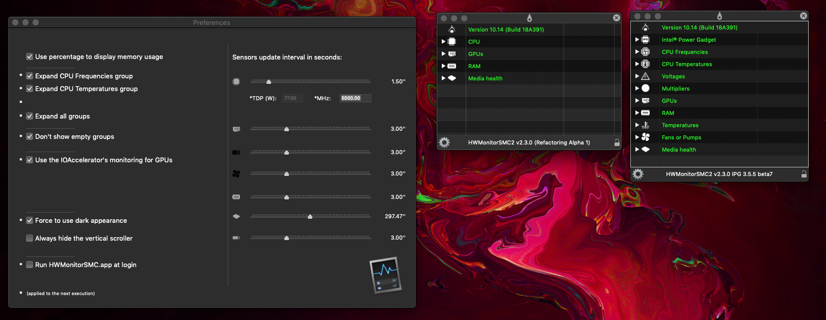

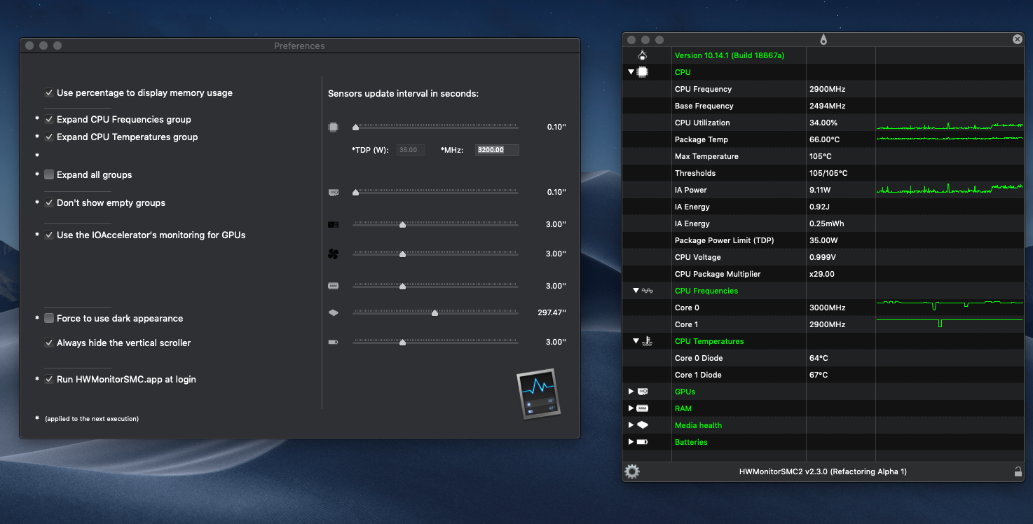

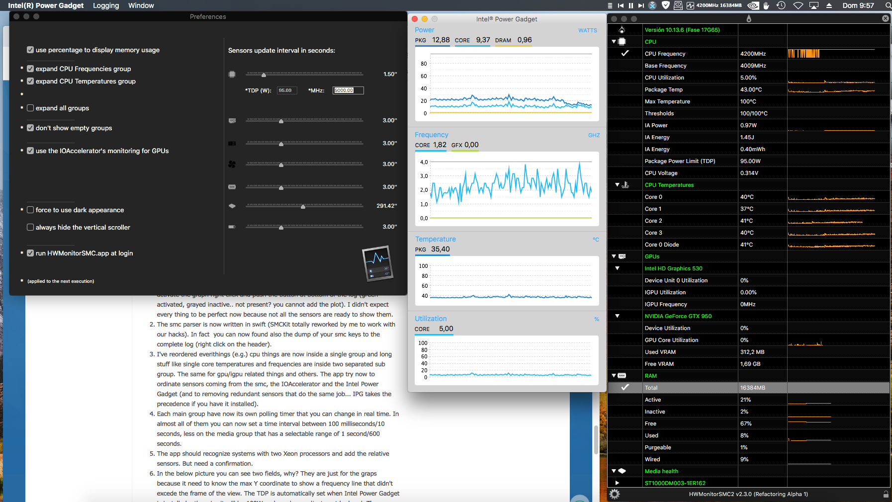

vector sigma Posted October 28, 2018 Share Posted October 28, 2018 (edited) This time was a lot of work, and I almost rewrite it. Implemented graphs using a modified version by me of CorePlot.framenwork. To activate the graph right click and push the button at bottom of the log (green activated, grayed inactive.. not present? you cannot add the plot). I didn't expect every thing to be perfect now because not all the sensors are ready to show them. The smc parser is now written in swift (SMCKit totally reworked by me to work with our hacks). In fact you can now found also the dump of your smc keys to the complete log (right click on the header). I've reordered everithings (e.g.) cpu things are now inside a single group and long stuff like single core temperatures and frequencies are inside two separated sub group. The same for gpu/igpu related things and others. The app try now to ordinate sensors coming from the smc, the IOAccelerator and the Intel Power Gadget (and to removing redundant sensors that do the same job... IPG takes the precedence if you have it installed). Each main group have now its own polling timer that you can change in real time. In almost all of them you can now set a time interval between 100 milliseconds/10 seconds, less on the media group that has a selectable range of 1 second/600 seconds. The app should recognize systems with two Xeon processors and add the relative sensors. But need a confirmation. In the below picture you can see two fields, why? They are just for the graphs because it need to know the max Y coordinate to show a frequency line that didn't excede the frame of the view. The TDP is automatically set when Intel Power Gadget is installed, otherwise it will be 100W and needs an udjustment by hand. The frequency in MHz is the max frequency of the CPU in turbo boost... that I cannot calculate so the default value is your CPU base frequency. As for the TDP's field the purpose is to have a good graph. See below: Thanks to @iParzival for the new icon set. Should be nice if you show me pictures of the new "Motherboard"/"Fans" groups from both hack and real Macs. The parser is new and should be able to show you some voltages. About Fans, should show you the fan name (as before), the current speed but also the min and the max speed. We are talking about motherboard Fans. GPUs fans are only displayed in the "GPUs" group but only when available and published by the driver.... unless you where adding them using the acpi methods. Let me know, just hope not to much crashes to fix. P.S. New translations will be needed, but that is actually secondary. Due to a bug you may need this version of IntelCPUMonitor.kext (if you will) that for +15-core-CPUs is able to produce the exceded good single core frequencies keys. Will not work (entirely) with the sf one... until I'll made a commit that require me to finish this new app to be able to read these keys (otherwise the stable one can't). P.S 2. Adding a graph for each sensor is anyway not efficent, in fact on a mobile laptop you will see cpu utilization increasing (3/4 %) due to the greater resources of the system to run all animations. This increase again too much if the time interval is in milliseconds instead of seconds. HWMonitorSMC2.app_v2.3.0_refactoring_alpha1.zip Edited October 29, 2018 by vector sigma 2 3 Link to comment Share on other sites More sharing options...

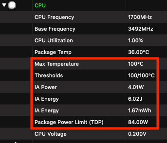

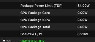

Andrey1970 Posted October 28, 2018 Share Posted October 28, 2018 @vector sigma Indications CPU Voltage are not correct, they are underestimated approximately by 4 times, on prior version it was correct. Back please "CPU Power" group from smc keys! Here reference constants CPU and "weather on Mars". It is not necessary. Link to comment Share on other sites More sharing options...
Andrey1970 Posted October 28, 2018 Share Posted October 28, 2018 And the new version does not show fans, in the previous showed. Link to comment Share on other sites More sharing options...
vector sigma Posted October 28, 2018 Share Posted October 28, 2018 8 hours ago, pico joe said: with new ICPM.kext +HWMSMC2v2.3.0 .. Voltages of the CPU are now inside "CPU". As well for "CPU Frequencies" and "CPU Temperatures" and "Intel Power Gadget" stuff. From waht I can see only "Fans or Pumps" didn't show up. Please show me a System log by right click on the first row of the new app (i.e. right click on "Version 10.14 (Build 18A391)" and then copy to psteboard and paste here). 2 hours ago, camillionario said: With ICPUM.kex. Because the graphics are orange, and you are green ?. Orange is the default color for Old OSes that is not able to change the appearance. I guess it is different in mojave. Chosen that because is visible even on a light appearance if the OS is not able to change him. 1 Link to comment Share on other sites More sharing options...
vector sigma Posted October 28, 2018 Share Posted October 28, 2018 (edited) 2 hours ago, Andrey1970 said: Back please "CPU Power" group from smc keys! Help me by showing me the SMC dump from the app itself (right click on the first row ->copy to paste board -> paste here). "CPU Power" stuff is redundant, but i'll make a new test version with that always enabled. 2 hours ago, Andrey1970 said: Here reference constants CPU and "weather on Mars". It is not necessary. Sorry but I want to see that stuff. Edited October 28, 2018 by vector sigma Link to comment Share on other sites More sharing options...

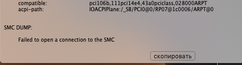

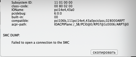

Andrey1970 Posted October 28, 2018 Share Posted October 28, 2018 25 minutes ago, vector sigma said: HWMonitorSMC2.app_Refactoring_Alpha2.zip CPU Power keys from. VirtualSMC should be displayed among IGP as well. Fun number is hard coded and not taken from FNum... to see if that is the problem. Let me know CPUPower there were in this version, but indications 0. Why I want to have CPU Power from smc keys? Because for example it is not possible to receive CPU Packege IGPU from IPG. Also there are no fans. SMC dump not work. I will remind, I use VirtualSMC. I loaded smc dump with by means of smcread tool. smc_dump.zip 5 minutes ago, vector sigma said: HWMonitorSMC2.app_Refactoring_Alpha3.zip Found the error for the Fans (bad sensor type). Too. Link to comment Share on other sites More sharing options...
vector sigma Posted October 28, 2018 Share Posted October 28, 2018 (edited) 24 minutes ago, Andrey1970 said: smc_dump.zip 24 minutes ago, Andrey1970 said: SMC dump not work. I will remind, I use VirtualSMC. I loaded smc dump with by means of smcread tool. smc_dump.zip Please retry with this: HWMonitorSMC2.app_Refactoring_Alpha4.zip. I think the problem is that tries to open the smc connection while is already opened. let me know. Edited October 28, 2018 by vector sigma internet connection problems Link to comment Share on other sites More sharing options...

vector sigma Posted October 28, 2018 Share Posted October 28, 2018 1 minute ago, Andrey1970 said: I rebooted and repeated. That did I receive a smc dump with the help smcread, to you does not suit? Try the aplha4, was not even uploaded due to my internet connection problems i have today so I uploaded it only now, see my previous post. smcread is good, but I made a new SMC parser in swift...and the app is using that. If there are little problems is understandable ... but is what the app is using. So until isn't 100% ok smcread is useless since is the one from the app that should be ok Link to comment Share on other sites More sharing options...
