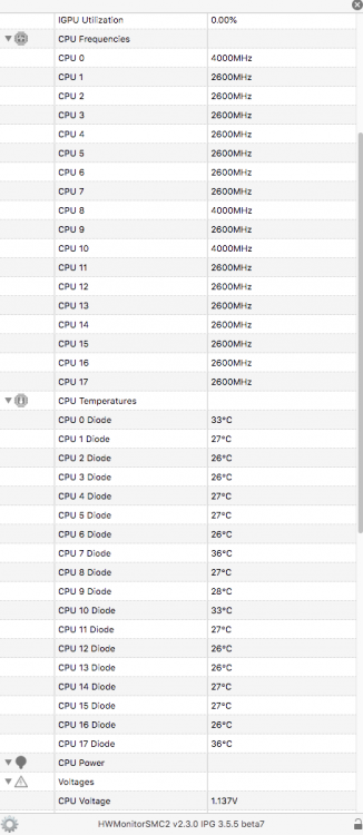

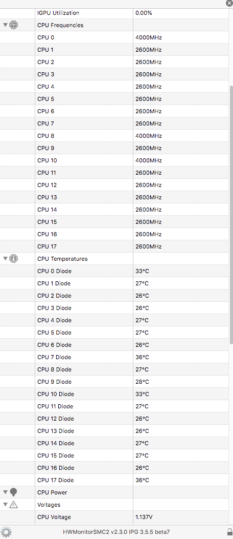

vector sigma Posted October 14, 2018 Share Posted October 14, 2018 The lenght was 5 instead of 4 for keys with values > 15 Link to comment Share on other sites More sharing options...
Guest Posted October 14, 2018 Share Posted October 14, 2018 new kext you gave cores are all named diode but are there : 6 minutes ago, vector sigma said: Found the problem: IntelCPUMonitor.kext_main2.zip Strange because he can't. Or bad keys anyway, not compatible with one produced by VirtualSMC I am using two different EFi one with virtualsmc stuff others with fakesmc stuff Link to comment Share on other sites More sharing options...
vector sigma Posted October 14, 2018 Share Posted October 14, 2018 and for that one app read them and another can't Link to comment Share on other sites More sharing options...
Guest Posted October 14, 2018 Share Posted October 14, 2018 if it possible may I ask to call core instead cpu on app? I think is more correct also with people with a a dual CPU system Thank you Link to comment Share on other sites More sharing options...
vector sigma Posted October 14, 2018 Share Posted October 14, 2018 2 minutes ago, fabiosun said: new kext you gave cores are all named diode What's the difference with before? diode is correct as diodes are physically welded on your processor. 1 minute ago, fabiosun said: if it possible may I ask to call core instead cpu on app? I think is more correct also with people with a a dual CPU system Thank you Already answered. Link to comment Share on other sites More sharing options...
Guest Posted October 14, 2018 Share Posted October 14, 2018 2 minutes ago, vector sigma said: and for that one app read them and another can't you have to code different app to see all cores with different kext combination? because in these our tests we can see them with both of combination.. Link to comment Share on other sites More sharing options...
vector sigma Posted October 14, 2018 Share Posted October 14, 2018 Not a problem, but that naming is correct. Sure you want that after knowing why? 1 minute ago, fabiosun said: you have to code different app to see all cores with different kext combination? because in these our tests we can see them with both of combination.. From now on will be the same with all kexts you use. Just wait me to publish the new app and the new kext. Link to comment Share on other sites More sharing options...
Guest Posted October 14, 2018 Share Posted October 14, 2018 2 minutes ago, vector sigma said: What's the difference with before? diode is correct as diodes are physically welded on your processor. Already answered. diode is ok cpu no I think (cpu is one , cores are how you have inside your cpu) but not important Link to comment Share on other sites More sharing options...
vector sigma Posted October 14, 2018 Share Posted October 14, 2018 4 minutes ago, fabiosun said: cores are how you have inside your cpu "Diode Core x"? This should be a refinement: IntelCPUMonitor.kext_main3.zip, let me know Link to comment Share on other sites More sharing options...

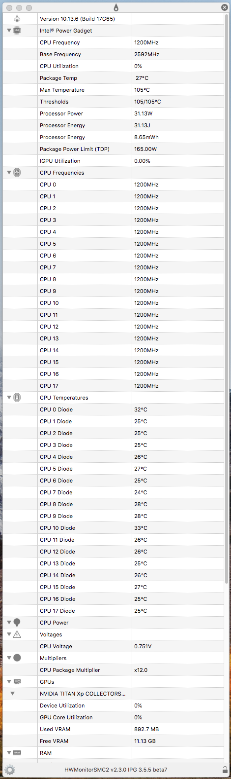

Guest Posted October 14, 2018 Share Posted October 14, 2018 no I said before in this thread your reading of 165 W is fine but when you stress it reaches in IPG 280 or more it depends from many factor and this value is not exposed well in IPG tab or in other system boots fine with latest kext see here Link to comment Share on other sites More sharing options...

vector sigma Posted October 14, 2018 Share Posted October 14, 2018 17 minutes ago, fabiosun said: but when you stress it reaches in IPG 280 or more it depends from many factor That isn't anywhere in their framework (or public), but you can see Andrey1970 has it with VirtualSMC while in your smc dump keys aren't present (not with FakeSMC, nor with VirtualSMC). The IGP tells me about "MSR_FUNC_POWER", I've allocated an array with len 3 as per documentation: Quote 1 int GetPowerData(int iNode, int iMSR, double *pResult, int *nResult); Returns the data collected by the most recent call to ReadSample. The returned data is for the data on the package specified by iNode, from the MSR specified by iMSR. The data is returned in pResult, and the number of double results returned in pResult is returned in nResult. Frequency MSRs (function 0) return 1 result, which represents the frequency in megahertz. Power MSRs (function 1) return 3 results, which represent the average power in watts, cumulative energy in Joules, and cumulative energy in milliwatt-hours. Temperature MSRs (function 2) return 1 result, which represents the temperature in degrees Celsius. and maybe is short and could be greater? Who knows, anyway for me didn't show more things. Link to comment Share on other sites More sharing options...

Guest Posted October 14, 2018 Share Posted October 14, 2018 (edited) 12 minutes ago, vector sigma said: That isn't anywhere in their framework (or public), but you can see Andrey1970 has it with VirtualSMC while in your smc dump keys aren't present (not with FakeSMC, nor with VirtualSMC). The IGP tells me about "MSR_FUNC_POWER", I've allocated an array with len 3 as per documentation: and maybe is short and could be greater? Who knows, anyway for me didn't show more things. in graphic IPG interface I mean this value 12 minutes ago, Pavo said: Yeah that's what I figured the issue was, thanks for all you have been doing, at least now I can monitor my GPU without the need of RadeonMonitor.kext could you post this terminal output smcread -s maybe from there it is possible to see your core if SMCProcessor works also in real Mac (dual cpu systems are also there ) Edited October 14, 2018 by Guest Link to comment Share on other sites More sharing options...
vector sigma Posted October 14, 2018 Share Posted October 14, 2018 1 minute ago, fabiosun said: in graphic IPG interface I mean this value Sure but they also have: bool ReservedFunc0(void *a, void *b, void *c); which I'm sure they know how to use while the rest of the world can't. Link to comment Share on other sites More sharing options...
