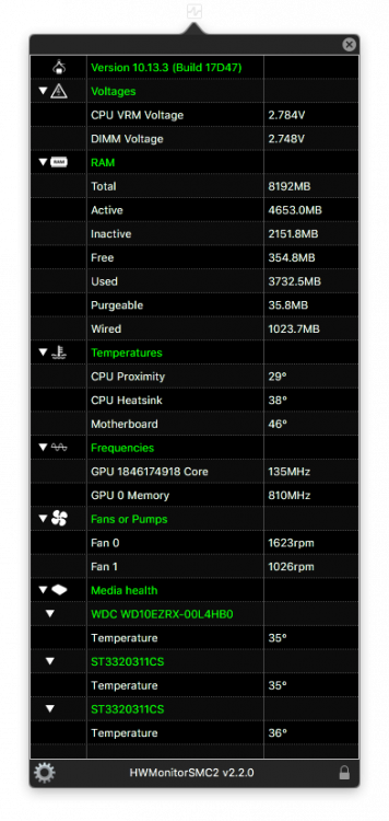

XLNC Posted September 4, 2018 Share Posted September 4, 2018 5 hours ago, Slice said: Take the updated version. ITEIT87x.kext.zip thanks ! i tried it and it still doesnt shows other readings . here it is a pic :CPU is Ryzen 1700 kexts that i am using are : any fix for this issue ? btw these kexts worked perfectly on my other system i.e AMD FX 8320 CPU . Link to comment Share on other sites More sharing options...
Slice Posted September 4, 2018 Author Share Posted September 4, 2018 Show, please, kernel-log. There must be messages from these kexts. Link to comment Share on other sites More sharing options...

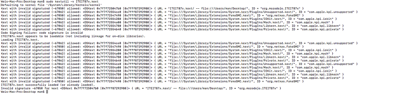

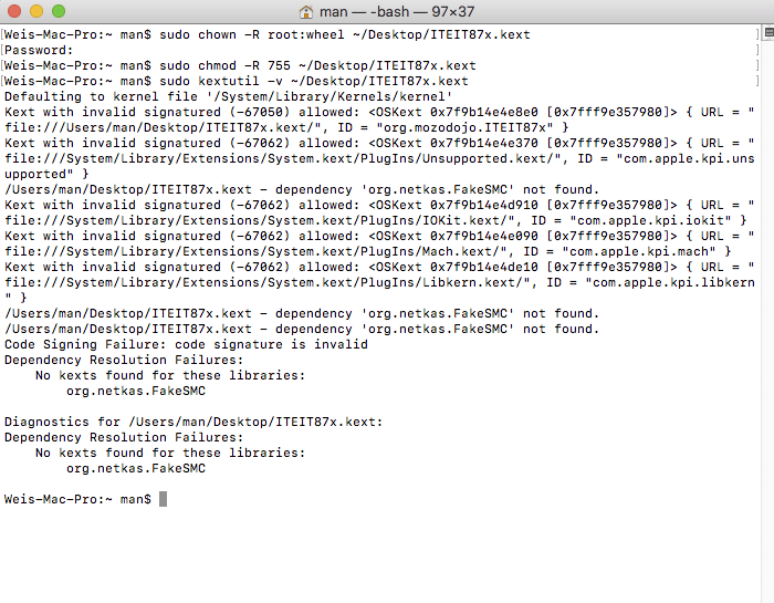

Slice Posted September 7, 2018 Author Share Posted September 7, 2018 23 hours ago, XLNC said: DarwinDumper_3.0.4_06.09_18.03.29_MacPro51_AMI_X64_4318_High_Sierra_17D102_man.zip It is good. I see FakeSMC is loaded FakeSMC: plugins & plugins support modifications by mozodojo, usr-sse2, slice (C) 2010 but then I see no plugin loaded don't know why. Try to do the follow: exclude ITEIT87x.kext from /Other folder, place it on the desktop. Enter terminal $ sudo chown -R root:wheel ~/Desktop/ITEIT87x.kext $ sudo chmod -R 755 ~/Desktop/ITEIT87x.kext $ sudo kextutil -v ~/Desktop/ITEIT87x.kext and show me the output. Link to comment Share on other sites More sharing options...
XLNC Posted September 7, 2018 Share Posted September 7, 2018 12 hours ago, Slice said: It is good. I see FakeSMC is loaded FakeSMC: plugins & plugins support modifications by mozodojo, usr-sse2, slice (C) 2010 but then I see no plugin loaded don't know why. Try to do the follow: exclude ITEIT87x.kext from /Other folder, place it on the desktop. Enter terminal $ sudo chown -R root:wheel ~/Desktop/ITEIT87x.kext $ sudo chmod -R 755 ~/Desktop/ITEIT87x.kext $ sudo kextutil -v ~/Desktop/ITEIT87x.kext and show me the output. Link to comment Share on other sites More sharing options...
Slice Posted September 8, 2018 Author Share Posted September 8, 2018 Did you see FakeSMC not found? It means you are using bad version. Link to comment Share on other sites More sharing options...
XLNC Posted September 8, 2018 Share Posted September 8, 2018 6 hours ago, Slice said: Did you see FakeSMC not found? It means you are using bad version. hi ! i installed fakesmc in S/L/E and ran the commands again but still no temps in SMC monitor app ( even restarted the app) Link to comment Share on other sites More sharing options...
