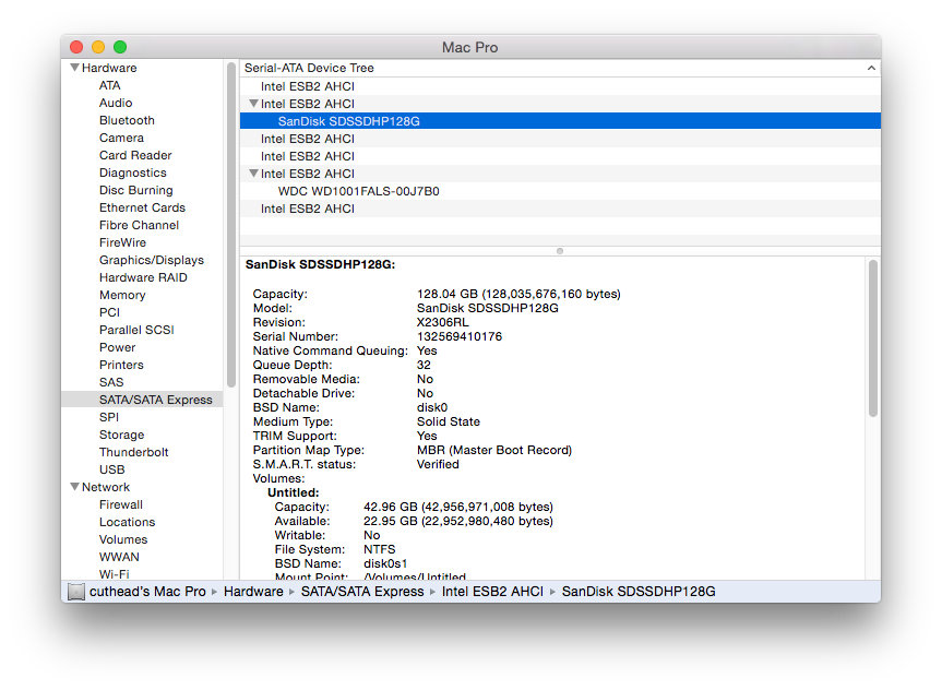

flkflorin Posted October 31, 2014 Share Posted October 31, 2014 cuthead good job , its work !!!! This is what i do to work , i used method 2 : sudo cp /System/Library/Extensions/IOAHCIFamily.kext/Contents/PlugIns/IOAHCIBlockStorage.kext/Contents/MacOS/IOAHCIBlockStorage /System/Library/Extensions/IOAHCIFamily.kext/Contents/PlugIns/IOAHCIBlockStorage.kext/Contents/MacOS/IOAHCIBlockStorage.bak sudo perl -pi -e 's|\x00\x41\x50\x50\x4c\x45\x20\x53\x53\x44\x00|\x00\x00\x00\x00\x00\x00\x00\x00\x00\x00\x00|' /System/Library/Extensions/IOAHCIFamily.kext/Contents/PlugIns/IOAHCIBlockStorage.kext/Contents/MacOS/IOAHCIBlockStorage sudo touch /System/Library/Extensions touch /System/Library/Extensionskextcache -prelinked-kernel /System/Library/Caches/com.apple.kext.caches/Startup/kernelcache -K /System/Library/Kernels/kernel /System/Library/Extensions Thanks !!! 2 Link to comment https://www.insanelymac.com/forum/topic/298507-enable-trim-on-non-apple-ssd/page/3/#findComment-2079126 Share on other sites More sharing options...

liujianwei Posted November 1, 2014 Share Posted November 1, 2014 I used 3rd method from 1st page of this topic. I have Dell Latitude e6500 with Yosemite 10.10 Final, SSD 128GB Samsung, bootloader Clover. TRIM seems to be ENABLED, but is it really TRUE? I think, it is cosmetic correction. If I run newest TRIM Enabler.app (version 3.3), I got message: "The patch is not active, but Trim is working. You probably have an Apple SSD, which supports Trim by default." But I and everyone knows, that in Hackintosh are 3rd Party SSD used, not from Apple SSD. Does everyone know, how to determine if TRIM really works? I got the same message from TRIM Enabler,I think it works. cuthead good job , its work !!!! This is what i do to work , i used method 2 : sudo cp /System/Library/Extensions/IOAHCIFamily.kext/Contents/PlugIns/IOAHCIBlockStorage.kext/Contents/MacOS/IOAHCIBlockStorage /System/Library/Extensions/IOAHCIFamily.kext/Contents/PlugIns/IOAHCIBlockStorage.kext/Contents/MacOS/IOAHCIBlockStorage.bak sudo perl -pi -e 's|\x00\x41\x50\x50\x4c\x45\x20\x53\x53\x44\x00|\x00\x00\x00\x00\x00\x00\x00\x00\x00\x00\x00|' /System/Library/Extensions/IOAHCIFamily.kext/Contents/PlugIns/IOAHCIBlockStorage.kext/Contents/MacOS/IOAHCIBlockStorage sudo touch /System/Library/Extensions touch /System/Library/Extensionskextcache -prelinked-kernel /System/Library/Caches/com.apple.kext.caches/Startup/kernelcache -K /System/Library/Kernels/kernel /System/Library/Extensions Thanks !!! You are welcome OPS! Sorry! Thanks, first post corrected! Thanks for your good job. 2 Link to comment https://www.insanelymac.com/forum/topic/298507-enable-trim-on-non-apple-ssd/page/3/#findComment-2079390 Share on other sites More sharing options...
