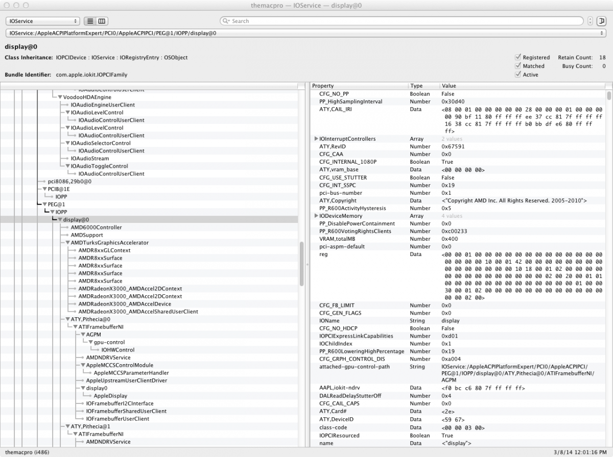

RobertX Posted March 8, 2014 Share Posted March 8, 2014 ...hmmm, got this card on the cheap...installed and running with default framebuffer for now....I'll have to get the ports and personality figured out...but all looks like a go... (GraphicsEnabler=No for now) ...edit: seems to work with pithecia take peek... ...still testing AMD Radeon HD 6570/7570 Series Chipset Model: AMD Radeon HD 6570/7570 Series Type: GPU Bus: PCIe PCIe Lane Width: x16 VRAM (Total): 1024 MB Vendor: ATI (0x1002) Device ID: 0x6759 Revision ID: 0x0000 Displays:BenQ GW2250: Resolution: 1920 x 1080 @ 60 Hz Pixel Depth: 32-Bit Color (ARGB8888) Display Serial Number: 5BC07263SL0 Main Display: Yes Mirror: Off Online: Yes Rotation: Supported edit: seems only working port is hdmi(using DVI/HDMI adapter) i'll look into personality mods next Link to comment Share on other sites More sharing options...

RobertX Posted March 13, 2014 Author Share Posted March 13, 2014 ...was playing around with RBE(RadeonBiosEditor) in Win8.1 and did a bit of overclocking...and instead of flashing the card , i just saved the rom...restarted os x, retrieved the rom from windows and renamed it 1002_6759_04031043.rom ...moved the file into /Extra...then adjusted org.chameleon.boot.plist to include UseAtiROM=Yes...voila'! ...increased core from 650 to 800MHz and memory from 900 to 1000...increased fan duty cycle from 15 to 26% @46 degrees C, ramping up from there...below is from OpenCL_OceanWave...it shows the increase...runs smooth...idles @44-48 degrees C ...no voltage mods...stock cooler/w fan...i left the first 2 power settings in rom alone ... so AGPM still lets the card idle down... NITIALISING: 1 OpenCL platform found![Platform 0]Name: AppleVendor: AppleVersion: OpenCL 1.2 (Dec 8 2013 21:07:05)Profile: FULL_PROFILEExtensions: cl_APPLE_SetMemObjectDestructor cl_APPLE_ContextLoggingFunctions cl_APPLE_clut cl_APPLE_query_kernel_names cl_APPLE_gl_sharing cl_khr_gl_event[OpenCL-only Context]2 OpenCL devices found![Device 0]Name: Intel® Core2 Duo CPU E6850 @ 3.00GHzVendor: IntelType: CPUDevice Version: OpenCL 1.2Driver Version: 1.1Compute Units: 2Work Group Size: 1024Clock: 2992 MHzGlobal Memory (Total): 8192 MBGlobal Memory (Host): 8192 MBGlobal Memory (PCIe): 0 MBLocal Memory: 32 KBCache Size: 0.0625 KBCache Line Size: 4194304 BytesAvailable: YesDouble-Precision: YesExtensions:cl_APPLE_SetMemObjectDestructorcl_APPLE_ContextLoggingFunctionscl_APPLE_clutcl_APPLE_query_kernel_namescl_APPLE_gl_sharingcl_khr_gl_eventcl_khr_fp64cl_khr_global_int32_base_atomicscl_khr_global_int32_extended_atomicscl_khr_local_int32_base_atomicscl_khr_local_int32_extended_atomicscl_khr_byte_addressable_storecl_khr_int64_base_atomicscl_khr_int64_extended_atomicscl_khr_3d_image_writescl_khr_image2d_from_buffercl_APPLE_fp64_basic_opscl_APPLE_fixed_alpha_channel_orderscl_APPLE_biased_fixed_point_image_formatscl_APPLE_command_queue_priority[Device 1]Name: ATI Radeon Turks PRO PrototypeVendor: AMDType: GPUDevice Version: OpenCL 1.2Driver Version: 1.2 (Jan 28 2014 20:11:46)Compute Units: 6Work Group Size: 256Clock: 800 MHzGlobal Memory: 1024 MBLocal Memory: 32 KBCache Size: 0 KBCache Line Size: 0 BytesAvailable: YesDouble-Precision: NoExtensions:cl_APPLE_SetMemObjectDestructorcl_APPLE_ContextLoggingFunctionscl_APPLE_clutcl_APPLE_query_kernel_namescl_APPLE_gl_sharingcl_khr_gl_eventcl_khr_global_int32_base_atomicscl_khr_global_int32_extended_atomicscl_khr_local_int32_base_atomicscl_khr_local_int32_extended_atomicscl_khr_byte_addressable_storecl_khr_image2d_from_buffercl_khr_depth_images[shared OpenCL+OpenGL Context]2 OpenCL devices found![Device 0]Name: ATI Radeon Turks PRO PrototypeVendor: AMDType: GPUDevice Version: OpenCL 1.2Driver Version: 1.2 (Jan 28 2014 20:11:46)Compute Units: 6Work Group Size: 256Clock: 800 MHzGlobal Memory: 1024 MBLocal Memory: 32 KBCache Size: 0 KBCache Line Size: 0 BytesAvailable: YesDouble-Precision: NoExtensions:cl_APPLE_SetMemObjectDestructorcl_APPLE_ContextLoggingFunctionscl_APPLE_clutcl_APPLE_query_kernel_namescl_APPLE_gl_sharingcl_khr_gl_eventcl_khr_global_int32_base_atomicscl_khr_global_int32_extended_atomicscl_khr_local_int32_base_atomicscl_khr_local_int32_extended_atomicscl_khr_byte_addressable_storecl_khr_image2d_from_buffercl_khr_depth_images[Device 1]Name: Intel® Core2 Duo CPU E6850 @ 3.00GHzVendor: IntelType: CPUDevice Version: OpenCL 1.2Driver Version: 1.1Compute Units: 2Work Group Size: 1024Clock: 2992 MHzGlobal Memory (Total): 8192 MBGlobal Memory (Host): 8192 MBGlobal Memory (PCIe): 0 MBLocal Memory: 32 KBCache Size: 0.0625 KBCache Line Size: 4194304 BytesAvailable: YesDouble-Precision: YesExtensions:cl_APPLE_SetMemObjectDestructorcl_APPLE_ContextLoggingFunctionscl_APPLE_clutcl_APPLE_query_kernel_namescl_APPLE_gl_sharingcl_khr_gl_eventcl_khr_fp64cl_khr_global_int32_base_atomicscl_khr_global_int32_extended_atomicscl_khr_local_int32_base_atomicscl_khr_local_int32_extended_atomicscl_khr_byte_addressable_storecl_khr_int64_base_atomicscl_khr_int64_extended_atomicscl_khr_3d_image_writescl_khr_image2d_from_buffercl_APPLE_fp64_basic_opscl_APPLE_fixed_alpha_channel_orderscl_APPLE_biased_fixed_point_image_formatscl_APPLE_command_queue_priority Link to comment Share on other sites More sharing options...
RobertX Posted March 17, 2014 Author Share Posted March 17, 2014 ...and we are a go!....with assistance from Slice... AMD Radeon HD 6570/7570 Series: Chipset Model: AMD Radeon HD 6570/7570 Series Type: GPU Bus: PCIe PCIe Lane Width: x16 VRAM (Total): 1024 MB Vendor: ATI (0x1002) Device ID: 0x6759 Revision ID: 0x0000 Displays:Apple Studio Display: Display Type: LCD Resolution: 1280 x 1024 Pixel Depth: 32-Bit Color (ARGB8888) Main Display: Yes Mirror: Off Online: Yes Rotation: SupportedL05HD: Resolution: 1280 x 720 @ 60Hz (720p) Pixel Depth: 32-Bit Color (ARGB8888) Mirror: Off Online: Yes Rotation: Supported Television: Yes ...using modified Ipomoea personality(suggested by Slice) DVI/HDMI ...VGA not tested...using Chameleon 2377 GraphicsEnabler=Yes Ati_Config=Ipomoea ...the modified personality is here: http://www.insanelymac.com/forum/topic/288601-patched-framebuffer-repository/?do=findComment&comment=2004926 Link to comment Share on other sites More sharing options...
