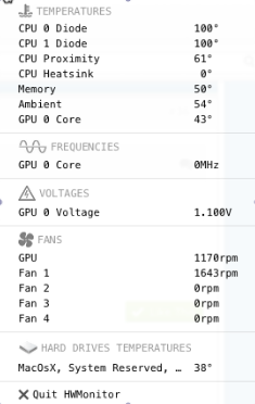

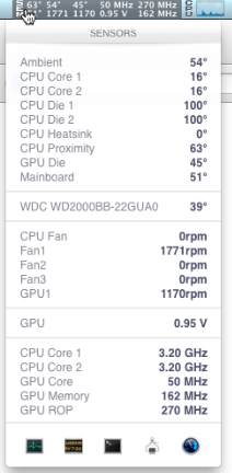

RobertX Posted March 19, 2014 Share Posted March 19, 2014 ... hi Slice, from console: 2014-03-19 11:15:32.000 AM kernel[0]: [Andigilog] aSC PID=0x68 attached at 0x2e. ...now we are getting somewhere...a look at HWMonitor with kext loaded: ...this is with kext loaded manually after boot....i'll do a restart now and see how it goes... edit: 2014-03-19 12:32:01.000 PM kernel[0]: [Andigilog] aSC PID=0x68 attached at 0x2e. ICHSMBus: Version: 1.1 Last Modified: 2014-03-12 8:53 AM Kind: Intel Architectures: i386, x86_64 64-Bit (Intel): Yes Location: /System/Library/Extensions/ICHSMBus.kext Kext Version: 1.1 Load Address: 0xffffff7f818a1000 Valid: Yes Authentic: Yes Dependencies: Satisfied Andigilog: Version: 1.0 Last Modified: 2014-03-19 12:12 PM Kind: Intel Architectures: i386, x86_64 64-Bit (Intel): Yes Location: /System/Library/Extensions/Andigilog.kext Kext Version: 1 Load Address: 0xffffff7f821c1000 Valid: Yes Authentic: Yes Dependencies: Satisfied ...very good... ...Slice, 2 times you have helped me recently...I am humbled... Link to comment https://www.insanelymac.com/forum/topic/296460-amdcpumonitor-and-hwsensors-331/page/2/#findComment-2005670 Share on other sites More sharing options...

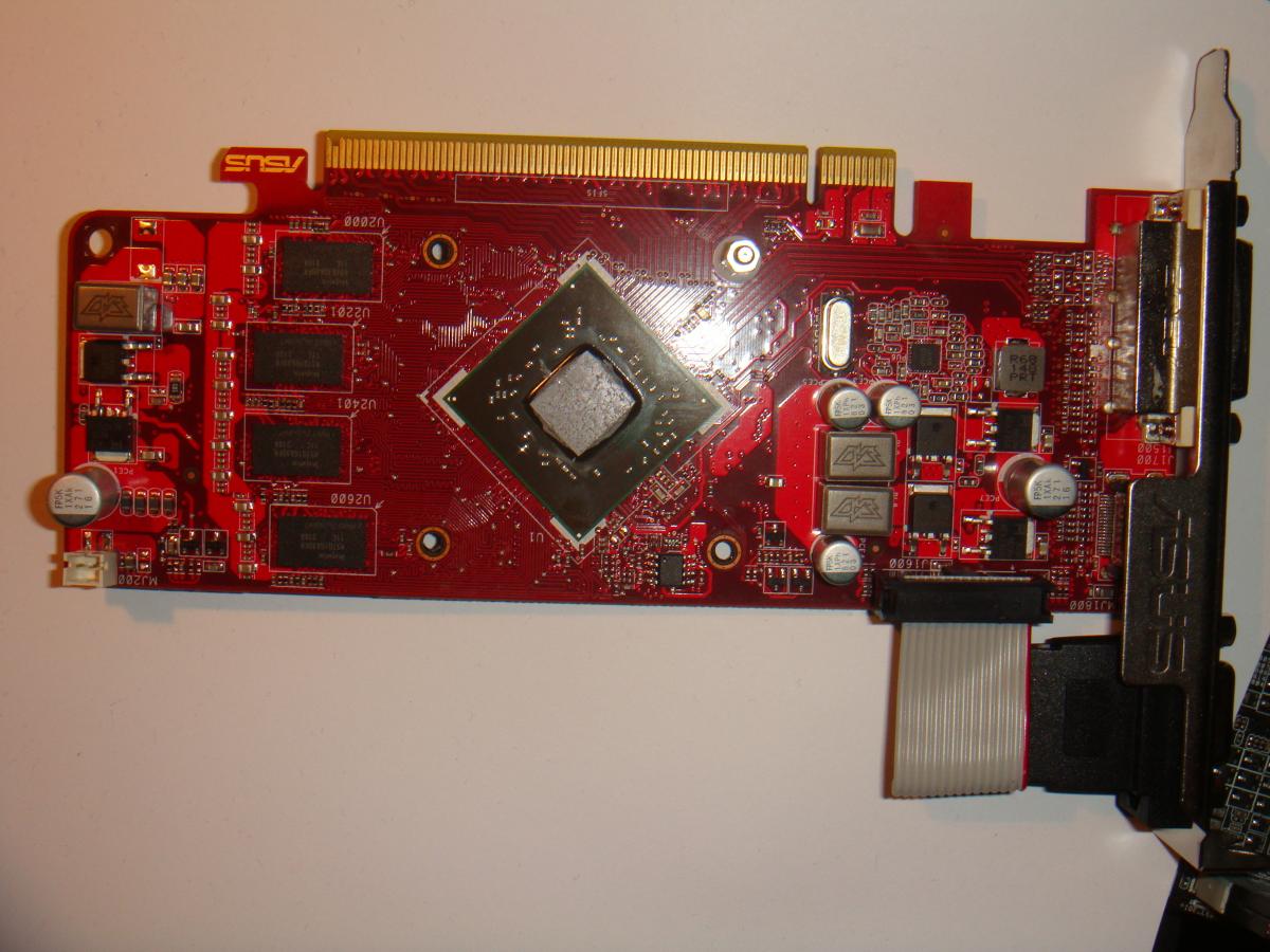

RobertX Posted March 22, 2014 Share Posted March 22, 2014 just to see... Asus Radeon HD 6570 Link to comment https://www.insanelymac.com/forum/topic/296460-amdcpumonitor-and-hwsensors-331/page/2/#findComment-2006596 Share on other sites More sharing options...

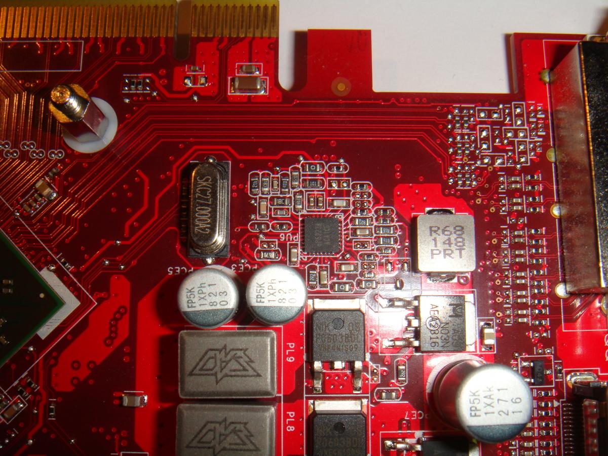

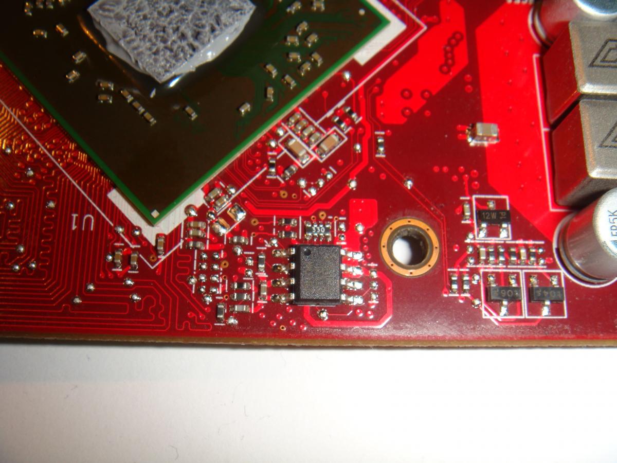

RobertX Posted March 26, 2014 Share Posted March 26, 2014 ...my bad...that is some kind of step down regulator...two on this card ...uP6223a, pwm controller chip...this is it...now for that datasheet ...emailed 2 suppliers...asking for datasheet... Link to comment https://www.insanelymac.com/forum/topic/296460-amdcpumonitor-and-hwsensors-331/page/2/#findComment-2007583 Share on other sites More sharing options...
Slice Posted March 26, 2014 Author Share Posted March 26, 2014 AFAIK some Radeon card have analog regulator for the fan. More temperature - more power to fan. And this have no digital control. It is cheep solution and works good enough. Other question about GPU frequency. It is written into VideoBios and we can read it. But there is a constant. I see no sense to show constants and I don't know if this is not a constant. Can Apple's drivers to change AMD GPU frequency? Link to comment https://www.insanelymac.com/forum/topic/296460-amdcpumonitor-and-hwsensors-331/page/2/#findComment-2007600 Share on other sites More sharing options...
