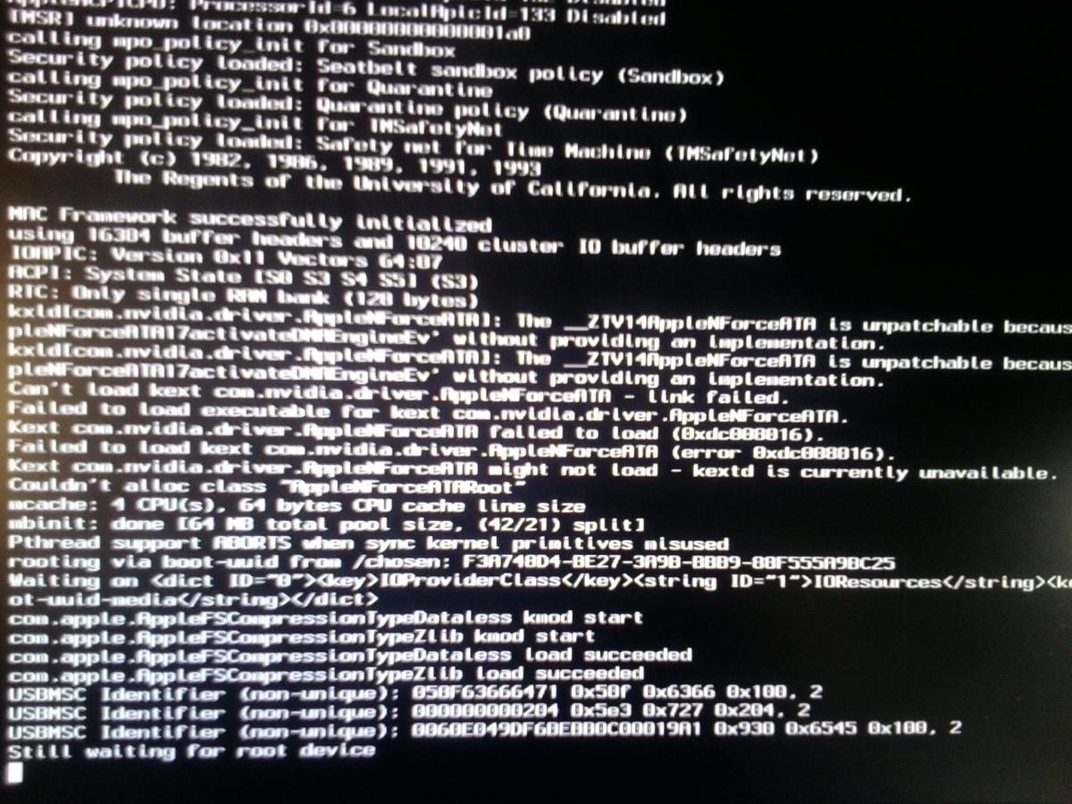

smx Posted February 12, 2014 Share Posted February 12, 2014 You need a 64bit kext: Try this, it's both 32 and 64 bit http://www.insanelymac.com/forum/topic/211866-applenforceata-104-optimized-for-sl-3264bit/ Link to comment Share on other sites More sharing options...
Eweie Posted February 12, 2014 Author Share Posted February 12, 2014 hi and thank you for the help! most links seem to be dead but i got it from this poster who attached one http://www.insanelymac.com/forum/topic/211866-applenforceata-104-optimized-for-sl-3264bit/?do=findComment&comment=1520885 i hope it's the correct one yes that got it past that stage and seems like all the other osx stuff starting loading but then it loaded the hard disk and some usb things i had attached and i thought it was stuck there but then minutes later i got a "resting OI catalog" and i think its stuck there. macintosh hd and macintosh hd 2 are other harddisk where i have SL and that narish mavericks it's just some usb stick which is unrelated to the instalation im trying to boot. Link to comment Share on other sites More sharing options...

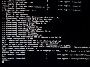

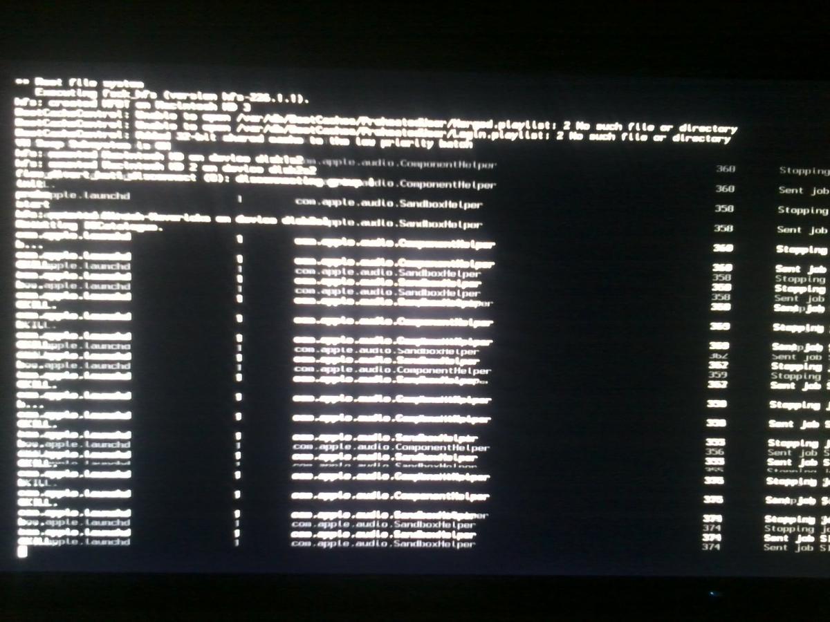

Eweie Posted February 12, 2014 Author Share Posted February 12, 2014 update: after being in that state for about 10 minutes or so now it began throwing this which i dont know what it means. does it mean something is failing or its successfully booting, i dont know. but i think more stuff like that just keeps popping up. That's graphics related, your GPU is not firing up.. but that kext works Try GraphicsEnabler=yes, try without verbose, try a patch: http://www.insanelymac.com/forum/files/file/146-qe-ci-exotic-patch/ Posted at the same time xD alright, thank you, I'll try it right now. it's still trowing me the messages about some sandbox thing i posted above, seems to be the same thing over and over. update: i installed those kexts and use GraphicsEnabler=yes and its just at the apple logo with the thing spinning, its been there for a while now. ok rebooted in verbose mode once again with graphics enabler to yes and it's been stuck on this for the past 10 minutes or so. by this i mean the latest attachment.. update: well i booted with -s and im in the system as root with text command only so i think it's definitely my graphics that isn't working right. yup it works, i can run basic unix commands like top and stuff like that so i think it's working fine just have to figure out the graphics... i have no clue where to start, should i try other kexts? or am i missing something. from what i remember i believe i had to install something called evoEnabler.kext on my snow leopard installation but i did that almost a year ago so i don't remember if it's a necessary... i remember before i installed any kext for my graphics it did boot into VESA mode so i dont know why isnt at least doing that now. maybe it was something the distro i used had. Link to comment Share on other sites More sharing options...
iFIRE Posted February 12, 2014 Share Posted February 12, 2014 well, this is your chipset Chipset - NVIDIA® GeForce 7025 / nForce 630a You need this kext AppleNForceATA.imk64bit.kex nForce OS X Mavericks (10.9) APP STORE DOWNLOAD INSTALL ... take a look in this guide, the user have same chipset nforce, download the kext in the guide and put in Extra/Extensions of your usbinstaller or S/L/E of your disk, then boot with -s and remove all graphics kexts with it fsck -fy mount -uw / mkdir /kext_backup cd /System/Library/Extensions mv AMDRadeon* ATI* GeForce* NVDA*/kext_backup rm ../Caches/com.apple.kext.caches/Startup/kernelcache reboot Link to comment Share on other sites More sharing options...

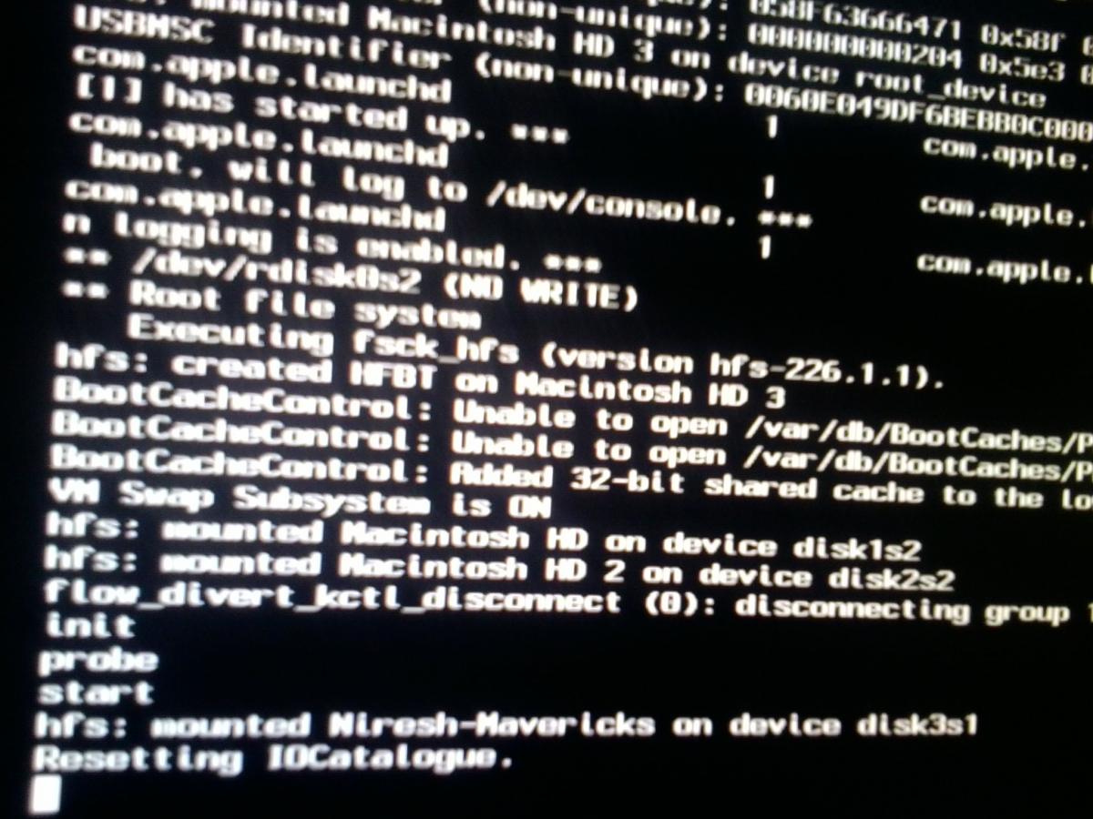

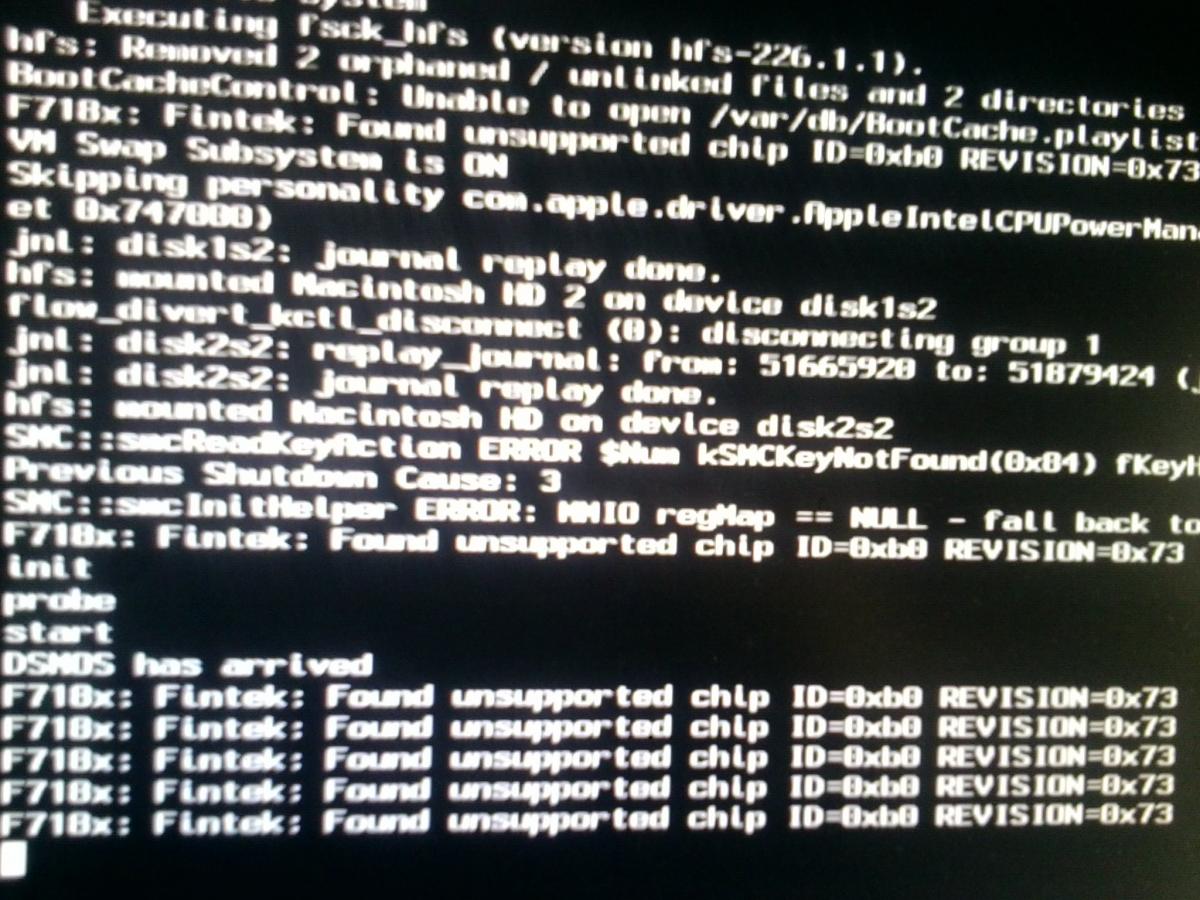

Eweie Posted February 12, 2014 Author Share Posted February 12, 2014 Hi iFIRE. I did what you told me but I get the same results. i also installed FakeSMC.kext AppleHDA.1062.kext EvOreboot.kext AppleRTC.Mavericks.Patched.kext SuperIOFamily.kext ACPIMonitor.kext nForceLAN.0.64.5.kext NullCPUPowerManagement.kext from that guide and i get DSMOS has arrived then F718x: Finteck: Found unsupported chip ID=0xb0 REVISION=0x73 then after a few minutes i get Resseting IOCatalogue. and stuck again. Link to comment Share on other sites More sharing options...

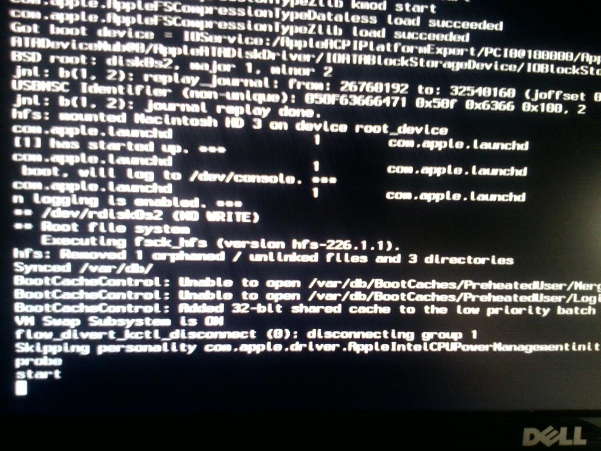

iFIRE Posted February 12, 2014 Share Posted February 12, 2014 sure that you have a folder Extra in the root of your disk, FakeSMC.kext installed in the disk? send me the Extra folder use this flag: -f -v -x GraphicsEnabler=No mach_kernel arch=x86_64 npci=0x2000 post photo were this stop Link to comment Share on other sites More sharing options...
Eweie Posted February 12, 2014 Author Share Posted February 12, 2014 I just tried it again with those exact bootflags even amd_kernel and still no luck. i hadn't tried the -x before. I have an extra folder on the root that i copied myself from my snow leopard instalation but i have no kexts in it. i modified both chameleon plist and sbios plist but they dont really have any special attributes. ill upload it so you can check it out. oh and yes i have FakeSMC.kext installed. ill double check. Extra.zip I checked, I do have FakeSMC ok I tried those boot flags and here is where it stops. Link to comment Share on other sites More sharing options...

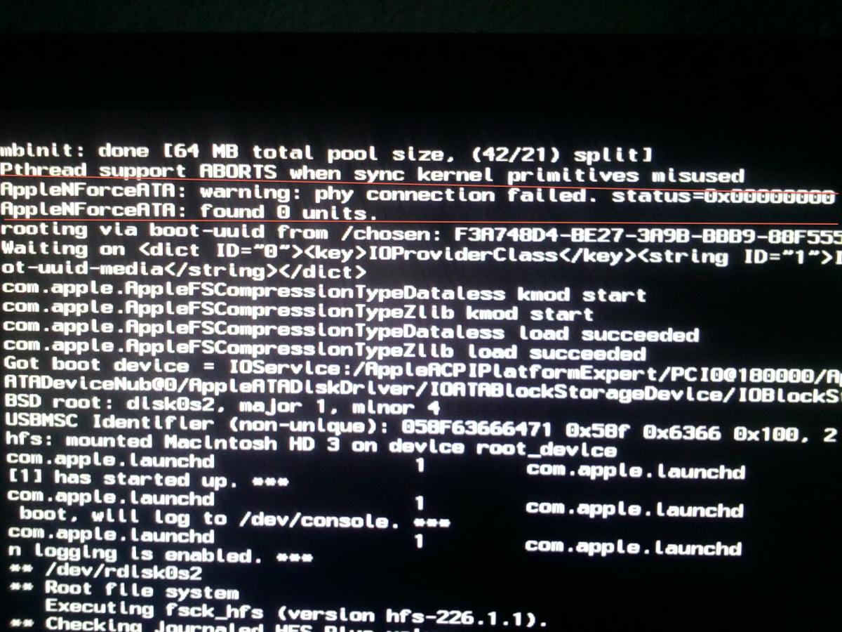

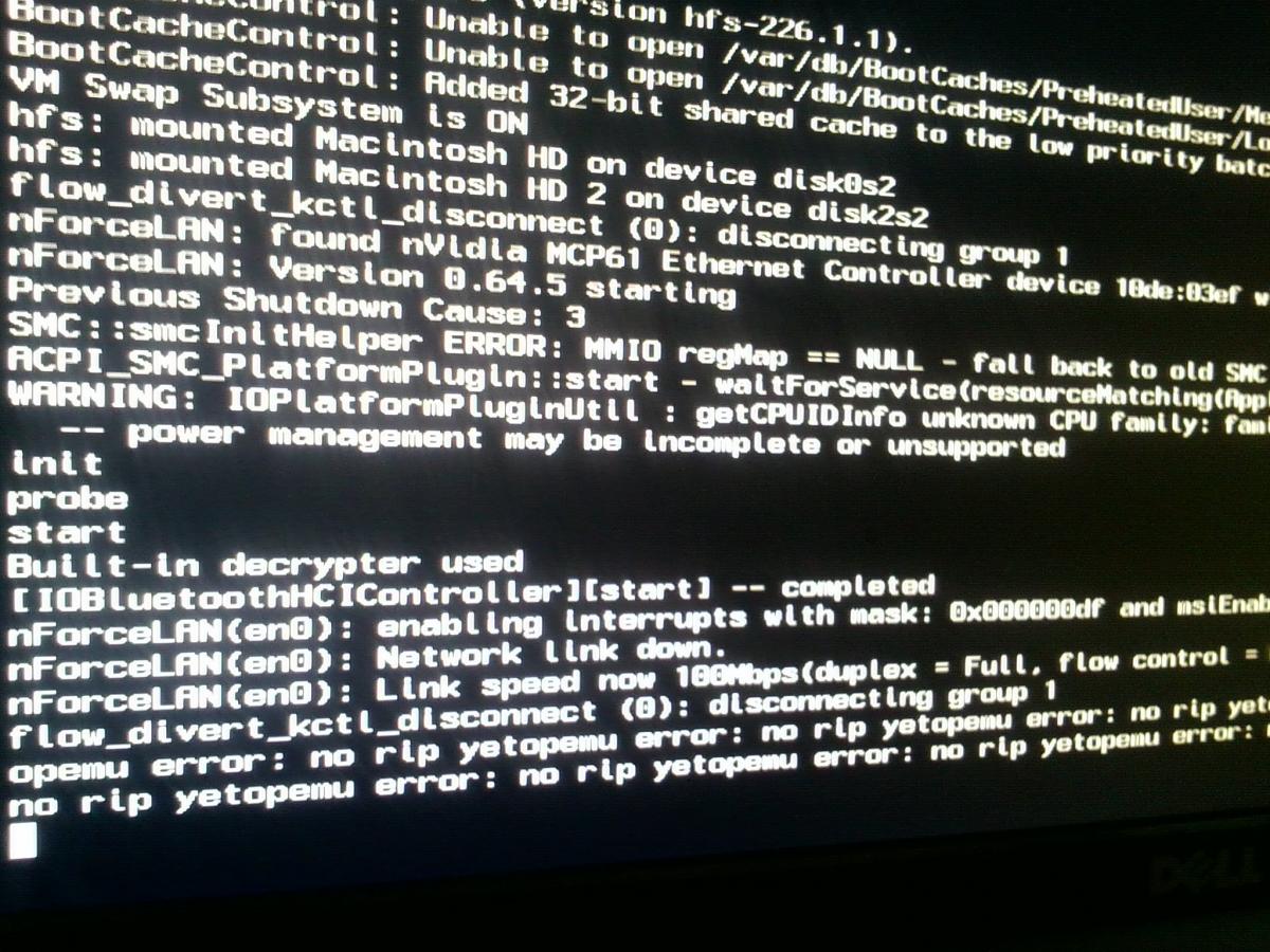

Eweie Posted February 12, 2014 Author Share Posted February 12, 2014 ok I tried that kernel and same result. used the same boot flags. also i noticed that i don't have any user on the users folder but Shared which doesn't have any files in. don't know if that would cause any issue. also, theres this, I dont know if it's a critical error or normal. Link to comment Share on other sites More sharing options...

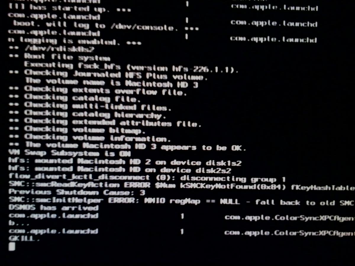

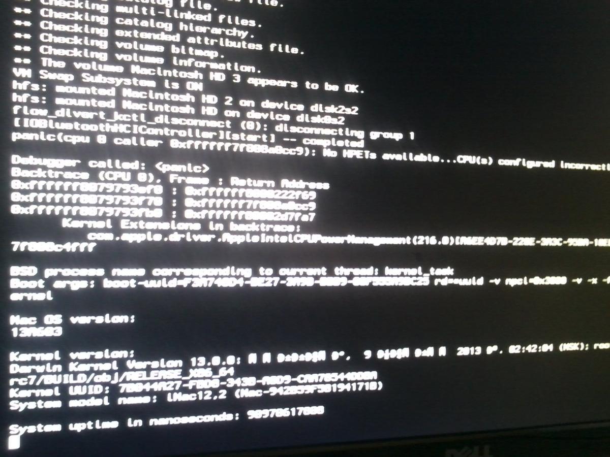

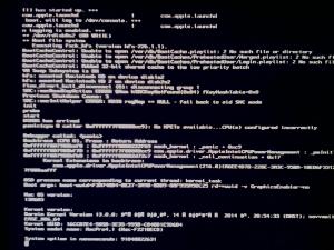

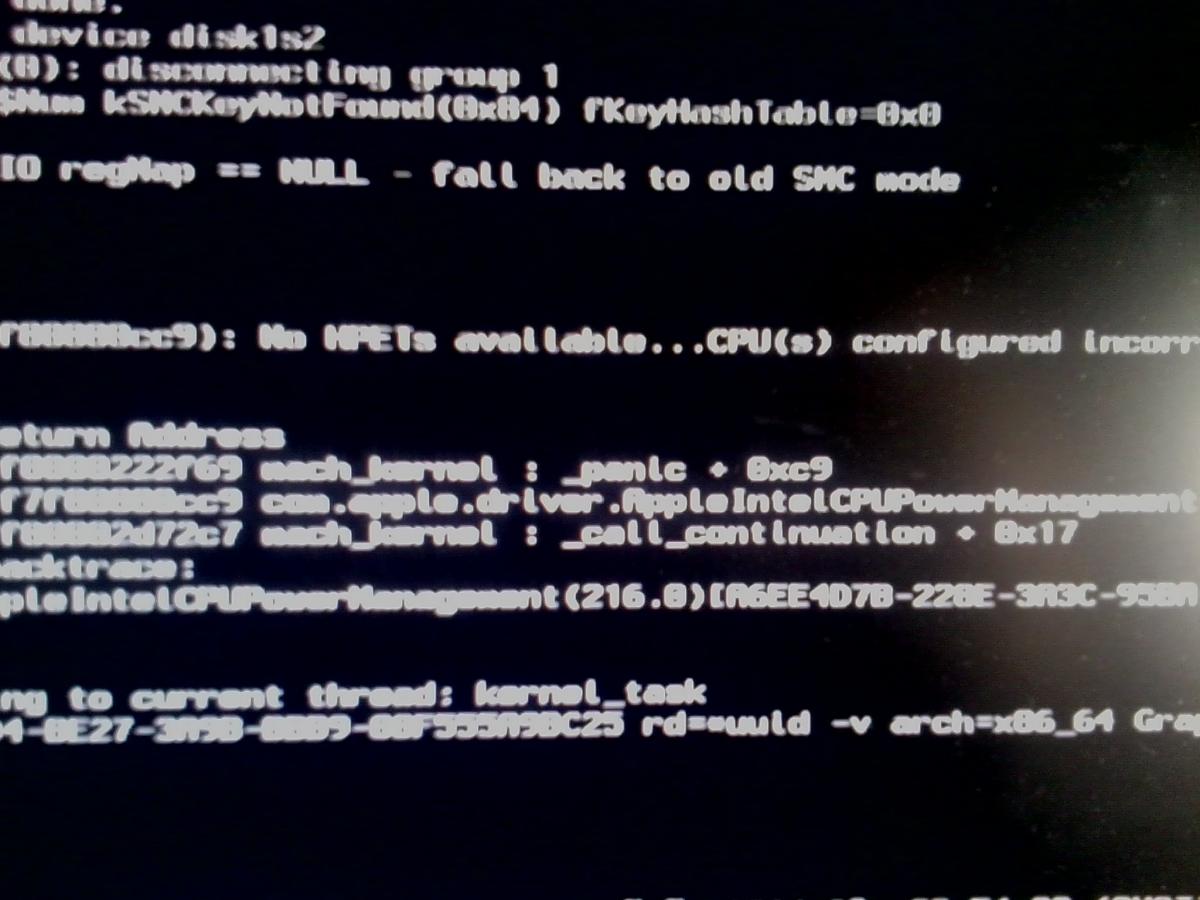

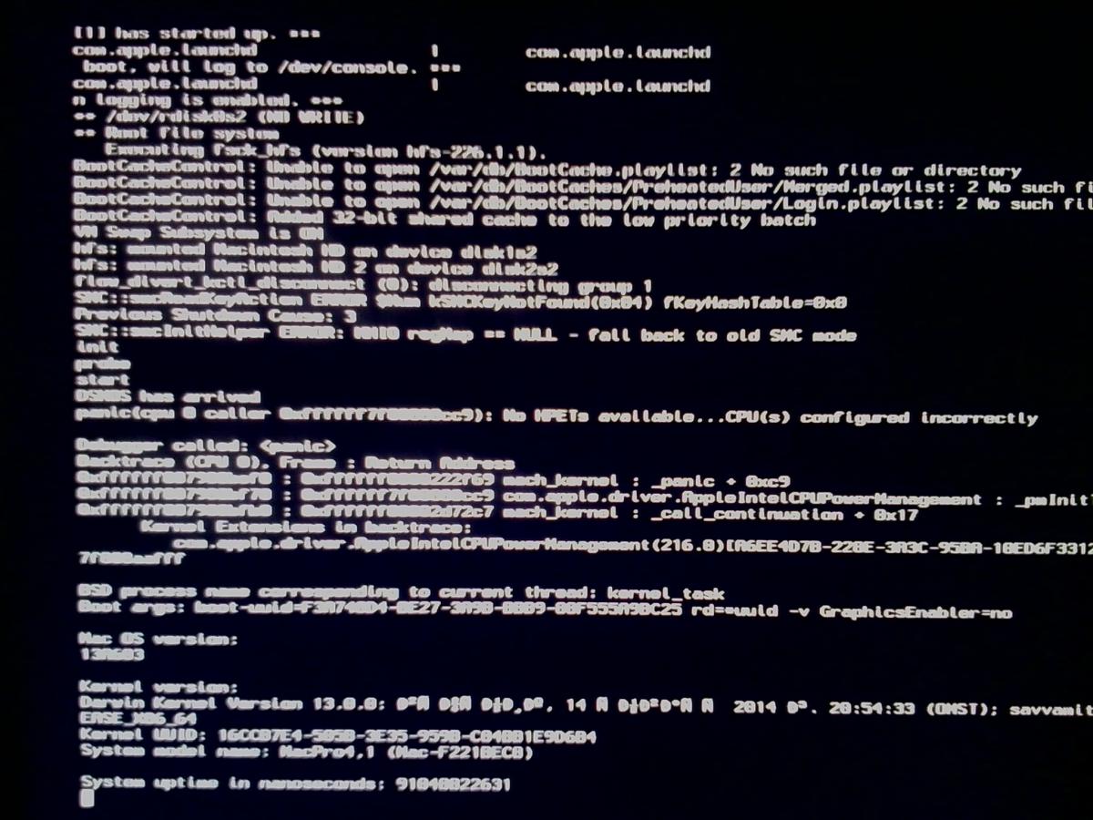

Eweie Posted February 12, 2014 Author Share Posted February 12, 2014 did you mean to install nForceLAN.0.64.5.kext? i installed it. I deleted the kexts you said, moved the kexts from extra to S/L/E. deleted the caches, and repaired permissions and cache with kext wizard. I rebooted and used -v only I got this result. I just rebooted with -x -v -f GraphicsEnabler=No ncpi=0x2000 and i got this kernel panic. Link to comment Share on other sites More sharing options...
iFIRE Posted February 12, 2014 Share Posted February 12, 2014 well, you have installed NULLCPU ? or delete AICPM from S/L/E Link to comment Share on other sites More sharing options...
