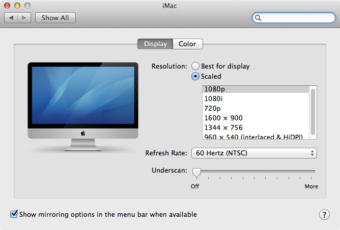

shiecldk Posted December 4, 2013 Share Posted December 4, 2013 Hey Andy, Do you know how to get more HiDPI resolutions in Mavericks? I have a 1920x1080 display. I tried to add 2560x1440 HiDPI by using scale-resolutions property, but I can only get one HiPDI resolution option which is 960x540 (interlaced & HiPDI). I even tried to add scaled resolution with SwitchResX, but it's still in vain Seems this problem had appeared since 10.8.4 came out. Link to comment Share on other sites More sharing options...

Andy Vandijck Posted December 4, 2013 Author Share Posted December 4, 2013 Hey Andy, Do you know how to get more HiDPI resolutions in Mavericks? I have a 1920x1080 display. I tried to add 2560x1440 HiDPI by using scale-resolutions property, but I can only get one HiPDI resolution option which is 960x540 (interlaced & HiPDI). I even tried to add scaled resolution with SwitchResX, but it's still in vain Seems this problem had appeared since 10.8.4 came out. It's possible but I would need the switchresx parameters for the resolution, then I could add it to the EDID. Link to comment Share on other sites More sharing options...

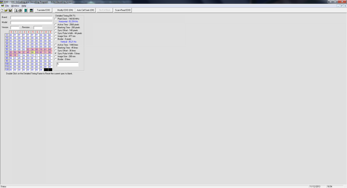

Andy Vandijck Posted December 11, 2013 Author Share Posted December 11, 2013 There it is: EDID.zip Ok, I found some time to do it. I did it in Windows with my mother's PC (lol). Extracted contents: header: 00 ff ff ff ff ff ff 00 serial number: 06 10 07 a0 00 00 00 00 32 14 version: 01 04 basic params: b5 3c 22 78 22 chroma info: 90 c1 a2 59 55 9c 27 0e 50 54 established: bf ef 80 standard: 71 4f 81 00 81 40 81 80 95 00 95 0f a9 40 b3 00 descriptor 1: 02 3a 00 18 a1 a0 2d 50 94 2c 45 08 dd 0c 11 00 00 1e descriptor 2: 02 3a 80 18 71 38 2d 40 58 2c 45 00 dd 0c 11 00 00 1e descriptor 3: 00 00 00 fd 00 32 4b 1f 51 11 00 0a 20 20 20 20 20 20 descriptor 4: 00 00 00 fc 00 69 4d 61 63 0a 20 20 20 20 20 20 20 20 extensions: 01 checksum: ed Manufacturer: APP Model a007 Serial Number 0 Made week 50 of 2010 EDID version: 1.4 Digital display 10 bits per primary color channel DisplayPort interface Maximum image size: 60 cm x 34 cm Gamma: 2.20 DPMS levels: Off Supported color formats: RGB 4:4:4 First detailed timing is preferred timing Established timings supported: 720x400@70Hz 640x480@60Hz 640x480@67Hz 640x480@72Hz 640x480@75Hz 800x600@56Hz 800x600@60Hz 800x600@72Hz 800x600@75Hz 832x624@75Hz 1024x768@60Hz 1024x768@70Hz 1024x768@75Hz 1280x1024@75Hz 1152x870@75Hz Standard timings supported: 1152x864@75Hz 1280x800@60Hz 1280x960@60Hz 1280x1024@60Hz 1440x900@60Hz 1440x900@75Hz 1600x1200@60Hz 1680x1050@60Hz Detailed mode: Clock 148.500 MHz, 477 mm x 268 mm 2560 2708 2752 2840 hborder 0 1440 1476 1481 1485 vborder 0 +hsync +vsync Detailed mode: Clock 148.500 MHz, 477 mm x 268 mm 1920 2008 2052 2200 hborder 0 1080 1084 1089 1125 vborder 0 +hsync +vsync Monitor ranges (GTF): 50-75Hz V, 31-81kHz H, max dotclock 170MHz Monitor name: iMac Has 1 extension blocks Checksum: 0xed (valid) CEA extension block Extension version: 3 15 bytes of CEA data Video data block VIC 16 (native) VIC 04 VIC 31 VIC 05 VIC 20 VIC 19 VIC 18 Vendor-specific data block, OUI 000c03 (HDMI) Source physical address 1.0.0.0 Underscans PC formats by default Supports YCbCr 4:4:4 Supports YCbCr 4:2:2 1 native detailed modes Detailed mode: Clock 74.250 MHz, 477 mm x 268 mm 1920 2448 2492 2640 hborder 0 540 542 547 562 vborder 0 +hsync +vsync interlaced Detailed mode: Clock 74.250 MHz, 477 mm x 268 mm 1920 2008 2052 2200 hborder 0 540 542 547 562 vborder 0 +hsync +vsync interlaced Detailed mode: Clock 74.250 MHz, 477 mm x 268 mm 1280 1720 1760 1980 hborder 0 720 725 730 750 vborder 0 +hsync +vsync Detailed mode: Clock 27.000 MHz, 477 mm x 268 mm 720 732 796 864 hborder 0 576 581 586 625 vborder 0 -hsync -vsync Detailed mode: Clock 27.000 MHz, 477 mm x 268 mm 720 736 798 858 hborder 0 480 489 495 525 vborder 0 -hsync -vsync Checksum: 0xce (valid) If the data you provided me is accurate, it will work just fine. Biggest resolution is 2560x1440 (which you want) followed by 1920x1080. Below is a picture of how I made this (compare it with your screenshot of SwitchResX). Enjoy... EDID_Modded.zip 1 Link to comment Share on other sites More sharing options...
shiecldk Posted December 11, 2013 Share Posted December 11, 2013 Ok, I found some time to do it. I did it in Windows with my mother's PC (lol). If the data you provided me is accurate, it will work just fine. Biggest resolution is 2560x1440 (which you want) followed by 1920x1080. Below is a picture of how I made this (compare it with your screenshot of SwitchResX). Enjoy... Thank you Andy! And thanks your mom too. You're really awesome! The EDID you provide does work in some way. It didn't work if I use the EDID with kext injecting method. (The maximum resolution is still 1920x1080.) I need to inject it through Clover with two keys: (I deleted the kext, so it's easier for us to distinguish the real (SMS22A350H) and the fake (inject the iMac EDID you provide me) display) <key>InjectEDID</key> <true/> <key>CustomEDID</key> <data></data> But problem is after injecting EDID through Clover, I got two displays. iMac is fake, SMS22A350H is real: The primary display (iMac) is not my real display (SMS22A350H). I can set the iMac display to any resolution including 1280x720 (HiDPI) in VNC, but it does not affect the real display I see. So I turn mirroring on: When I choose "optimize for SMS22A350H", there is no way to set 1280x720 (HiDPI). Just like what I've encountered before I used mirroring: When I choose "optimize for iMac(fake display)". The system automatically selects 1280x720, even though I choose 1280x720 (HiDPI): Sorry, I can't make my explanation more simple and clear... I attach two EDID, one is "EDID (Hack to iMac)" which contains the EDID I provided you to mod for me and a kext I used to inject iMac EDID. "EDID (Original SMS22A350H)" is my original data. EDID.zip I don't need us to work on this in a hurry, just take your time if you're busy. If you don't have time you can ignore me, cause it's not so necessary. But it would still be interesting to figure this out. (Although having two displays is interesting enough for me ) Link to comment Share on other sites More sharing options...
