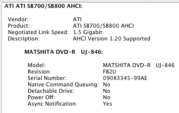

apatsufas Posted November 25, 2010 Share Posted November 25, 2010 Thanks guys!! Work great! Here are my results Link to comment Share on other sites More sharing options...

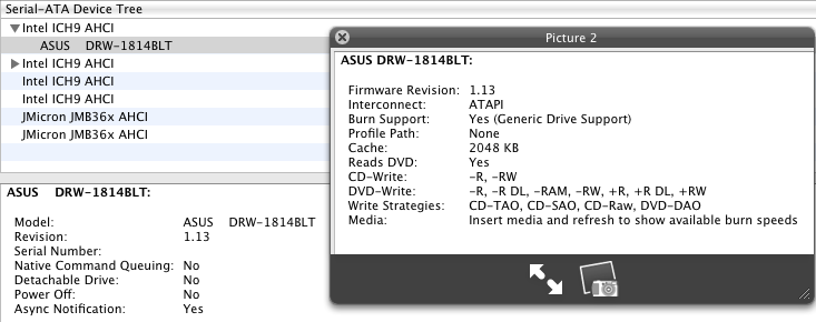

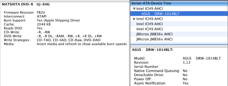

sama7896 Posted November 27, 2010 Share Posted November 27, 2010 I've made builds for Tiger and Leopard as requested... Thank you very much Device is listed as Asus in SATA device tree, but as Apple shipping drive in Disc Burning section of System profiler. No burn test yet. Pic bellow. Link to comment Share on other sites More sharing options...
