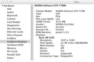

i have an Asus laptop G750 with GTX 770m card and 3D screen cannot get Mavericks 10.9 to boot without removing nvdaresman or using -x (no drivers)
i can however boot with a 1080p dell monitor in the vga port and it will start and then fire up the laptop screen at the login prompt. full res and accelleration on both. i can then disconnect the dell monitor and carry on running. i can "detect displays" and it will now show only the 1 lcd attached. even after sleep i still have full graphics.
the internal lcd is a Samsung 3D (was it blocked by apple deliberately????)
however, i still cannot boot the laptop without the vga monitor.
(the intel onboard graphics are not internally connected so thats not an option)

the lcd screen is now correctly recognised by name and number but only after its booted with the vga monitor attached.
i am looking for clues here as to what i can do next...

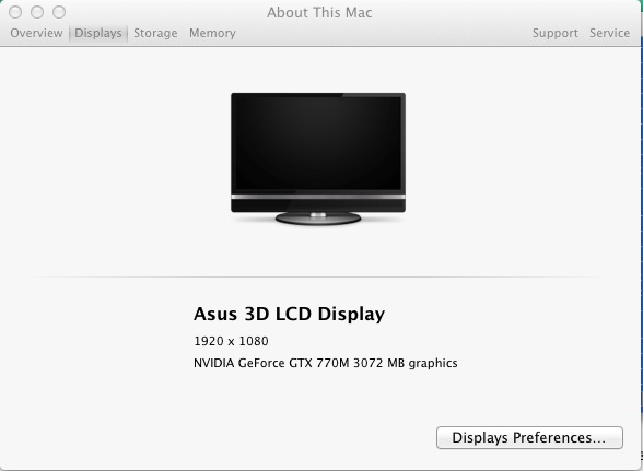

@styrian: have checked the display-cfg booted with -x and with monitor attached (full accell on lcd and monitor) and all 4 entries are the standard value "ff ff ff ff"
in system profile my connection type for the lcd is DisplayPort
"to make your external port be recognized as port of your LVDS" I am thinking I dont have LVDS. is there a way to check?

the gfx card is recognised as shown in #1. tried setting port 0 and 1 but black screen same as before.
very annoying that it works so well, 3d accel, sleep/wake, dual monitor switching etc. but just wont fire up on its own. only with monitor attached.
i did try hdmi vi the TV but that didnt work either. only the vga port will start.
it must be related to the displayport connection internally but i am not sure what i need to change.

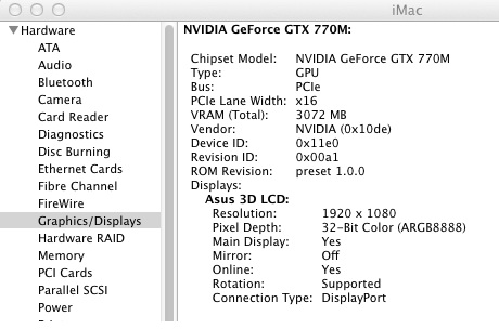

EDIT: i have just checked from Ubuntu Nvidia x server settings and the lcd is driven by DisplayPort as os x shows.
as someone on asus rog suggested, os x is not able to start driving a screen from DisplayPort.
does anyone know how i can tell os x to look for the internal display port first?

i have noticed that since i added in the EDID that i have lost the display option in os x for 120hz which means i was better when it was just recognised natively.
maybe that could be added into the profile later.
