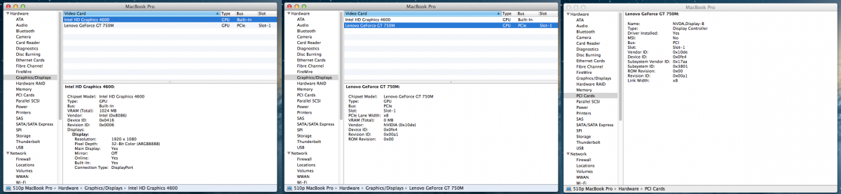

useletters Posted November 21, 2013 Share Posted November 21, 2013 Great.Thanks! There are many guides for patching AppleHDA.Could you specify one? Also, can I disable my integrated GPU both GT750m and Intel HD4600 then use my Ultrabay GT750m? I believe it should be detected as PCIe.. EDIT: And, which wireless card should I buy that would work out of the box? Theoretically, any wireless card should work as my bios is unlocked, right? Link to comment Share on other sites More sharing options...
RehabMan Posted November 22, 2013 Author Share Posted November 22, 2013 Thanks! Could you specify one? Not really. Use google. Also, can I disable my integrated GPU both GT750m and Intel HD4600 then use my Ultrabay GT750m? I believe it should be detected as PCIe.. I don't have much experience with discrete cards, so I'm not sure. You could try and let us know (probably in a different thread, since this is getting quite off-topic). Link to comment Share on other sites More sharing options...
