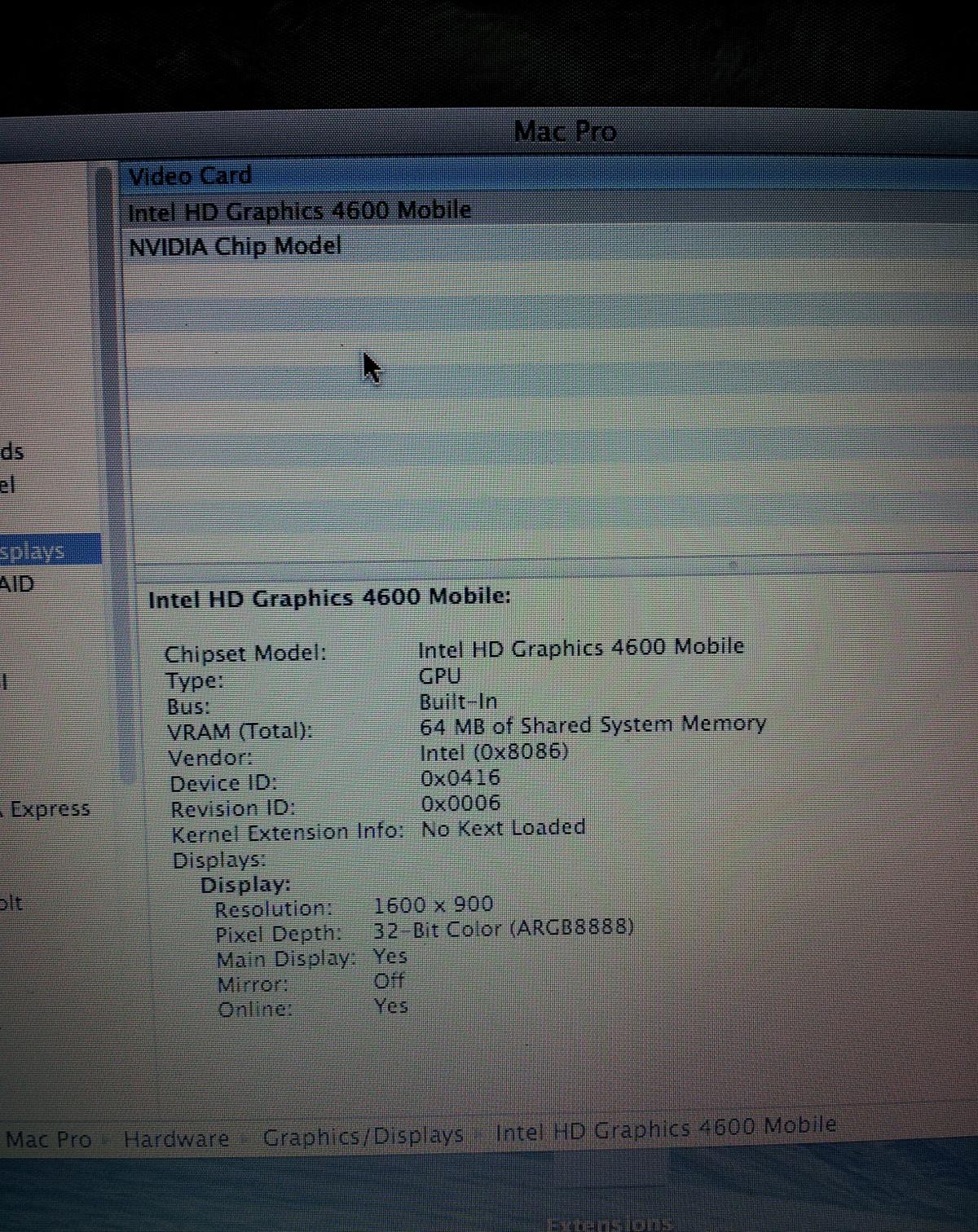

I got boot! After trying your suggestion with the InjectIntel-ig and the IntelAzulFB without success, I decided to install Chimera bootloader 2.2.1 and use IGPEnabler=Yes with GraphicsEnabler=No. One problem I face, is I still don't have QE/CI or any resolution adjustment. In fact, I had to use Graphics Mode to set it. The AppleIntel5000 Kext has loaded as does the FB and IOGraphics, but in the Graphics tab of System Info, shows "No Kext loaded," but the name says Intel 4600 Mobile. Any suggestions?

If you have "No Kext Loaded" then the graphics drivers are not loading.  Make sure they are present in /S/L/E and you have the correct ig-platform-id set.
