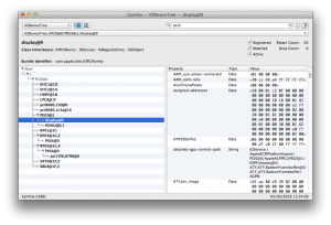

FarmerBill Posted February 5, 2016 Share Posted February 5, 2016 I have attempted to use your audio_cloverALC-HDMI-110.command_v0.8.1 script to enable HDMI audio on my Hackintosh. It says: No AMD/Nvidia discrete graphics card found. I set gDebug=2 to get more info, output attached. The machine has an Asus P8H61 motherboard running Mavericks OSX 10.9.5 with an Asus HD5450 Silent graphics adapter. It uses the AMD5000Controller and AMDRadeonX3000 kexts. I have to edit the AMDRadeonX3000 Info.plist to add the IOPCIMatch id 0x68E11002 for the graphics acceleration to work. This id is already in the AMD5000Controller Info.plist. I have previously used your audio_realtekALC-110_v1.0o1.command script to enable the ALC887 audio, which worked fine. I have also attached the output from the command 'ioreg -rxn PEG0@1' which picks up the graphics and HD audio, and a screenshot of IORegistryExplorer. . Terminal Saved Output.txt Radeon.txt ioreg.txt Audio.txt config copy.txt Link to comment Share on other sites More sharing options...
toleda Posted February 5, 2016 Author Share Posted February 5, 2016 It says: No AMD/Nvidia discrete graphics card found. I set gDebug=2 to get more info, output attached. ioreg.txt and ioreg screenshots, not helpful. IOReg.../File/Save a Copy As... script updated with display@0. Download from repo and run. Link to comment Share on other sites More sharing options...
FarmerBill Posted February 5, 2016 Share Posted February 5, 2016 I have tried your updated script - it found the graphics card and installed a SSDT. After reboot HDMI audio does not appear in the sound preferences, so I ran the script again - it said AMD HDMI audio is not enabled, just like the first time. I have attached the output from running ioreg and the output from your script the first and second time. audio_cloverHDMI-110.command_v0.8.2.txt ioreg2.txt audio_cloverHDMI-110.command_v0.8.2-2.txt Link to comment Share on other sites More sharing options...
toleda Posted February 5, 2016 Author Share Posted February 5, 2016 ioreg.txt again; Ignored Post #331. See Problem Reporting, Post #1, attach all requested files. Link to comment Share on other sites More sharing options...
FarmerBill Posted February 6, 2016 Share Posted February 6, 2016 Sorry, didn't realise you meant IORegistryExplorer. I can't get clover to generate a boot log file, I've checked the clover wiki but no joy. Cynthia.ioreg.zip config.plist.zip SSDT-HDMI-AMD-PEG0.aml.zip Link to comment Share on other sites More sharing options...
toleda Posted February 6, 2016 Author Share Posted February 6, 2016 can't get clover to generate a boot log file Clover log: DPCI Manager/Misc/Boot log ssdt is not loading. Config.plist is a disaster. Remove any property starting with # ACPI/DSDT/Fixes/ Set the following properties to NO: AddHDMI_8000000 FixDisplay_0100 FixHDA_8000 Set ACPI/DSDT/Debug/YES Restart Attach new files Attach EFI/CLOVER/ACPI/origin/ (1st and last dsdt) Link to comment Share on other sites More sharing options...
FarmerBill Posted February 6, 2016 Share Posted February 6, 2016 Ok, nothing in EFI/CLOVER/ACPI/origin/, nothing in EFI/CLOVER/misc, can't find a folder 'DPCI Manager' on the machine. config.plist 2.zip Cynthia.ioreg 2.zip Link to comment Share on other sites More sharing options...
toleda Posted February 6, 2016 Author Share Posted February 6, 2016 Ok, nothing in EFI/CLOVER/ACPI/origin/, nothing in EFI/CLOVER/misc, can't find a folder 'DPCI Manager' on the machine. Frankly, no difference between IORegs, was the edited config.plist installed? See El Capitan AppleHDA HDMI Audio for Post #1/IX - Tools/2. DPCIManager/Misc/Boot log Post #1/IX - Tools/3. MaciASL/File/Extract Tableset.... Attach new files Link to comment Share on other sites More sharing options...
FarmerBill Posted February 7, 2016 Share Posted February 7, 2016 I replaced some valid keys I cut out of config.plist. There are two OSX partitions on this disk - El Capitan and Mavericks. I thought that Clover was reading the config.plist on this partition - Mavericks as it is set as the DefaultVolume, but it appears to have been reading both. So I have made the same changes to the El Capitan config.plist. Now the HDMI audio works on Mavericks, I haven't got to El Capitan yet. It's working on El Capitan as well - Thanks. config.plist 3.zip Cynthia.ioreg 3.zip Cynthia.acpi.zip Boot.log.zip Link to comment Share on other sites More sharing options...
