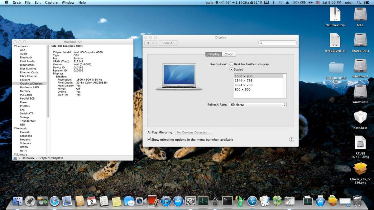

midi-sama Posted October 14, 2013 Author Share Posted October 14, 2013 Thanks for the answer But the nvidia card wont work if the intel doesn't (discrete card :/), I tried a lot of device injections, NO LUCK :'( I just don't know why in clover the thing works (w/out the acceleration) and I see that in About This Mac, I have an Intel HD4000 w/ 5Mb of memory! And even though, I can see HD videos, but I can't play games (I see some glitches in Chess)! Any one can help ? Link to comment Share on other sites More sharing options...

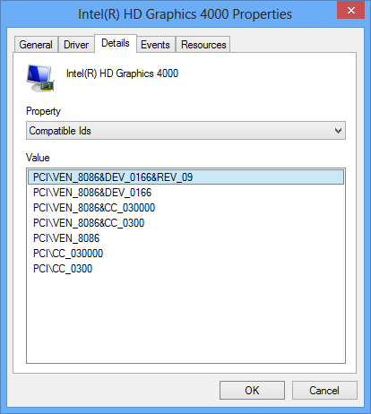

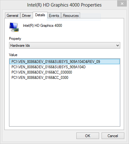

midi-sama Posted October 18, 2013 Author Share Posted October 18, 2013 It tells me that I have hd4000 01660009, tried it lots of times, no luck, maybe because I dont have full ram allocation (63 Mb :/) I'll see what I can do, and thanks for every thing. If you have anything else to show, it will be great Link to comment Share on other sites More sharing options...

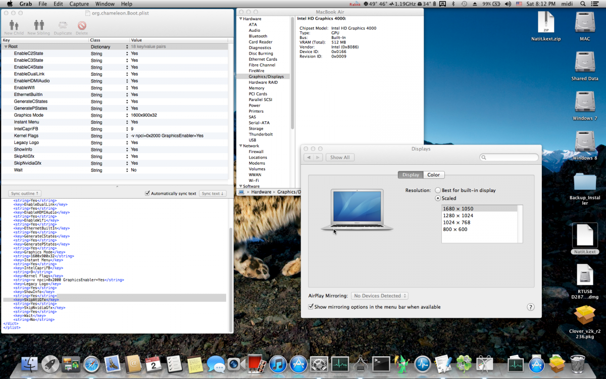

midi-sama Posted November 2, 2013 Author Share Posted November 2, 2013 All the Graphics Kexts are loaded, I went back now to Chameleon -Enoch- (see the boot.plist down) and set ig-platform-id to 9 and GEnabler=Yes, and I activated remote control so I can see what's happening, and guess what! When the screen is off (black but no current). Here a screenshot. and btw, what duallink patch do you mean? DSDT or boot.plist? I'm not using any dsdt for now. THIS WAS TAKEN WHEN I WAS CONTROLLING THE COMPUTER REMOTELY! NEVER MIND see post #1 Link to comment Share on other sites More sharing options...

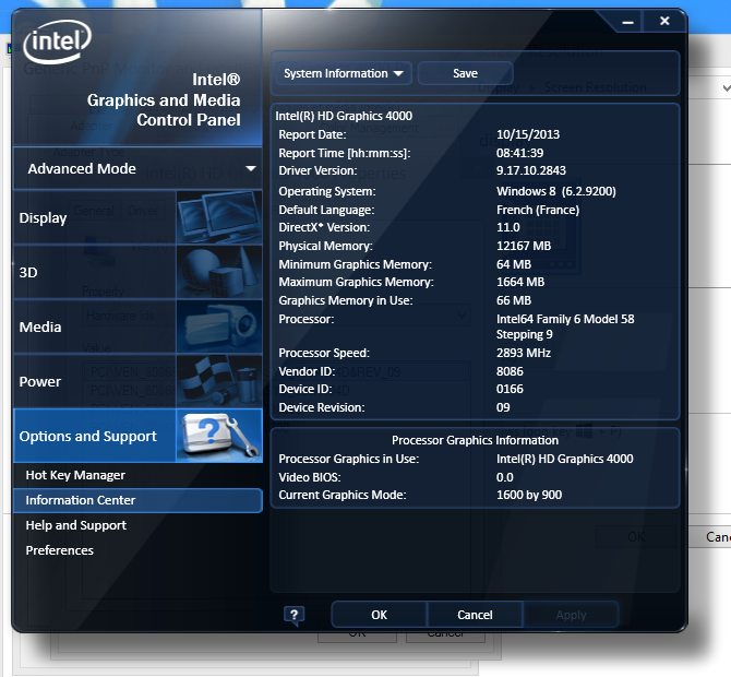

midi-sama Posted November 5, 2013 Author Share Posted November 5, 2013 In fact I have a locked bios (sony laptop) and Chameleon shows me 63Mb of ram, I used IntelCapriFB=4 and I got to the desktop w/ full graphics acceleration but as ig-platform-id 4 have only one port, I cant get the HDMI working :/ The System Infos shows me that I have 1024Mb of graphics ram when using Chameleon, and w/ clover I only have ~350Mb, and now I will try to see how to activate it Link to comment Share on other sites More sharing options...
