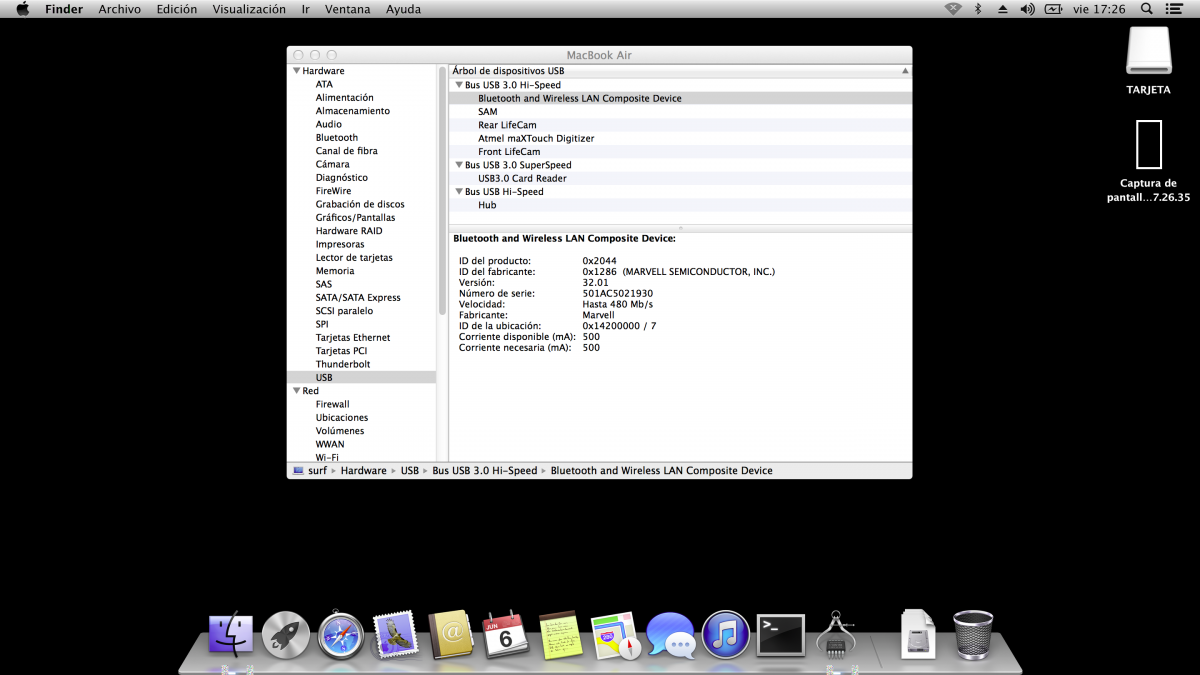

jape Posted June 6, 2014 Share Posted June 6, 2014 Lastly, could someone with a working Avastar installation post what their USB Device Tree looks like in System Report? Mine looks like this: USB Device Tree See attached. On an unrelated note, also on attached screenshot you can see some of the visual corruption that appears on my SFPro2 sometimes... (see dock). Link to comment Share on other sites More sharing options...
