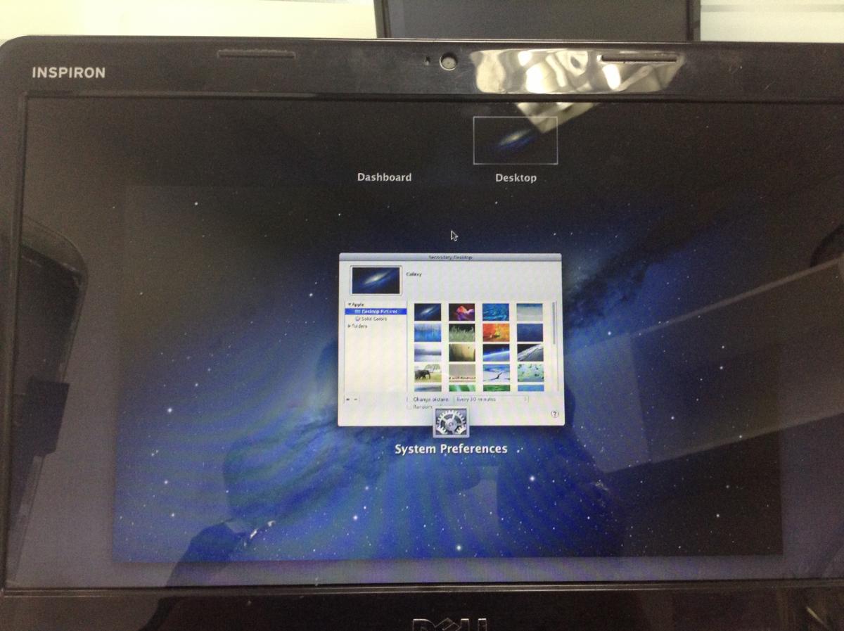

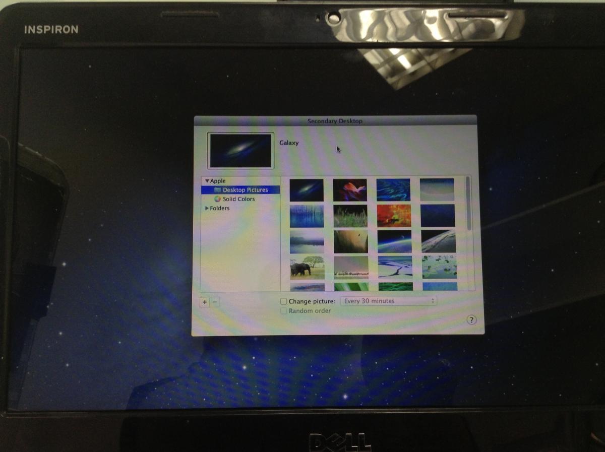

phumap Posted October 21, 2013 Share Posted October 21, 2013 hello about u issue About power management (SpeedStep, sleep) http://olarila.com/forum/viewtopic.php?f=9&t=1003 good hack Hi artur-pt Now i can boot with AICPUPM, although i had aproblem with graphic now. i saw a gray screen after booting, it look like secondary screen. In the log file, it said that couldn't load kext AMDRadeonAccelerator... and many kext failed to load. My graphic card: ATI Mobility HD Radeon 5430. Best regards. Logfile.txt Link to comment Share on other sites More sharing options...

phumap Posted October 22, 2013 Share Posted October 22, 2013 hello try to boot -f -v maybe a problem with caches mine works with injectedid in clover good hack Nothing changes with -f -v. exactly i see the secondary screen. I can change desktop background, view dashboard with ctrl + arrow key. Link to comment Share on other sites More sharing options...

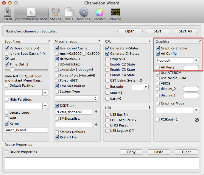

joe75 Posted October 22, 2013 Share Posted October 22, 2013 You will need to try a different framebuffer. You don't say what you use for boot but you will need injection to force a different frambuffer. I'll assume you are using chameleon; try GraphicsEnabler=Yes AtiConfig=Eulemur . You can also add atiports= arg for the number of ports you have. If you can attach an external monitor you could set your main display and it will be saved. Keep in mind that each frame buffer used will keep its own preferences set for window server. Link to comment Share on other sites More sharing options...
