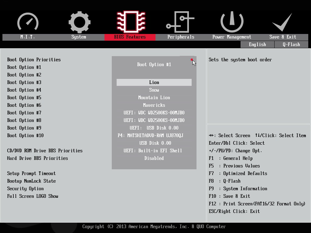

THe KiNG Posted September 18, 2013 Share Posted September 18, 2013 Thx for reporting this,but i think thats that really not nice,its a downgrade. Colors are really ugly. But that only my opinion. Because is a mix of GUI(s) text and colors, see bellow, nothing, just replace the GTSE Module. You didn't understend what I said , this is original: Now look on yours and see how ugly is the Gigabyte text color scheme on QUO graphich color scheme. Graphics(GTSEBin) and text(AMITSE) are not defined in same place! Link to comment Share on other sites More sharing options...
FredWst Posted September 18, 2013 Share Posted September 18, 2013 I'll try tonight. Busy working right now Saving from bios as I Told earlier. Then we don't need xtra tools. And don't have to have an install of Windows. It does'nt work with integrated bios tools, dmi is'nt save, we need to do it with extra tools. Fred Link to comment Share on other sites More sharing options...
truemac Posted September 18, 2013 Share Posted September 18, 2013 Because is a mix of GUI(s) text and colors, see bellow, You didn't understend what I said , this is original: bboot.jpg Now look on yours and see how ugly is the Gigabyte text color scheme on QUO graphich color scheme. Graphics(GTSEBin) and text(AMITSE) are not defined in same place! ah ok understand Quo board dont have 3D mode ? do you think we can change the text color in AMITSE? Link to comment Share on other sites More sharing options...
