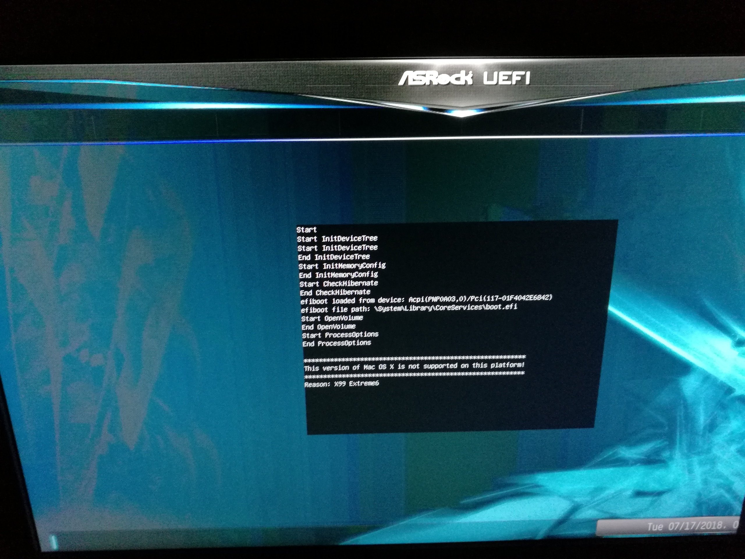

Hi! I have this PC:
i7-6850K
ASRock X99 Extreme6
16GB DDR4
AMD R9 390 8GB
I want install ozmosis bootloader. I maked bios with ozmosis(attached BIOS.zip). I flashed him and not view logo Ozmosis. Next I make USB flash with this contents (USBFLASH.zip),
bcfg driver add 0 DBounce.efi "DBounce".
And after reboot i add APFS boot.efi. I try boot and Mac OS X not supported on this platform. (photo.jpg)

How to run ozmosis on this board?
22 minutes ago, Gudv1n said:
Hi! I have this PC:
i7-6850K
ASRock X99 Extreme6
16GB DDR4
AMD R9 390 8GB
  Hide contents
BIOS.zip
USBFLASH.zip
Make OzmosisDefaults that support this platform, and reboot again.
