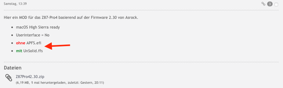

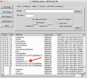

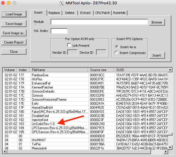

I killed my Z87 and i5, so as temporary resolve (until 10 nm upgrade) I bought z97HD3 (2.0 guess) and Intel Xeon e3-1245 v3 (it went horrible cheap, and work as i7 4770) and currently trying to assemble Oz BIOS, but having a lack of apple/mac accessible devices, so can someone look inside this bios i found online and make a screen about what's in it, thank you:
https://fex.net/get/419594826057/276012037
