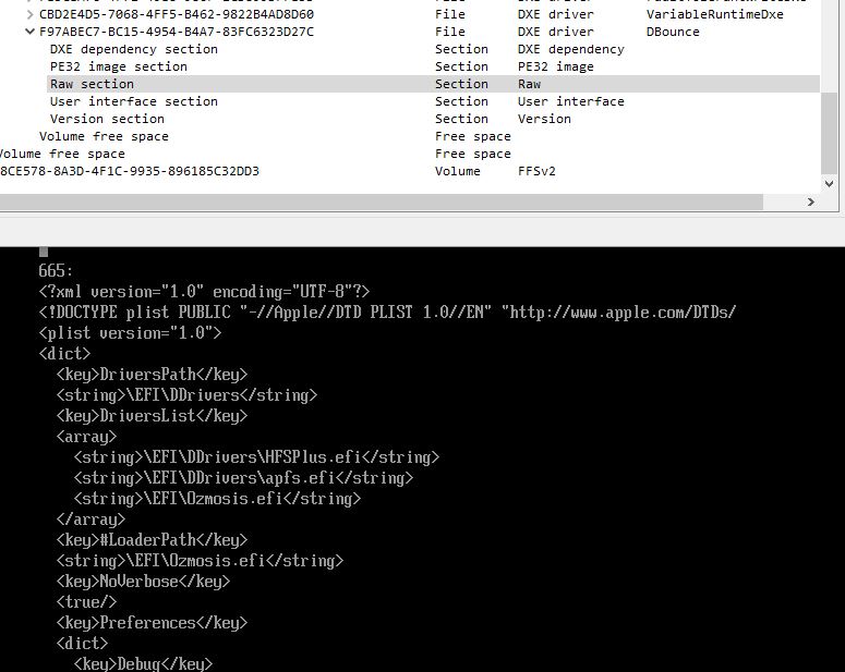

cecekpawon Posted December 16, 2017 Share Posted December 16, 2017 If you are seeing OzAcpi or OzDarwin folders check if you have replaced FileSystem (93022F8C-1F09-47EF-BBB2-5814FF609DF5) with EnhancedFat (961578FE-B6B7-44C3-AF35-6BC705CD2B1F) and also check if you have added PartitionDxe/EnhancedPartition (1FA1F39E-FEFF-4AAE-BD7B-38A070A3B609).Marked as IMPORTANT post. I spent 2 days to figure out why I had those strange dirs and my Oz refused to boot. Link to comment Share on other sites More sharing options...

cecekpawon Posted December 16, 2017 Share Posted December 16, 2017 Are these new findings will lead to auto load apfs and boot directly to OS even with nvram reset?Not to load apfs directly from "/usr/standalone/i386/", but somewhere from your esp. In case you load it with bcfg, you will need to reregister the driver after doing Oz nvram reset. Link to comment Share on other sites More sharing options...

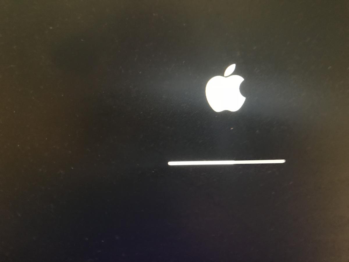

lexb Posted December 17, 2017 Share Posted December 17, 2017 Unfortunately for me, I'm still not getting any further. After adding the plist to the EFI directory and rebooting, still no audio or bluetooth in El Capitan. As well, restarting the PC to install the update to High Sierra, it shows a black screen with the apple logo on it and a loading bar for almost a hour, then it reboots to a garbled screen. I tried the trick of holding down the cmd option p & r keys at start to clear the NVRAM to make sure my updated plist was being acknowledged. Im sure I screwed something up since I know so little about the process. I wonder if a clean install rather than updating from a cloned drive might be a better path...? Im not even certain ive effectively been able to clear the nvram as when the computer posts and i hold the correct keys, it doesnt reboot and post again. If i do it after the bootloader it does nothing as well. Defaults.zip Link to comment Share on other sites More sharing options...

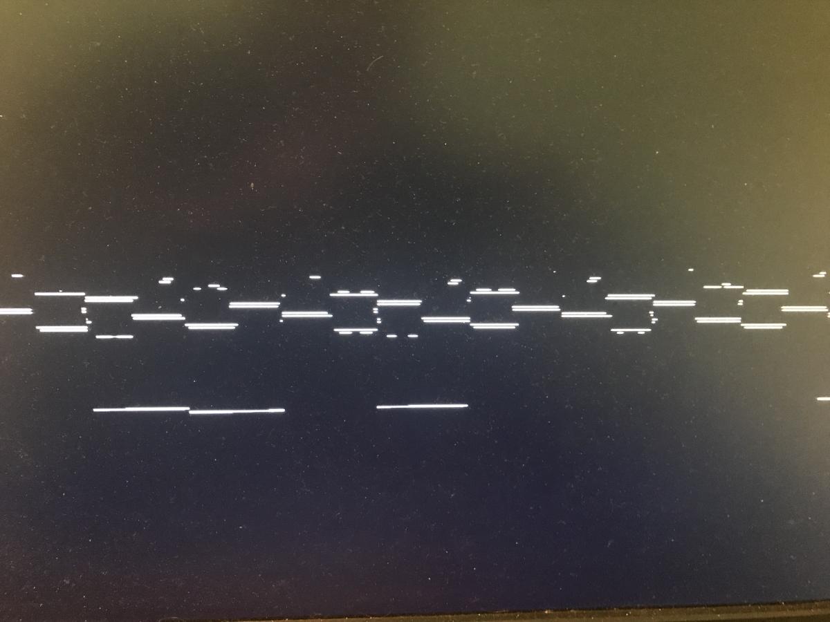

lexb Posted December 18, 2017 Share Posted December 18, 2017 I think the issue may be that trying to clear the NVRAM isnt working to be honest. I can assure you that I previously followed your instructions and used ONLY the plist you provided and had the same results. Then I tried modifying it to include the additional info and had the same results. It seems like all the lists have no effect. When I try to clear the NVRAM at bootup, it doesnt do the restart as It used to when clearing the NVRAM. I also tried clearing the NVRAM using terminal as well. Ill try your plist again. One thing I also noticed is that now, when the system it booting regularly, it shows that load bar, then for the last portion of the loading the screen goes all pixelated just like when trying to update the system, then it starts up. Link to comment Share on other sites More sharing options...

ammoune78 Posted December 18, 2017 Share Posted December 18, 2017 I think the issue may be that trying to clear the NVRAM isnt working to be honest. I can assure you that I previously followed your instructions and used ONLY the plist you provided and had the same results. Then I tried modifying it to include the additional info and had the same results. It seems like all the lists have no effect. When I try to clear the NVRAM at bootup, it doesnt do the restart as It used to when clearing the NVRAM. I also tried clearing the NVRAM using terminal as well. Ill try your plist again. One thing I also noticed is that now, when the system it booting regularly, it shows that load bar, then for the last portion of the loading the screen goes all pixelated just like when trying to update the system, then it starts up. I think you have to re-flash the mobo from windows to do the two steps flashing, also, rebuild your ROM again download the rom delete Ozmosis existing one, and re-insert the cecekpawon one, try to replace body of the OzmosisDefaults with the final one that you will use with updated serials, then put the same one Efi\Oz\Defaults.plist. The freezes came from IGPU, sound if enabled and you already have VoodooHDA on the bios it should work, but as I suggested you, PM IronManJFF to start your Hack! 1 Link to comment Share on other sites More sharing options...
