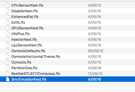

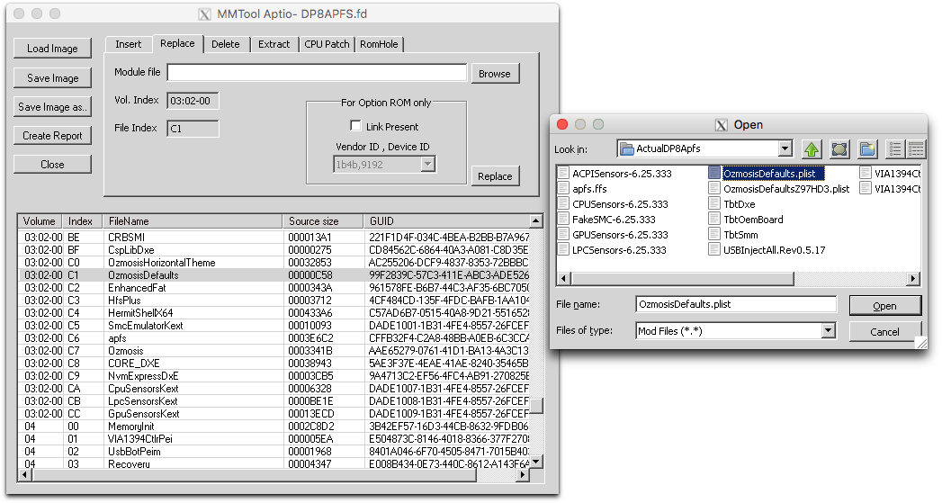

Si Vis Pacem Posted September 26, 2017 Share Posted September 26, 2017 @medallo Replace SMC+Sensors, Ozmosis, OzmosisDefaults with current versions and add GM apfs.ffs. In OzmosisDefaults: Change FirmwareFeatures, FirmwareFeaturesMask, BiosVersion, BiosDate Use KextToFfs to convert new OzmosisDefaults and apfs.efi to their ffs-versions: Put OzmosisDefaults.plist in Ozm and apfs.efi in Efi. ./KextToFfs.command You will find the resulting ffs files in the Ffs folder. Use MMTool and replace the files in the bios like this: Load the bios file in MMTool and select the entry you want to replace, select the Replace tab and browse for the new file and hit replace. Save As different file and flash it. Link to comment Share on other sites More sharing options...
elviejo Posted September 27, 2017 Share Posted September 27, 2017 @medallo Replace SMC+Sensors, Ozmosis, OzmosisDefaults with current versions and add GM apfs.ffs. In OzmosisDefaults: Change FirmwareFeatures, FirmwareFeaturesMask, BiosVersion, BiosDate Use KextToFfs to convert new OzmosisDefaults and apfs.efi to their ffs-versions: Put OzmosisDefaults.plist in Ozm and apfs.efi in Efi. Bildschirmfoto 2017-09-26 um 08.21.11.png ./KextToFfs.command You will find the resulting ffs files in the Ffs folder. Use MMTool and replace the files in the bios like this: Load the bios file in MMTool and select the entry you want to replace, select the Replace tab and browse for the new file and hit replace. Bildschirmfoto 2017-09-26 um 08.25.21.png Save As different file and flash it. Where we can found current versions of SMC+sensors and Ozmosis? Link to comment Share on other sites More sharing options...
