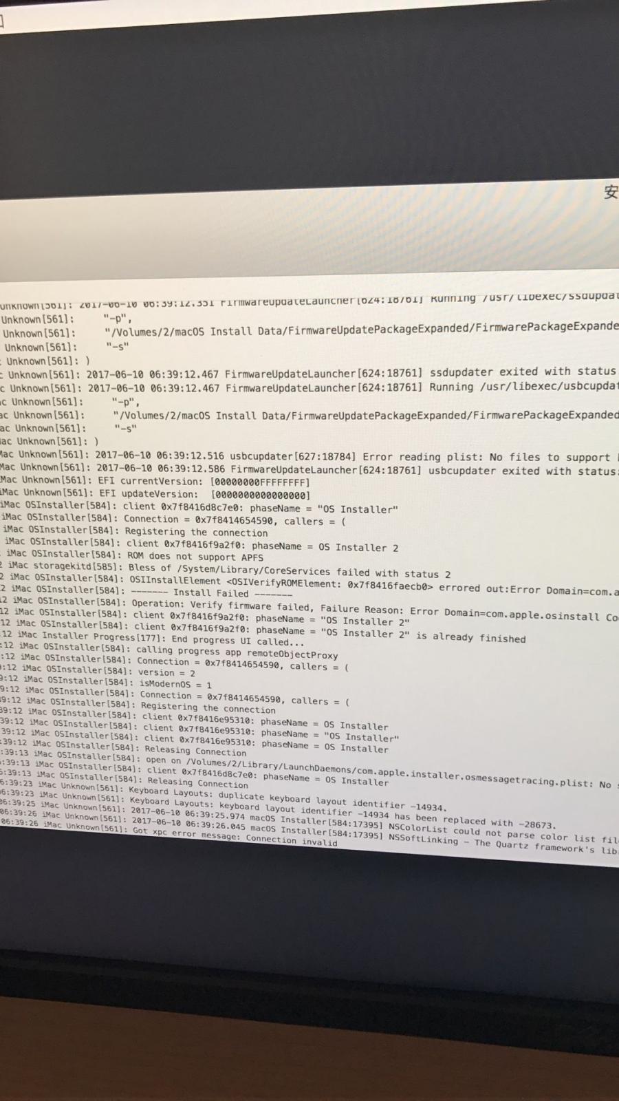

D1ves Posted June 10, 2017 Share Posted June 10, 2017 新的错误。这是日志: [附件= 243809:421AFD5FC94D1CBE45D34A4E0B104594.jpg] @cecekpawon Link to comment Share on other sites More sharing options...
cecekpawon Posted June 10, 2017 Share Posted June 10, 2017 Have you tried to manually patch OSInstaller? 155FE503004889C34885DB 74 26 155FE503004889C34885DB EB 26 Link to comment Share on other sites More sharing options...
D1ves Posted June 10, 2017 Share Posted June 10, 2017 你试过手动修补OSInstaller吗? 155FE503004889C34885DB 74 26 155FE503004889C34885DB EB 26 @cecekpawon 嘿,老板,你可以用这个更新ozmosis吗? 我会尝试这个,但我把fakesmc没有修复到S / L / E,没有FF / FFM,它 绕过固件更新和检查的成功! Link to comment Share on other sites More sharing options...
cecekpawon Posted June 10, 2017 Share Posted June 10, 2017 No my man, OsInstaller come with installer, nothing to do with Ozmosis Link to comment Share on other sites More sharing options...
