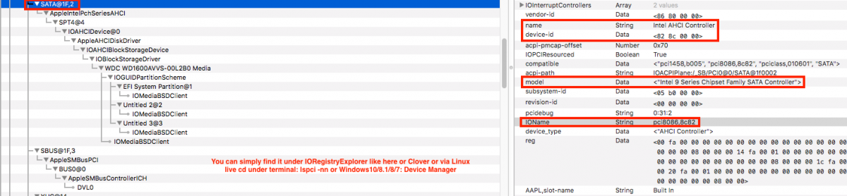

How can I find in IORegistryExplorer what you need?
Quite simple, just open IORegistryExplorer and go to SAT0 or SAT1 or SATA and it's done, follow this ScreenShot:

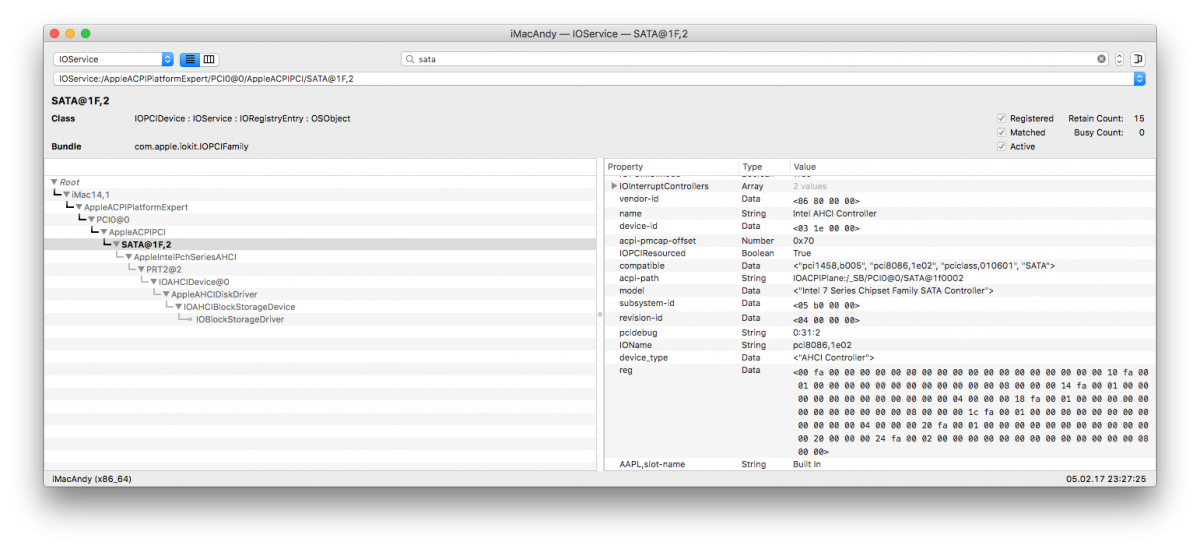

I hope I can help a little bit. here is my screen from the: GA-Z77N-WiFI
Thanks CrazyCreator for your fast reply, your Mobo has the 1e03 ID and the QUO one in InjectorKext has the 1e02!
But I still have a doubt, you may have to find it under windows or ubuntu live dvd to be sure. Because in the ScreenShot you've posted there's two ID one from QUO and the other from the board I think.

Yeah, the Device ID is [1e02], but I don't know why the [1e03] appear as Device ID in your IOReg  :whistle:, maybe it's the SATA II port? Anyway, as you use the iMac SMBios you can enter those Device ID's to your injected properties in the DSDT ^_^ !

Your board have the same Device ID of the QUO board, so no need to add it into InjectorKext because it's already there.
But if you look at your IORegistryExplorer posted yesterday, you will see 2 Device IDs:
1e02: the right one
and
1e03: it's this one that I not understand why it's there.
If I try to understand why, and because your lspci -nn did not show it, it's related to your DSDT because it not have a patch for SATA.
