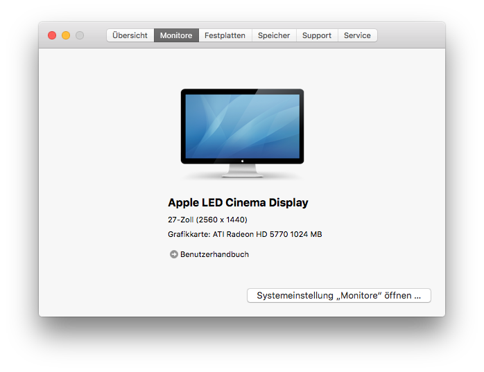

THe KiNG Posted January 17, 2016 Share Posted January 17, 2016 What resolution have your Monitor ... I see not so much icons on my screen. 2560x1440 Link to comment Share on other sites More sharing options...
CrazyCreator Posted January 17, 2016 Share Posted January 17, 2016 me too ... Apple Cinema Display with Display Port Link to comment Share on other sites More sharing options...

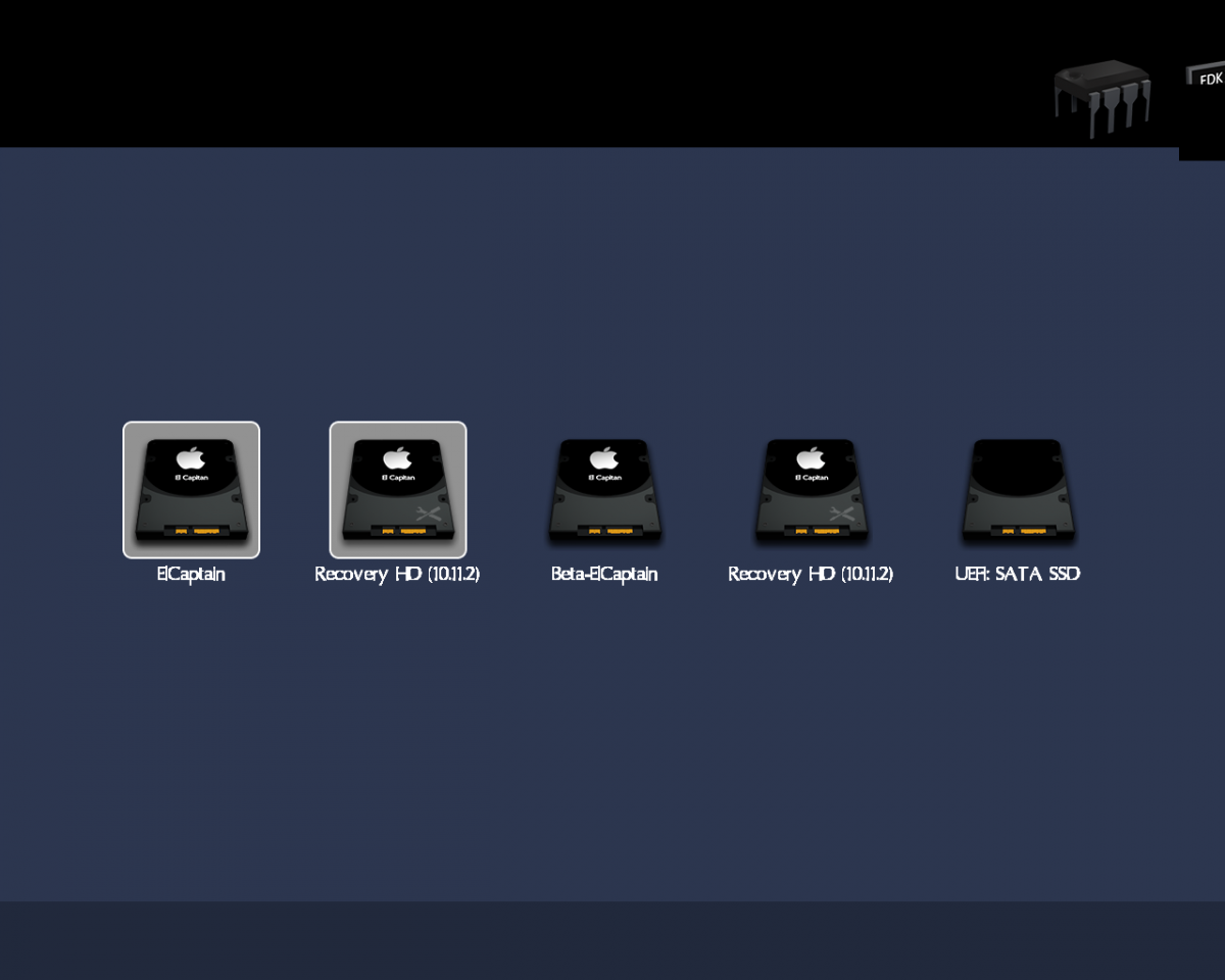

THe KiNG Posted January 18, 2016 Share Posted January 18, 2016 me too ... Apple Cinema Display with Display Port Press F10 while in GUI to take screenshot, it will be on EFI/OZ folder, check the resolution of the pic, if is not 2560*1440 then you know where is the problem. Link to comment Share on other sites More sharing options...

CrazyCreator Posted January 18, 2016 Share Posted January 18, 2016 ok ... here is the screen: The Image has a resolution of 1280x1024: but my Monitor has a Resolution of 2560x1440 ... Strange: When I click with the navigation buttons to the right for 2 clicks no icon selected, then coming from the left back to the Screen the marker again to the icons, but marked 2 icons simultaneously. Can I adjust the resolution, the Ozmosis uses somewhere? Link to comment Share on other sites More sharing options...

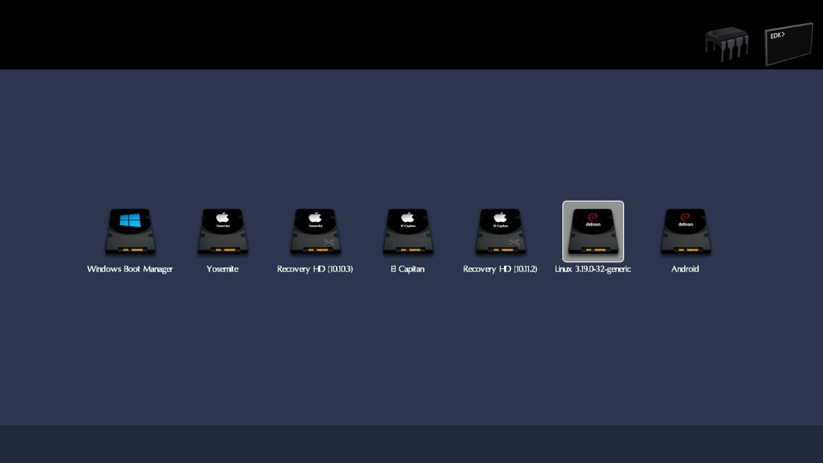

Tusskan Posted January 18, 2016 Share Posted January 18, 2016 after adding the command for Manjaro Linux to load its grubx64.efi everything worked, but after doing the nvram reset it's gone and i had to re-enter the command. Is there a way/method to make it permanent from Defaults.plist or where it takes. It's really painful to have to enter the command each time i reset the nvram. bcfg boot add 1 fs0:\EFI\manjaro_grub\grubx64.efi "Manjaro" Link to comment Share on other sites More sharing options...
crusher Posted January 18, 2016 Share Posted January 18, 2016 always after reset nvram you must added manjor manualy!!! Link to comment Share on other sites More sharing options...
Tusskan Posted January 18, 2016 Share Posted January 18, 2016 always after reset nvram you must added manjor manualy!!! so there is no way ? or even make a permanent Linux bootmanger as in Archlinux? Link to comment Share on other sites More sharing options...
davidm71 Posted January 18, 2016 Share Posted January 18, 2016 Research and use Easyuefi and make a backup of the uefi boot menu. Link to comment Share on other sites More sharing options...
crusher Posted January 18, 2016 Share Posted January 18, 2016 so there is no way ? or even make a permanent Linux bootmanger as in Archlinux? Why u reset NVRAM? You put command in Shell and dont touch anything!!!! This is your choice!!! 1 Link to comment Share on other sites More sharing options...
Tusskan Posted January 18, 2016 Share Posted January 18, 2016 Why u reset NVRAM? You put command in Shell and dont touch anything!!!! This is your choice!!! cause i'm testing this piece of cake of software, and i'd like to test/learn all about it my friend. Link to comment Share on other sites More sharing options...
THe KiNG Posted January 18, 2016 Share Posted January 18, 2016 after adding the command for Manjaro Linux to load its grubx64.efi everything worked, but after doing the nvram reset it's gone and i had to re-enter the command. Is there a way/method to make it permanent from Defaults.plist or where it takes. It's really painful to have to enter the command each time i reset the nvram. bcfg boot add 1 fs0:\EFI\manjaro_grub\grubx64.efi "Manjaro" You should't need any of this with Ozmosis 1669 and up, if is setup proper, the Linux entry should be added automate, just make sure you have all the required files/filesystems. 1 Link to comment Share on other sites More sharing options...
Tusskan Posted January 18, 2016 Share Posted January 18, 2016 You should't need any of this with Ozmosis 1669 and up, if is setup proper, the Linux entry should be added automate, just make sure you have all the required files/filesystems. Picture20160118195050.jpg all things are sorted properly in its right place, you mean the efi files? it is not detected in boot list (F12 or Theme) i'm on the Xmass version not 1669M (i'll update my signature NOW) here: Link to comment Share on other sites More sharing options...
THe KiNG Posted January 18, 2016 Share Posted January 18, 2016 all things are sorted properly in its right place, you mean the efi files? Really? And what should tell me that picture? Where is the bdmesg and/or rom? Link to comment Share on other sites More sharing options...

CrazyCreator Posted January 18, 2016 Share Posted January 18, 2016 @THe KiNG Have you read my last posting? Any Idea? Link to comment Share on other sites More sharing options...
crusher Posted January 18, 2016 Share Posted January 18, 2016 Really? And what should tell me that picture? Where is the bdmesg and/or rom? Here is the bdmesg http://www.insanelymac.com/forum/topic/291655-ozmosis/?p=2206646 Link to comment Share on other sites More sharing options...
blackosx Posted January 18, 2016 Share Posted January 18, 2016 @CrazyCreator For resolution have you tried adding the HermitCsmVideo module in to your bios? I also have the issue with the UI when it takes a couple of key presses to advance to the next boot option. I have a feeling it has something to do with the boot options that are shown in my F8 boot menu but not shown in the UI. I understand the UI is in beta so I'm sure this will be sorted in time. Link to comment Share on other sites More sharing options...
Tusskan Posted January 18, 2016 Share Posted January 18, 2016 Really? And what should tell me that picture? Where is the bdmesg and/or rom? look down Here is the bdmesg http://www.insanelymac.com/forum/topic/291655-ozmosis/?p=2206646 and here is a new one and Darwin Dumper aswell. kindly find the attachments. bdmesg.text.zip DarwinDumper_2.9.9.2_Ozmosis_1.03.167X-MASS_Cap_tusskan.7z Link to comment Share on other sites More sharing options...

CrazyCreator Posted January 18, 2016 Share Posted January 18, 2016 @CrazyCreator For resolution have you tried adding the HermitCsmVideo module in to your bios? I also have the issue with the UI when it takes a couple of key presses to advance to the next boot option. I have a feeling it has something to do with the boot options that are shown in my F8 boot menu but not shown in the UI. I understand the UI is in beta so I'm sure this will be sorted in time. when i add the HermitCsmVideo i must in bios select CSM=Enabled? Some times ago i enabled CSM in my Bios with the Result: Black Screen on all Ports Can this happen again? Link to comment Share on other sites More sharing options...
THe KiNG Posted January 18, 2016 Share Posted January 18, 2016 all things are sorted properly in its right place... look down and here is a new one and Darwin Dumper aswell. kindly find the attachments. This is the last time I will say it: If you guys cannot fallow an example as is on released AOS ROM or THIS ONE I MADE especial to prove what you all are doing wrong then is pointless... You all should go back to the "fast food store" who made the BIOS for you and ask for help, don't spam this topic with useless questions! How the fulk should work UEFI boot for Linux when NO EXTFS driver exist at least? I really dunno why the fulk people refuse to use onboard brain and do the job and instead take crapless job made by some bored geeks. Link to comment Share on other sites More sharing options...
Tusskan Posted January 18, 2016 Share Posted January 18, 2016 This is the last time I will say it: If you guys cannot fallow an example as is on released AOS ROM or THIS ONE I MADE especial to prove what you all are doing wrong then is pointless... You all should go back to the "fast food store" who made the BIOS for you and ask for help, don't spam this topic with useless questions! How the fulk should work UEFI boot for Linux when NO EXTFS driver exist at least? I really dunno why the fulk people refuse to use onboard brain and do the job and instead take crapless job made by some bored geeks. i can't find room for this extension/driver in my bios can you make me one, i'm still noob at this and i'm trying to learn as much as i can. thanks for pointing out the solution and about the offenses non taken. http://www.gigabyte.com/products/product-page.aspx?pid=4518#bios Link to comment Share on other sites More sharing options...
THe KiNG Posted January 19, 2016 Share Posted January 19, 2016 i can't find room for this extension/driver in my bios... Sure you can , you just need to want to do it, and no, I wont make another BIOS, the point is to make the food not just order it... 1 Link to comment Share on other sites More sharing options...
