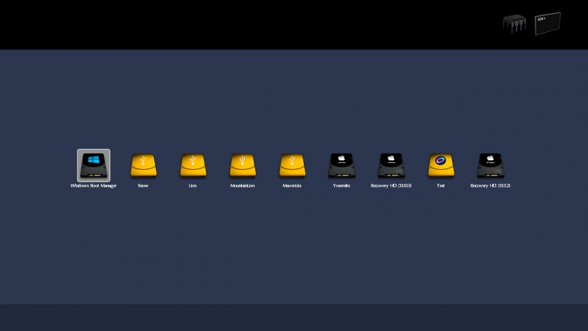

THe KiNG Posted December 24, 2015 Share Posted December 24, 2015 ha ha.. brilliant! EDIT: Dear santa.. Please can you bring http://www.insanelymac.com/forum/topic/291655-ozmosis/?p=2193678 It looks fab. Looks like Santa did hear you... Is this what you wanted? 6 Link to comment Share on other sites More sharing options...
blackosx Posted December 24, 2015 Share Posted December 24, 2015 Wow. Thank you Santa! I wasn't really expecting anything so soon.. I look forward to seeing it. 1 Link to comment Share on other sites More sharing options...

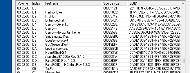

davidm71 Posted December 24, 2015 Share Posted December 24, 2015 Hello to all ! Am I the only one that have issues with my USB ports ?... no USB3, and only 2 USB ports available on the 6 of my motherboard ?... Anyone have a solution for this ? My version of Ozmosis is the F7 1669... thanks a lot ! Try Rehabmans FakepcIID Xchi and usb kexts. I put mine in my Esp partition. https://bitbucket.org/RehabMan/os-x-fake-pci-id/downloads Also regarding my previous help request for getting two monitors going i settled for one dvi and one hdmi port which works. Link to comment Share on other sites More sharing options...

pmcnano Posted December 24, 2015 Share Posted December 24, 2015 No, just more detailed "description"... Thanks man! Happy Holidays. I'm going to test injecting FakepcIID USB kexts from bios, I'll report back. EDIT: Cool, everything worked perfectly! Aside from AppleHDA, got a vanilla system. 1 Link to comment Share on other sites More sharing options...

davidm71 Posted December 24, 2015 Share Posted December 24, 2015 Having a problem inserting my ffs kext converted files into my bios. MMTool says file with same guid already exists. Anyone can help? Thanks. Link to comment Share on other sites More sharing options...
crusher Posted December 24, 2015 Share Posted December 24, 2015 Do you try with new version of MMTool for Windows. https://www.dropbox.com/s/bd4usoxsbmt7xxa/AMI%20Aptio%20UEFI%20MMTool%20v5.0.0.7.rar?dl=0 Link to comment Share on other sites More sharing options...
davidm71 Posted December 24, 2015 Share Posted December 24, 2015 Using UEFITool instead. Thanks for the file. EDIT: Wow!!! This is so slick! Thank you King! You made my Xmass! Link to comment Share on other sites More sharing options...
