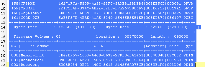

Indeed same issue here with giga z68ma-d2h @ 4mb bios. Already delete some device id's in core (8086,2822 & 8086,162)
Have about 1800kb free in volume 2. But Total free space is 280kb

Hi,
You have to focus on volume 01, because the volume 02 is a part of it, it's already a compressed section.
If you try CodeRush's UefiTool, you'll see it. http://forums.mydigitallife.info/threads/48979-UEFITool-UEFI-firmware-image-viewer-and-editor
Here's what i've done on your rom:
| Firmware Volume : 01               Location :  001C0000   Length :  1B0000  |
|NO |    FileName   |               GUID                 |Location| Size |Type|
|000|               |AE717C2F-1A42-4F2B-8861-78B79CA07E07|001C0048|18BF9E|FV  |
|001|               |17088572-377F-44EF-8F4E-B09FFF46A070|0034BFE8|020818|RAW |
|002|S3Restore      |EFD652CC-0E99-40F0-96C0-E08C089070FC|0036C800|0025BC|PEIM|
| Bytes Free       : 001240 (  4 KB)    Bytes Used       : 1AEDC0 (1723 KB)    |
| Firmware Volume : 02               Location :  00000000   Length :  606000  |
|000|IntelSaGopDriver|5C266089-E103-4D43-9AB5-12D7095BE2AF|00000048|001335|DRVR|
|001|IntelSnbGopDriv|8D59EBC8-B85E-400E-970A-1F995D1DB91E|0000137D|00AE64|DRVR|
|160|CORE_DXE       |5AE3F37E-4EAE-41AE-8240-35465B5E81EB|003E59D3|174641|DXEC|
|161|EnhancedFat    |961578FE-B6B7-44C3-AF35-6BC705CD2B1F|0055A014|00343A|DRVR|
|162|HfsPlus        |4CF484CD-135F-4FDC-BAFB-1AA104B48D36|0055D44E|003712|DRVR|
|163|PartitionDxe   |1FA1F39E-FEFF-4AAE-BD7B-38A070A3B609|00560B60|0018C2|DRVR|
|164|OzmosisDefaults|99F2839C-57C3-411E-ABC3-ADE5267D960D|00562422|0000FC|FRFM|
|165|FakeSMC.Rev-5.3|DADE1001-1B31-4FE4-8557-26FCEFC78275|0056251E|01DAA8|DRVR|
|166|Ozmosis        |AAE65279-0761-41D1-BA13-4A3C1383603F|0057FFC6|04C6CC|DRVR|
|167|DisablerKext   |DADE1002-1B31-4FE4-8557-26FCEFC78275|005CC692|0108A4|FRFM|
|168|InjectorKext   |DADE1003-1B31-4FE4-8557-26FCEFC78275|005DCF36|000514|FRFM|
|169|OzmosisTheme   |AC255206-DCF9-4837-8353-72BBBC0AC849|005DD44A|027AFC|FRFM|
| Bytes Free       : 0010BA (  4 KB)    Bytes Used       : 604F46 (6163 KB)    |
No extfs injected, if you want it you have to make some room.
| Total Bytes Free : 011558 (  69 KB)   Total Bytes Used : 3EEAA8 (4026 KB)   |
