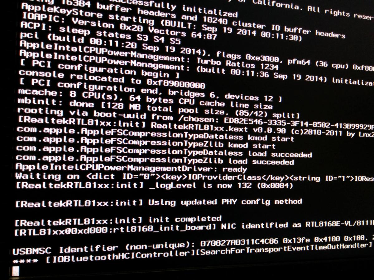

I did reset the NVRAM using Option+Command+P+R, saw the colors. What I'm trying to achieve here is to boot the vanilla Yosemite USB installer using boot parameters.
I flashed the BIOS of my AsRock z75 Pro3 on a machine which has no operating system on it. When booting from the USB in verbose mode it hangs there:
So I was simply trying to see if there was a way I could boot the USB installer passing various parameters to see if it would get passed this. (ex: -v -f npci=0x3000)
Which cpu are you using?
Bt error related it's not about BT but about does'nt recognize graphics card.
Suggestion, if you can, use a real Graphics card instead of integrated.
If your cpu has integrated graphics that is supported by Yosemite, maybe you have to edit OzmosisDefault injecting IntelGraphics AAPL and so on
Read OzmosisDefault variable file to know it

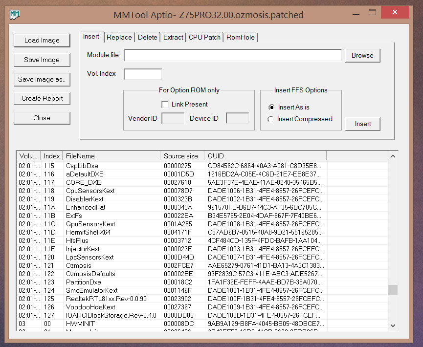

I have an i2600K CPU. So it's HD3000 I think. I could also use a NVIDIA 560TI 1GB I have laying around.
Look this is wrong bios. Remove realtek and ioahciblockstorage kext from rom.
Put kext in EFI/Oz/Darwin/Extensions/Common folder!!!!!

I have SmcEmulatorKext in the patched BIOS
