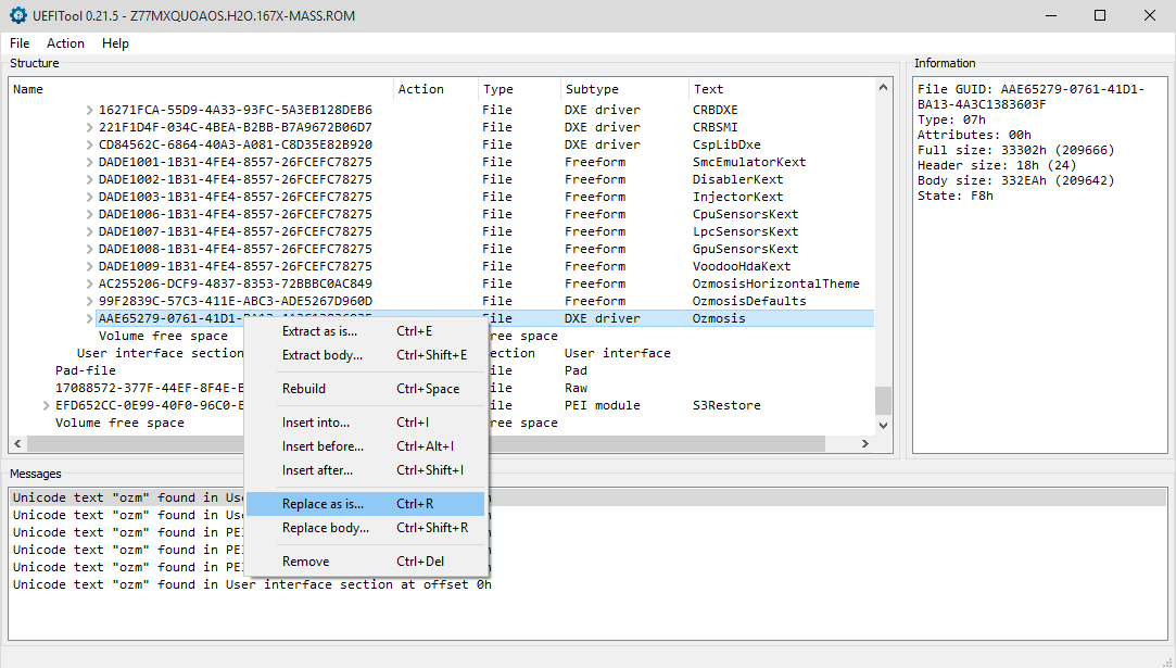

cecekpawon Posted June 20, 2016 Share Posted June 20, 2016 After do some more tests with permissions, I decide to republish this patched ver ov Oz (1.03.167X-MASS RELEASE) which allowed me to boot with injected kexts (from rom / efi folder like usual) into 10.11 installer & 10.12 installed. Please use with caution until new official ver released. __LINK__ 7 Link to comment Share on other sites More sharing options...

cecekpawon Posted June 23, 2016 Share Posted June 23, 2016 @THe KiNG I port kext2ffs to batch script to working under Windows here 1 Link to comment Share on other sites More sharing options...
xrnc Posted June 24, 2016 Share Posted June 24, 2016 In following the guide in the OP of this thread in an attempt to create a bios for an Asus H97M-E/CSM I run into a consistent 2k oversize. It seems that people generating custom bios for folks on the german hackintosh-forum.de site are running into the same thing, the one I downloaded for this board from crusher there is showing the same issue. The factory bios is 8192 kb, after putting everything into MMTool per the guide here, deleting FileSystem and compressing CORE_DXE, MMTool spits out a bios file that is 8194kb. I have a AFUDOS capable of flashing the board with /GAN, just can't generate a properly sized bios. Am I missing something obvious? Here's the link to the current factory bios... http://dlcdnet.asus.com/pub/ASUS/mb/LGA1150/H97M-E/H97M-E-ASUS-2702.zip Not sure if it helps, but I took the original and the one generated by crusher, also assumingly with MMTool since it came out the same size as mine, and diff'd them, but don't know what I might be looking for... http://pastebin.com/RKQYyLfy Link to comment Share on other sites More sharing options...
