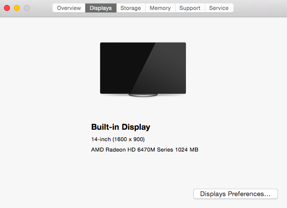

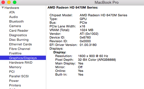

I can't believe it, but after nearly six weeks of working to get this Elitebook 8460p with AMD 6470m GPU to display thru the Laptop LCD (LVDS) I've finally got it working. <whew>
This morning I decided that I had changed too many things on the existing installation and that a fresh start would probably be best.  I didn't want to throw away the work I had, though, so I dug out an old 80GB laptop drive I had and swapped it out for the 320GB drive that comes with the Elitebook.  From there, I followed the standard process to wipe the disk and install Yosemite from the USB drive I created months ago.
After installing Yosemite, I ran the ProBook Installer as I had done dozens of times before, selecting the Business model (Elitebook 8460p with AMD) from the lists. That process went as it always had--normal.  After completing PBI, I restarted with little expectations for anything different to occur.  And nothing different occurred.  Booted to a blank, black screen. Same problem I've been fighting for 6 weeks.
This time, though, after considering the advice of both Slice and Vusun123, I decided I would remove the DSDT and SSDT files that PBI created to see if anything different occurred.  I also edited the config.plist and changed the Connector Patch from 05 to 01 to match what I knew was correct for my FrameBuffer.  I saved the edited config.plist and rebooted with little hope of getting any good results.
Amazingly, the laptop screen worked after the reboot!
I've attached screenshots below to document my efforts and success.  Frankly, I'm still puzzled as to why it worked this time and not all the times before.

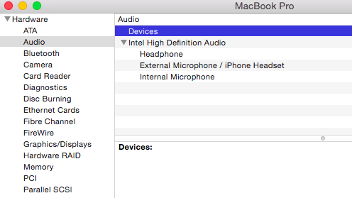

The one problem that I have encountered is that I no longer have working Audio or Battery.  The battery I can live without, but working Audio is a necessity.  If anyone has any suggestion about how to get Audio working, I'd be grateful for the help.
Thanks again to Slice & Vusun123 for their time, patience and helpful suggestions!

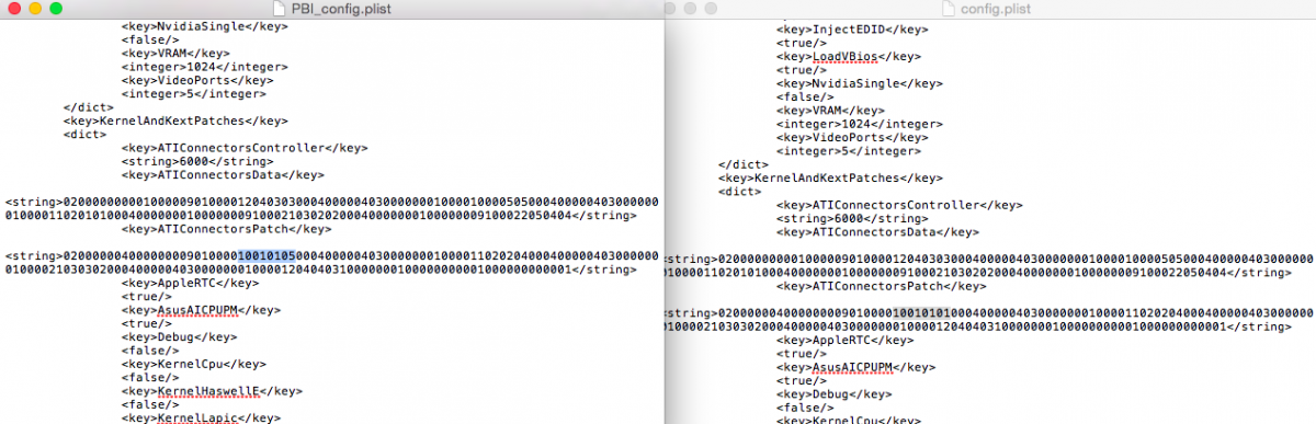

PS:  I did try re-enabling the PBI-created DSDT and SSDT files after getting my screen to work. When they were enabled, the screen did not work, so I disabled them again.
VoodooHDA + AppleHDADisabler is the easiest way to get a sound. Note, good sound!
Battery absent because of wrong DSDT.
I don't know what is the reason of my DSDT causes a crash but you may also try Clover's FixDSDT.
Thanks Slice.
I got sound working with VoodooHDA
I'll work on the Battery display via DSDT edits.
My laptop is 8460P, too.I fix audio and battery by this .
http://www.tonymacx86.com/threads/guide-hp-probook-elitebook-zbook-using-clover-uefi-hotpatch-10-11.189416/
Would you like share your config.plist and ATI6000Controller.kext to me.
Use Probook Installer Clover Edition, it has the patch for your laptop, but I doubt it will work right away as there are EDID problems that needs to be taken care of. Also in recent version of OS X I saw that no matter how you edit your config,plist, OS X will always use RadeonFramebuffer instead of the framebuffer you choose. Maybe DSDT edit is required
