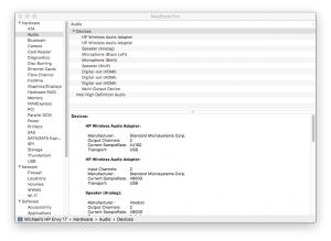

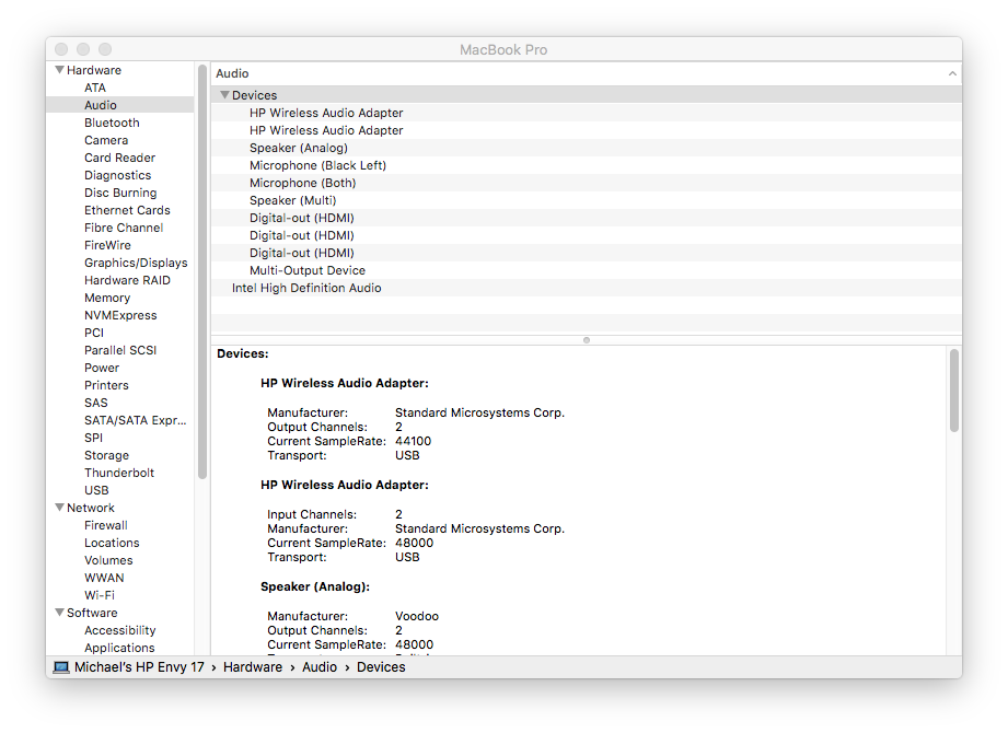

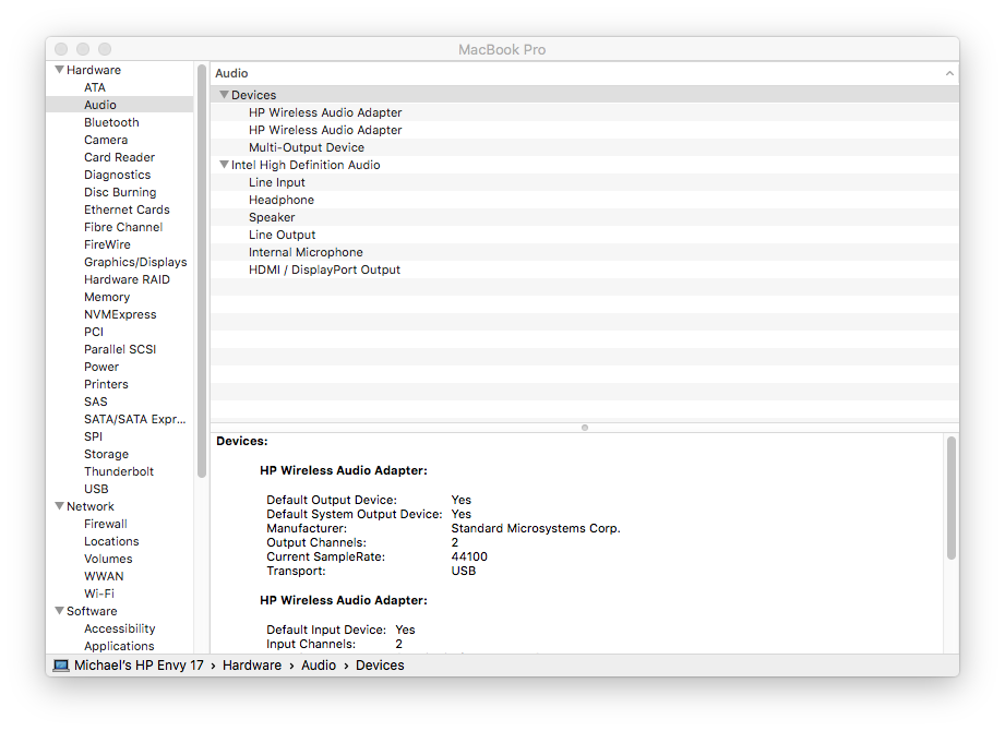

mnfesq Posted March 28, 2016 Share Posted March 28, 2016 I am not having any luck getting AppleHDA to work with my HP Envy. I even tried Rehabman's newest kext for 10.11.4. The AppleHDA patcher creates a patched kext which gives me the most entries for Intel High Definition Audio but I get no entries under Devices. The one thing that seems to be different about my HP Envy is that I have the HP Wireless Audio Adapter, which is a USB audio device. It's actually a chip (similar to a wifi/BT combo card) that fits in its own slot on the motherboard and has its own antennae. With the VoodooHDA kext, I get these devices (of which the Digital-out (HDMI)) do not work. With AppleHDA, it get this: Any ideas about why I get no audio devices and, hence, no audio using AppleHDA? P.S. - The multi-output device is actually an aggregate of multiple devices which work with VoodooHDA (allowing all 6 of my Beats Audio speakers to work). That device shows up with AppleHDA but there are no actual devices contained within it so it can be ignored. Link to comment Share on other sites More sharing options...

mnfesq Posted April 7, 2016 Share Posted April 7, 2016 That's a shame. Not having HDMI support is a deal breaker for me, especially since I use it so much on my laptops. So I got HDMI audio support for the VoodooHDA.kext. It turns out that it required 2 Clover kext patches of AppleIntelFramebufferCapri.kext. They can be located here: https://github.com/toleda/audio_CloverHDMI I used the config.plist patches for the HD4000. You would use it for the HD4600 or whatever GPU your new laptop uses. It was nice to put the analog audio cord in a drawer and have one less cord between my Zotac ID83 and my bedroom TV. P.S. - Three different HDMI outputs show up for me. The top one was the one that worked. Also, I had to go into Audio Midi Setup and change the format to 96000 MHz and 8-channel 16-bit integer. 1 Link to comment Share on other sites More sharing options...

Micky1979 Posted May 21, 2016 Share Posted May 21, 2016 Here the audio work really well just using your kext (same exactly codec branded by HP, same chassy..same Beats speakers). In 10.11.4+ just need a face-lifting:IDT92HD91BXXInject.kext.zip (do not use in older OS versions) Ensure you already have that in your config:config.plist.zip... (I don't need any other fix) 1 Link to comment Share on other sites More sharing options...
