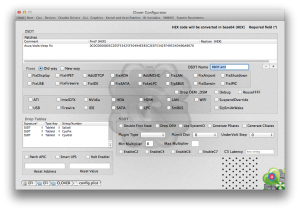

The sleep fix linked above is the fix for the reboot after sleep problem.  The Clover/dsdt patch for sleep is noted below.  For Haswell Power Management,  I use the ssdt generated for my CPU with Pike's script: Piker-Alpha/ssdtPRGen.sh.  The only Clover/PM settings are the 2 CPU Drop Tables as shown below.

config.plist - sleep and PM
	<key>ACPI</key>
	<dict>
		<key>DSDT</key>
		<dict>
			<key>Patches</key>
			<array>
				<dict>
					<key>Comment</key>
					<string>Asus/dsdt/sleep fix </string>
					<key>Find</key>
					<data>
					DAwAAIBcLl9TQl9QSU5YXC5fU0JfSVNNSQqQcA==
					</data>
					<key>Replace</key>
					<data>
					</data>
				</dict>
			</array>
		</dict>
		<key>DropTables</key>
		<array>
			<dict>
				<key>Signature</key>
				<string>SSDT</string>
				<key>TableId</key>
				<string>CpuPm</string>
			</dict>
			<dict>
				<key>TableId</key>
				<string>Cpu0Ist</string>
			</dict>
		</array>
	</dict>
Thanks, Toleda. That seems to have done the trick even with the 1003 BIOS. I'm not certain if it's the table dropping or the "on-the-fly" patching that remove of the two lines as indicated in the reference in my original post. I didn't explicitly use Pike's script in this case but, instead, use the SSDT generated bundled with MacIASL. Presumably, it does the same thing.
