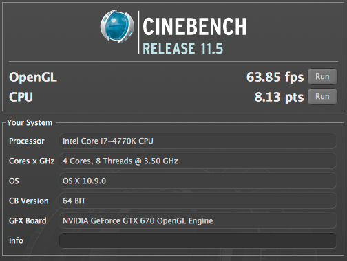

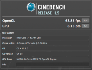

gaspimp Posted June 18, 2013 Share Posted June 18, 2013 Gaspimp, it's not related to your question, but could you please upload a Geekbench score of your machine, for us to see how does it fare performance-wise? Geekbench score (17520): http://browser.primatelabs.com/geekbench2/2062394 Cinebench score: Link to comment Share on other sites More sharing options...
