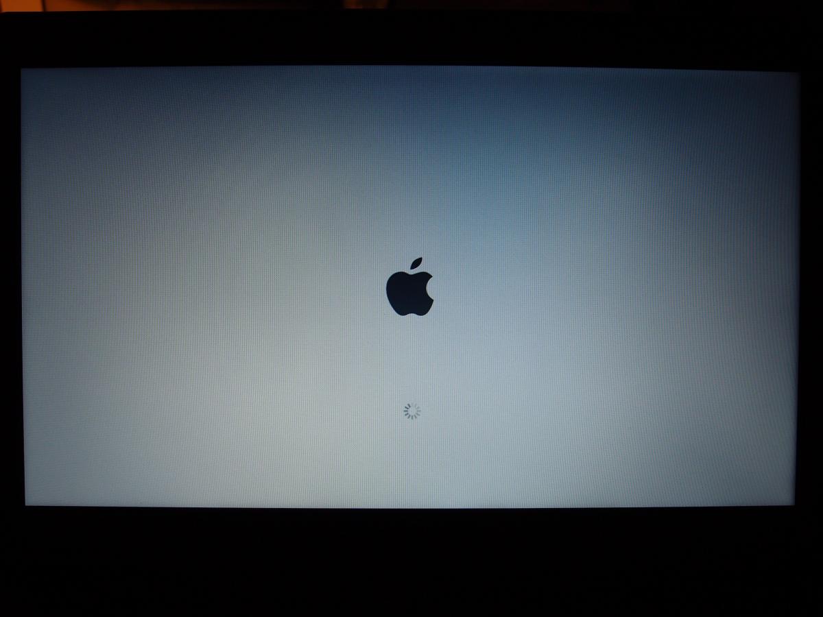

pentothal Posted March 15, 2013 Share Posted March 15, 2013 The first screenshot is telling me that the framebuffer did not load. I use to get that screen when only AppleIntelHDGraphics.kext was loading. The second, have you tried the alternative framebuffer in my zip file? What I want to know is if the framebuffer detects your display. For example in mine, it does. If it does detect your display, something is weird. Ok GhostRaider, thanks for your help. I did some more tests on a vanilla 10.8.2 OSX installation. I tried both your FB and I get the same screen with the spinning wheel never stopping. I add a pic to this post. I was able to get to the desktop without any Intel HD kext loaded. In a previous post I posted a pic about a distorted screen. I used the FB (not the alternate) in your .zip file with the DualLink FB from Verteks "fixed" ML FB. You think the FB was loaded in that test? How can I know if the FB detects my display? I think the problem might be the fact that my laptop monitor's EDID is not picked up by osx. Not even in Windows 7 nor in Linux Mint I was able to get the EDID. Only in windows I was getting it from the registry and not from the monitor itself. Below you can see the output of the get-edid from Linux: sudo get-edid | parse-edid parse-edid: parse-edid version 2.0.0 get-edid: get-edid version 2.0.0 Performing real mode VBE call Interrupt 0x10 ax=0x4f00 bx=0x0 cx=0x0 Function supported Call successful VBE version 300 VBE string at 0x11100 "Intel®Ironlake Mobile Graphics Chipset Accelerated VGA BIOS" VBE/DDC service about to be called Report DDC capabilities Performing real mode VBE call Interrupt 0x10 ax=0x4f15 bx=0x0 cx=0x0 Function supported Call successful Monitor and video card combination does not support DDC1 transfers Monitor and video card combination supports DDC2 transfers 0 seconds per 128 byte EDID block transfer Screen is not blanked during DDC transfer Reading next EDID block VBE/DDC service about to be called Read EDID Performing real mode VBE call Interrupt 0x10 ax=0x4f15 bx=0x1 cx=0x0 Function supported Call failed The EDID data should not be trusted as the VBE call failed parse-edid: EDID checksum passed. # EDID version 0 revision 0 Section "Monitor" # Block type: 2:0 3:0 # Block type: 2:0 3:0 # Block type: 2:0 3:0 # Block type: 2:0 3:0 Identifier "@@@:0000" VendorName "@@@" ModelName "@@@:0000" # Block type: 2:0 3:0 # Block type: 2:0 3:0 # Block type: 2:0 3:0 # Block type: 2:0 3:0 # DPMS capabilities: Active off:no Suspend:no Standby:no # Block type: 2:0 3:0 # Block type: 2:0 3:0 # Block type: 2:0 3:0 # Block type: 2:0 3:0 EndSection Could that be the reason why I cannot get the FB loaded? Link to comment Share on other sites More sharing options...

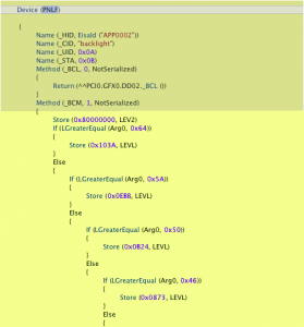

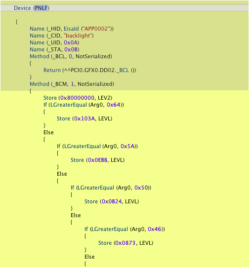

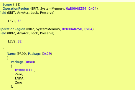

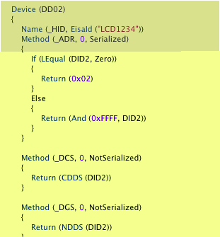

calmesal Posted March 15, 2013 Share Posted March 15, 2013 OK so I forgot to mention one thing . In your IGPU, you need to go to Device DD02. Before the line " Method (_ADR, 0, Serialized)", you will need to add the line " Name (_HID, EisaId ("LCD1234"))". Can you confirm you installed the latest Generic Brightness kext? I also noticed you already have two PNLF devices in your DSDT. You will probably need to remove the old one, its in a different place. Also try putting my OperationRegions before your line " OperationRegion (PNVS, SystemMemory, 0xDB79BDA4, 0x0100)".. let me know how it worked! I have exact the same problem. Cant find the entry you pointed. Appreciate your help. ioreg.ioreg.zip DSDT.aml.zip Link to comment Share on other sites More sharing options...
mnorthern Posted March 15, 2013 Share Posted March 15, 2013 I have exact the same problem. Cant find the entry you pointed. Appreciate your help. Hey calmesal. To find your graphics module, search for "Scope (_SB.PCI0.GFX0)". There you will find Device DD02. You need to name it LCD1234 as per my instructions. Put my OperationRegions before the first occurence of your "Scope (_SB)" and then find your Device (PNLF) {....}, delete it and replace with mine. Let me know if it worked. (If you can't compile, try replacing whenever my code says "PCI0.GFX0" try and change that to "_SB.PCI0.GFX0") Link to comment Share on other sites More sharing options...

giofrida Posted March 15, 2013 Share Posted March 15, 2013 Hi giofrida, can I have a look at your dsdt? Also, would you be able to download RW-Everything on Windows, then go into PCI window, select your Intel Graphics from the drop down, and send me a screenshot of what it shows? Also, when you go into Displays preference pane, what does it look like? Also, I have edited my original instructions on the previous page for more clarity. EDIT: $h!t, I made a mistake Too many KEXTs loaded on my system and it looks like a mess. Do not install Generic Brightness, if you have it delete it. My DSDT patches will work if you install the following driver made by hotKoffy from our forum (http://www.insanelym...cklight-driver/) but I made slight changes to the plist, so download the one I attached and give it a go. I'll try it, thanks. @verteks: this is the 10.8.3 framebuffer, please patch it. AppleIntelHDGraphicsFB_10.8.3.zip Link to comment Share on other sites More sharing options...

calmesal Posted March 15, 2013 Share Posted March 15, 2013 Hey calmesal. To find your graphics module, search for "Scope (_SB.PCI0.GFX0)". There you will find Device DD02. You need to name it LCD1234 as per my instructions. Put my OperationRegions before the first occurence of your "Scope (_SB)" and then find your Device (PNLF) {....}, delete it and replace with mine. Let me know if it worked. (If you can't compile, try replacing whenever my code says "PCI0.GFX0" try and change that to "_SB.PCI0.GFX0") Hi again! The first and second part was no problem, but the PNLF part is no go. If I delete and copy your code I get compilation error. And I dont anderstand what you mean by(If you can't compile, try replacing whenever my code says "PCI0.GFX0" try and change that to "_SB.PCI0.GFX0") I will be thankful if you could do this on my DSDT. Thanks Link to comment Share on other sites More sharing options...

mnorthern Posted March 15, 2013 Share Posted March 15, 2013 @mnorthern, can I get BAR0/BAR1 using DarwinDump? I've never used DarwinDump unfortunately... but I edited my original post, and provided instructions how to use Windows and RW-everything.. its the easiest way! Hi again! The first and second part was no problem, but the PNLF part is no go. If I delete and copy your code I get compilation error. And I dont anderstand what you mean by(If you can't compile, try replacing whenever my code says "PCI0.GFX0" try and change that to "_SB.PCI0.GFX0") I will be thankful if you could do this on my DSDT. Thanks I'll try to patch your DSDT tonight and send it to you for testing ! Link to comment Share on other sites More sharing options...
