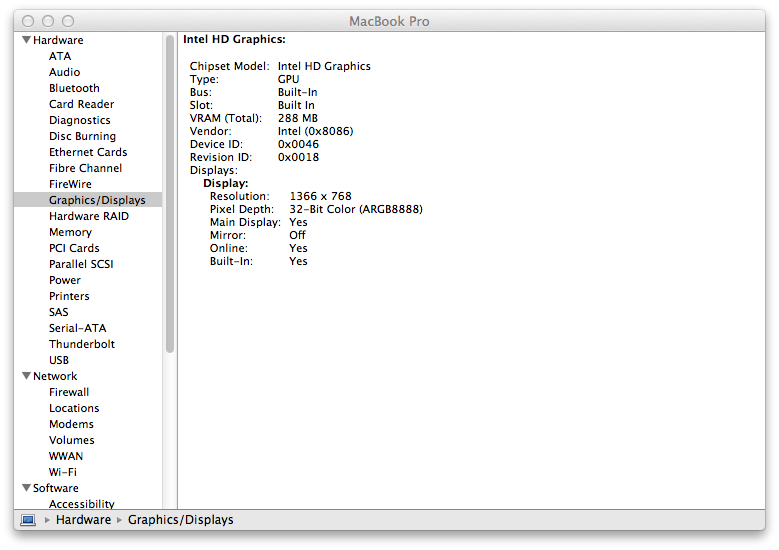

white_eagle Posted March 11, 2013 Share Posted March 11, 2013 Hi, I installed all the verteks' kexts and I got full resolution but sadly cannot boot without -x flag (safe mode) because there are kernel panics after chameleon finishes loading. This is what I get in system report: Please tell me what do I need to post here for you to tell me what I did wrong so I'd be able to fix it. Thanks and keep up the brilliant work! Link to comment Share on other sites More sharing options...
pentothal Posted March 11, 2013 Share Posted March 11, 2013 @ verteks: I removed the AppleIntelHDGraphics.kext and booted with the frame buffer. I got the spinning wheel and after a while it stopped. I would like to start testing from scratch tomorrow and I have some questions for you. 1) Which smbios should I try. 6.1, 6.2? Any other suggestion 2) Graphics Enabler in Chameleon yes or no? 3) Graphics Mode 1366x768x32 or not set? 4) Natit yes or no? 5) Resolution module? 6) Wich Intelhd kext to use? Sorry for so many question but I think we are so close to the solution I cannot wait. Thanks in advance Pentothal Link to comment Share on other sites More sharing options...
white_eagle Posted March 11, 2013 Share Posted March 11, 2013 I managed to boot without safe mode by removing all the graphics kexts, rebuilding the cadche, rebooting, and only after installing ONLY the Natit and AppleIntelHDGraphicsFB kexts I managed to log in successfully with a full 1366x768x32 resolution as per the suggestion in the quote below. My card is properly identified in the system information when I do this. Afterwards I tried installing the other Intel HD drivers but sadly according to intel_reg_dumper on Linux my laptop monitor is also connected through eDP (pastebin of said dump) and I get a black screen if I put them there. Since this means I absolutely cannot get QE does it mean I can't also get at least CI support somehow? I would love it if a fix came for our problem, this way my hackintosh is not in any way useable for normal day to day stuff. Or maybe I am doing something else wrong? I'm not really sure if I'm using a custom Resolution.dylib (from the other thread about Intel HD graphics) or if I restored the original because I don't want to break my system. I think I am going to attempt that next time. Thanks! What I suggest is delete all the Intel HD Graphics in the Extensions folder. Use kext utility to rebuild the cache. After that go to this post and download the kext.zip attachement http://www.insanelym...20#entry1895588 Drag the Natit and AppleIntelHDGraphicsFB kexts to Kext Utility and it will install them. Reboot. *Just make sure your DSDT does not have any reference to Intel HD Graphics. Check the GFX0 (or named as VID) section and make sure there is no DSM method. It should just work. Check your Display Preferences and it should show extra resolutions. And then later install the other Intel HD Graphics kexts and see what you get.. About the red bit: I am a bit of a noob in this. I don't think I used a DSDT or had anything to do with such a file, can you tell me where can I check for said file and what to do if there IS a reference to Intel HD Graphics after I remove all kexts? Link to comment Share on other sites More sharing options...

voidRunner Posted March 11, 2013 Share Posted March 11, 2013 Hi white_eagle, I seem to have the same problem as you but i tried you method and still got a black screen. Are you using the resolution module? Are you sure the kext loaded? Correct System Information is from Natit. Best regards, voidRunner Link to comment Share on other sites More sharing options...
white_eagle Posted March 11, 2013 Share Posted March 11, 2013 Hi white_eagle, I seem to have the same problem as you but i tried you method and still got a black screen. Are you using the resolution module? Are you sure the kext loaded? Correct System Information is from Natit. Best regards, voidRunner I think you may have misunderstood me, I get black screen only when I attempt to load the system with the original AppleIntelHDGraphics.kext or the modified MLDPAppleIntelHDGraphics.kext. If I don't use them at all I can boot it without a problem. The black screen we get must be because of the eDP connection we all unluckily share and sadly there doesn't appear to be a fix. I am in fact using the Resolution.dylib module from this post as I was unable to compile my own (see the last post of mine in that thread) in conjunction with only the 2 kexts (natit and AppleIntelHDGraphicsFB single link). I think I will try a completely fresh new install and do everything step-by-step once more just to be sure. I am not sure how I would be able to check if the kext loaded, but I think it does because when I remove the FB kext I lose the 1366x768x32 resolution and the system info does specify the Intel HD Graphics as it should but also says kext not loaded. I will post screenshots from how they differ tomorrow when I'll be able to log in from the hackintosh. ps. I also put my system specs in my signature for future reference. Link to comment Share on other sites More sharing options...

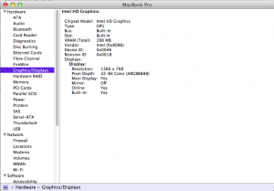

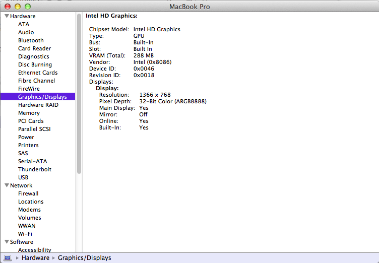

white_eagle Posted March 12, 2013 Share Posted March 12, 2013 If anyone's interested, here's how my graphics card is detected in SL 10.8.2 (sys specs in my sig) with the FB and natit kexts (without the standard AppleIntelHDGraphics kext): finally i loaded fb kext! i had to turn on nvidia optimus gpu (it was turned off by dsdt) and to delete appleintelhdgraphics.kext. 2 problems remain: black screen after wake and fan shouting! intel hd graphics 1st gen + nvidia g310m Do you have QE/CI support? Link to comment Share on other sites More sharing options...

trik82 Posted March 12, 2013 Share Posted March 12, 2013 If anyone's interested, here's how my graphics card is detected in SL 10.8.2 (sys specs in my sig) with the FB and natit kexts (without the standard AppleIntelHDGraphics kext): Do you have QE/CI support? i have CI (i can see screensavers' previews) but not QE... but there's something strange. when i use vlc i can see nothing, i think something is going bad with overlays. if i choose YUV video output it stops hanging for lack of quart extreme acceleration.. Link to comment Share on other sites More sharing options...
white_eagle Posted March 12, 2013 Share Posted March 12, 2013 I tried that. I got the usual grey screen. Ciao Pentothal Are you using the custom Resolution.dylib from the other thread? It may help into booting with a higher resolution, but I can't promise QE/CI. i have CI (i can see screensavers' previews) but not QE... but there's something strange. when i use vlc i can see nothing, i think something is going bad with overlays. if i choose YUV video output it stops hanging for lack of quart extreme acceleration.. Which exact kexts do you have installed and are you using a modified Resolution.dylib? Also what's your configuration? Thanks Link to comment Share on other sites More sharing options...
