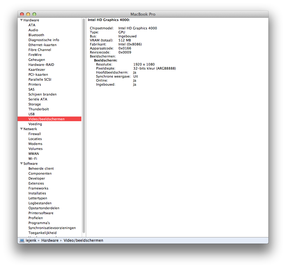

WaldMeister Posted February 19, 2013 Share Posted February 19, 2013 Has no use for me, only the disable GPU function, forgot to add the PINI function, solved my question why it would not work. So thanks again for that Sorry for hijacking, if you have some time, could you look at my DSDT Tonio, the GPU still show up somehow :/ If not, it's ok, have a topic open on the issue DSDT.aml.zip 1 Link to comment Share on other sites More sharing options...
Tonio1987 Posted February 19, 2013 Share Posted February 19, 2013 Method (_INI, 0, NotSerialized) { PINI () Store (0x07D0, OSYS) If (CondRefOf (\_OSI, Local0)) { If (_OSI ("Windows 2001")) { Store (0x07D1, OSYS) } If (_OSI ("Windows 2001 SP1")) { Store (0x07D1, OSYS) } If (_OSI ("Windows 2001 SP2")) { Store (0x07D2, OSYS) } If (_OSI ("Windows 2001.1")) { Store (0x07D3, OSYS) } If (_OSI ("Windows 2006")) { Store (0x07D6, OSYS) } If (_OSI ("Windows 2009")) { Store (0x07D9, OSYS) } } } DSDT_Lejenk.aml.zip I'm going to say it now works in my post for this issues 2 Link to comment Share on other sites More sharing options...
WaldMeister Posted February 19, 2013 Share Posted February 19, 2013 You sir, are awesome, i thank you very much. 1 Link to comment Share on other sites More sharing options...
