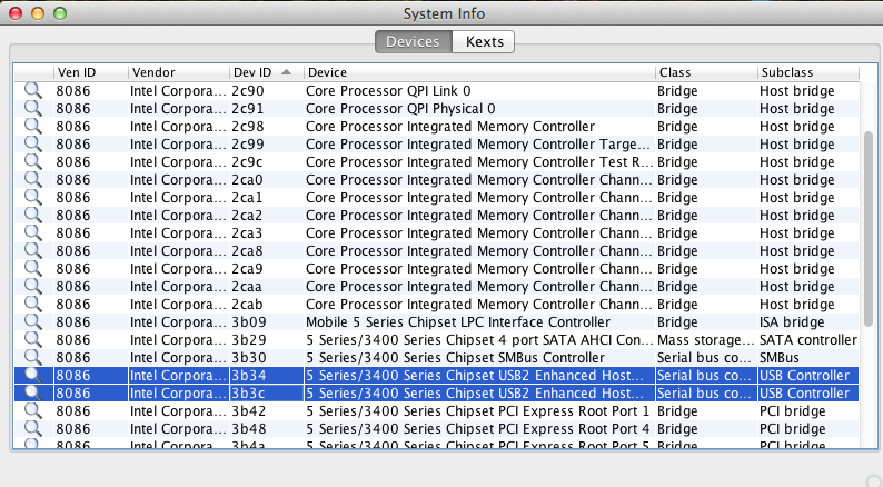

Also tried to remove vendor-id and add this
"AAPL,max-port-current-in-sleep",
												 0x0834,
												 Buffer (One)
														 0x00
I don't see any difference at IORegs between USBFix and without one which was injected by XPC or Chameleon
Help me, please.
	 Device (EHC1)
		 Name (_ADR, 0x001D0000)
		 OperationRegion (U1CS, PCI_Config, 0x62, 0x04)
		 Field (U1CS, DWordAcc, NoLock, Preserve)
				 , 1,
			 E1EN, 8
			 Store (Package (0x12)
					 "vendor-id",
					 Buffer (0x04)
						 0x86, 0x80, 0x00, 0x00
					 "device-id",
					 Buffer (0x04)
						 0x34, 0x3B, 0x00, 0x00
					 "built-in",
					 Buffer (One)
						 0x00
					 "AAPL,clock-id",
					 Buffer (One)
						 0x01
					 "device_type",
					 Buffer (0x05)
						 "EHCI"
					 "AAPL,current-available",
					 0x05DC,
					 "AAPL,current-extra",
					 0x03E8,
					 "AAPL,current-extra-in-sleep",
					 0x05DC,
					 "AAPL,device-internal",
					 0x02
				 }, Local0)
			 Return (Local0)
		 Method (_S3D, 0, NotSerialized)
			 Return (0x02)
		 Method (_S4D, 0, NotSerialized)
			 Return (0x02)
Device (EHC2)
		 Name (_ADR, 0x001A0000)
				 , 1,
			 E2EN, 6
					 "vendor-id",
					 Buffer (0x04)
					 "device-id",
					 Buffer (0x04)
						 0x3C, 0x3B, 0x00, 0x00
					 "built-in",
					 Buffer (One)
						 0x00
					 "AAPL,clock-id",
					 Buffer (One)
						 0x02
					 "device_type",
					 Buffer (0x05)
						 "EHCI"
					 0x05DC,
					 0x03E8,
					 0x05DC,
					 0x02
				 }, Local0)
			 Return (Local0)
			 Return (0x02)
			 Return (0x02)

I can't see much thing, but if I'm right, it's basically resets some addresses. From the code, I think you'll need to do something in the EHCI(ehc1,ehc2) section of the DSDT... but don't know what should you do... :S
I've cleared up that USBBusFix=Yes is better than USBLegacyOFF=yes.
Because with legacyoffer I have inoperative keyboard which begin to work only after slumber.
Phew! I'm so weary with searching DSDT-Fix for USB that have decided to spit on this affair.
Because such bootloaders as Chameleon and XPC does it better rather than my homemade DSDT Fix.
