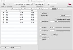

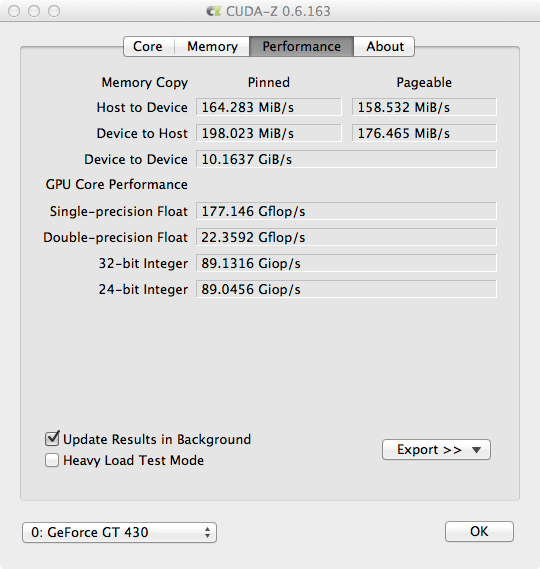

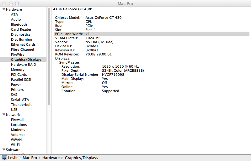

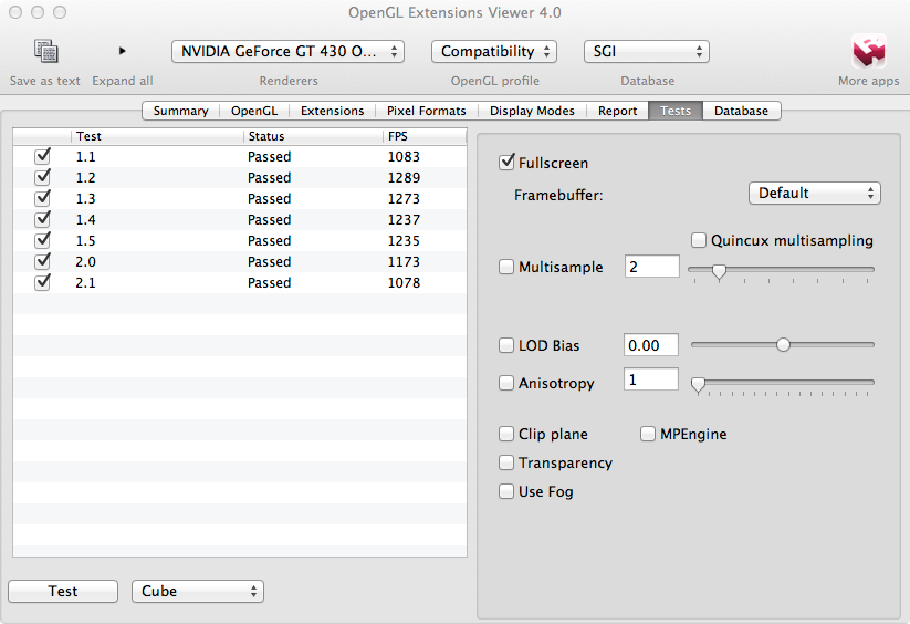

RobertX Posted February 4, 2013 Share Posted February 4, 2013 ...well, trying out this card, but in 10.8.2 and in windows8 the card (pci-e x16) appears to be running at x1 any ideas why? or if it is in fact running at x16, my WEI scores in win8 went way up, and openglviewer on the mac side scores more than doubled...here's a shot from cuda=z performance tab as well Link to comment Share on other sites More sharing options...
iFIRE Posted February 4, 2013 Share Posted February 4, 2013 this is only cosmetic problem: the card (pci-e x16) appears to be running at x1 performance see this: AppleGraphicsPowerManagement (AGPM) for nVidia Link to comment Share on other sites More sharing options...
RobertX Posted February 4, 2013 Author Share Posted February 4, 2013 ...hmm, on windows8 now, still shows only pci-e x16 @ x1 ...can it be just cosmetic if both operating systems show the same x1 lane width? With the GT 520 installed, gpu-z shows x16 @ x16 but with GT 430 only x1 in windows8 but any benchmarks i've tried on the windows side show 3 times the scores i receive in osx 10.8.2...what gives? edit: back on 10.8.2 ...openglextensionviewer now matches my scores from windows 8 very odd Link to comment Share on other sites More sharing options...

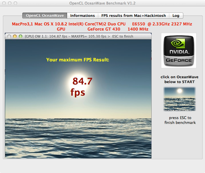

RobertX Posted February 4, 2013 Author Share Posted February 4, 2013 sooo... here's my results from OpenCL_OceanWave ...this is almost double my score(from results using GT520) Would this be possible from a GT430 running at pci-e x1 speed? Link to comment Share on other sites More sharing options...
Gringo Vermelho Posted February 4, 2013 Share Posted February 4, 2013 I don't know how to do the maths. Your result is on par with the existing GT 430 score on mitch_de's OceanWave post. Link to comment Share on other sites More sharing options...

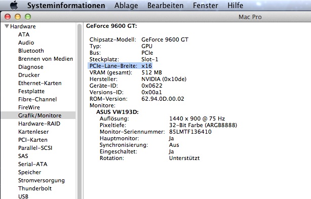

mitch_de Posted February 7, 2013 Share Posted February 7, 2013 You could also compare Bandwidth speed values : Host(=CPU/Bus)> device(=GPU) and Device > Host is usefull for PCIe Speed, device>device is VRAM speed PS: My 9600 GT is shown in Systemprofiler as x16 Lane card. So i don't think the x1 Lane is only cosmetic! Here my old 9600 GT oclBandwidthTest values: oclBandwidthTest] starting... /Developer/GPU Computing/OpenCL/bin/darwin/release/oclBandwidthTest Starting... Running on... GeForce 9600 GT Quick Mode Host to Device Bandwidth, 1 Device(s), Paged memory, direct access Transfer Size (Bytes) Bandwidth(MB/s) 33554432 2380.2 Device to Host Bandwidth, 1 Device(s), Paged memory, direct access Transfer Size (Bytes) Bandwidth(MB/s) 33554432 1763.1 Device to Device Bandwidth, 1 Device(s) Transfer Size (Bytes) Bandwidth(MB/s) 33554432 26650.5 [oclBandwidthTest] test results... PASSED > exiting in 3 seconds: 3...2...1...done! And bandwidthTest_CUDA ( CUDA code based bandwidth tests) /Users/andreasm/Desktop/bandwidthTest_CUDA ; exit; [bandwidthTest_CUDA] starting... /Users/andreasm/Desktop/bandwidthTest_CUDA Starting... Running on... Device 0: GeForce 9600 GT Quick Mode Host to Device Bandwidth, 1 Device(s), Paged memory Transfer Size (Bytes) Bandwidth(MB/s) 33554432 1986.6 Device to Host Bandwidth, 1 Device(s), Paged memory Transfer Size (Bytes) Bandwidth(MB/s) 33554432 1479.6 Device to Device Bandwidth, 1 Device(s) Transfer Size (Bytes) Bandwidth(MB/s) 33554432 35298.9 [bandwidthTest_CUDA] test results... PASSED > exiting in 3 seconds: 3...2...1...done! oclBandwidthTest.zip bandwidthTest_CUDA.zip Link to comment Share on other sites More sharing options...

RobertX Posted February 8, 2013 Author Share Posted February 8, 2013 Leslies-Mac-Pro:~ leslie$ /Users/leslie/Downloads/bandwidthTest_CUDA ; exit; dyld: Library not loaded: @rpath/libcudart.dylib Referenced from: /Users/leslie/Downloads/bandwidthTest_CUDA Reason: image not found Trace/BPT trap: 5 logout ...also this from the other Cuda test.... an aside...my cuda performance scores from cuda-z match exactly the scores from opencl bandwidth test....normal? Link to comment Share on other sites More sharing options...
mitch_de Posted February 8, 2013 Share Posted February 8, 2013 CUDA-Z and OpenCLbandwidth values normally vary light. But if you meaned that if both are very low it means something is wrong. dyld: Library not loaded: @rpath/libcudart.dylib Referenced from: /Users/leslie/Downloads/bandwidthTest_CUDA This required lib ( for my CUDA bandwidh test) normally got installed by CUDA install. Located : /usr/local/cuda/lib/libcudart.dylib I attacht it for you, put it beside (same folder) of bandwidthTest_CUDA and run again. libcudart.dylib.zip Link to comment Share on other sites More sharing options...

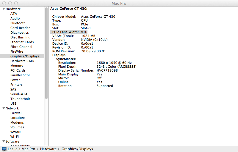

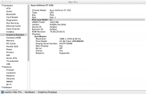

RobertX Posted February 11, 2013 Author Share Posted February 11, 2013 ...well.i decided one more attempt...after measuring my card and enclosure for clearances, i found the card's heatsink/fan block was touching on a neighbouring resistor cap(preventing full card contact)...i removed the heatsink block and adjusted it up as far as i could(of couse reapplied thermal paste)...re-inserted into pci-e x16 slot and am now reporting x16 link width... ...all seems well, continueing to test...thanks to you few who responded ...and from Mitch's other test Last login: Sun Feb 10 21:25:37 on console Leslies-Mac-Pro:~ leslie$ /Users/leslie/Downloads/oclBandwidthTest ; exit; [oclBandwidthTest] starting... /Users/leslie/Downloads/oclBandwidthTest Starting... Running on... GeForce GT 430 Quick Mode Host to Device Bandwidth, 1 Device(s), Paged memory, direct access Transfer Size (Bytes) Bandwidth(MB/s) 33554432 2421.5 Device to Host Bandwidth, 1 Device(s), Paged memory, direct access Transfer Size (Bytes) Bandwidth(MB/s) 33554432 1831.8 Device to Device Bandwidth, 1 Device(s) Transfer Size (Bytes) Bandwidth(MB/s) 33554432 18300.2 [oclBandwidthTest] test results... PASSED > exiting in 3 seconds: 3...2...1...done! logout [Process completed] device to device now appears nominal(for this card at least) ...this topic could be marked as solved...and left as a reminder, :wink2: or deleted. 1 Link to comment Share on other sites More sharing options...
mitch_de Posted February 11, 2013 Share Posted February 11, 2013 YES that values(hsot>dev , dev>host) >> 1 Gb/sec i wanted to see with x16lane! You see: x1 Lane entry (and low 150 MB/sec!) in Systemprofiler WASN´T only cosmetic - there was a real problem. 1 Link to comment Share on other sites More sharing options...
