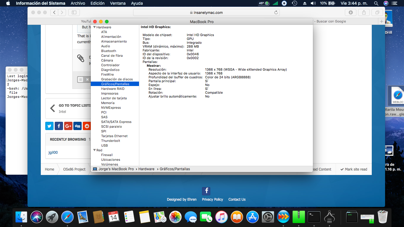

jgil00 Posted September 14, 2018 Share Posted September 14, 2018 (edited) 7 hours ago, Hervé said: Pre-patched kexts are only available for ML 10.8.5 at a minimum. Same applies to the patcher afaik: supports starts at 10.8.5. See p1. But have a look here for SL. That is if there is hope for snow leopard, full QE / CI, Toshiba L500-sp6018m, i3 330M, Linkwidht 1 LVDS, I currently have High Sierra but I need to experiment, I really want to use Intel HD in Snow Leopard, Thanks , Thanks , Thanks. can extract FB of Snow leopard iatkos s3 v2 and patch Giofrida old version Edited September 14, 2018 by jgil00 1 Link to comment Share on other sites More sharing options...

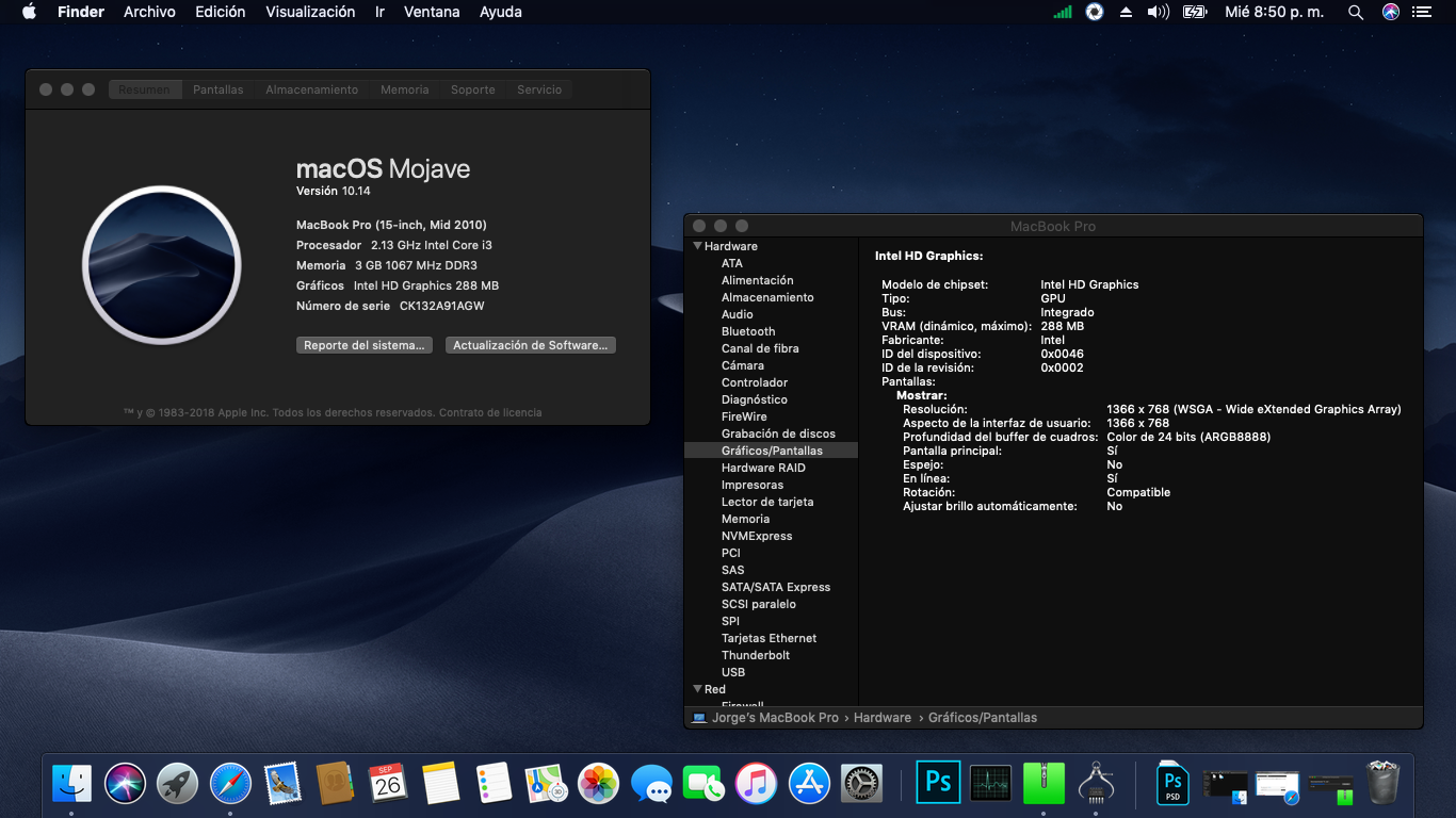

jgil00 Posted September 27, 2018 Share Posted September 27, 2018 Hello, I was wondering if with future updates I will have to install my kext again, Mojave works well with 3GB of ram even with apps like photoshop, it will be the last macOS in which this chip works 2 Link to comment Share on other sites More sharing options...

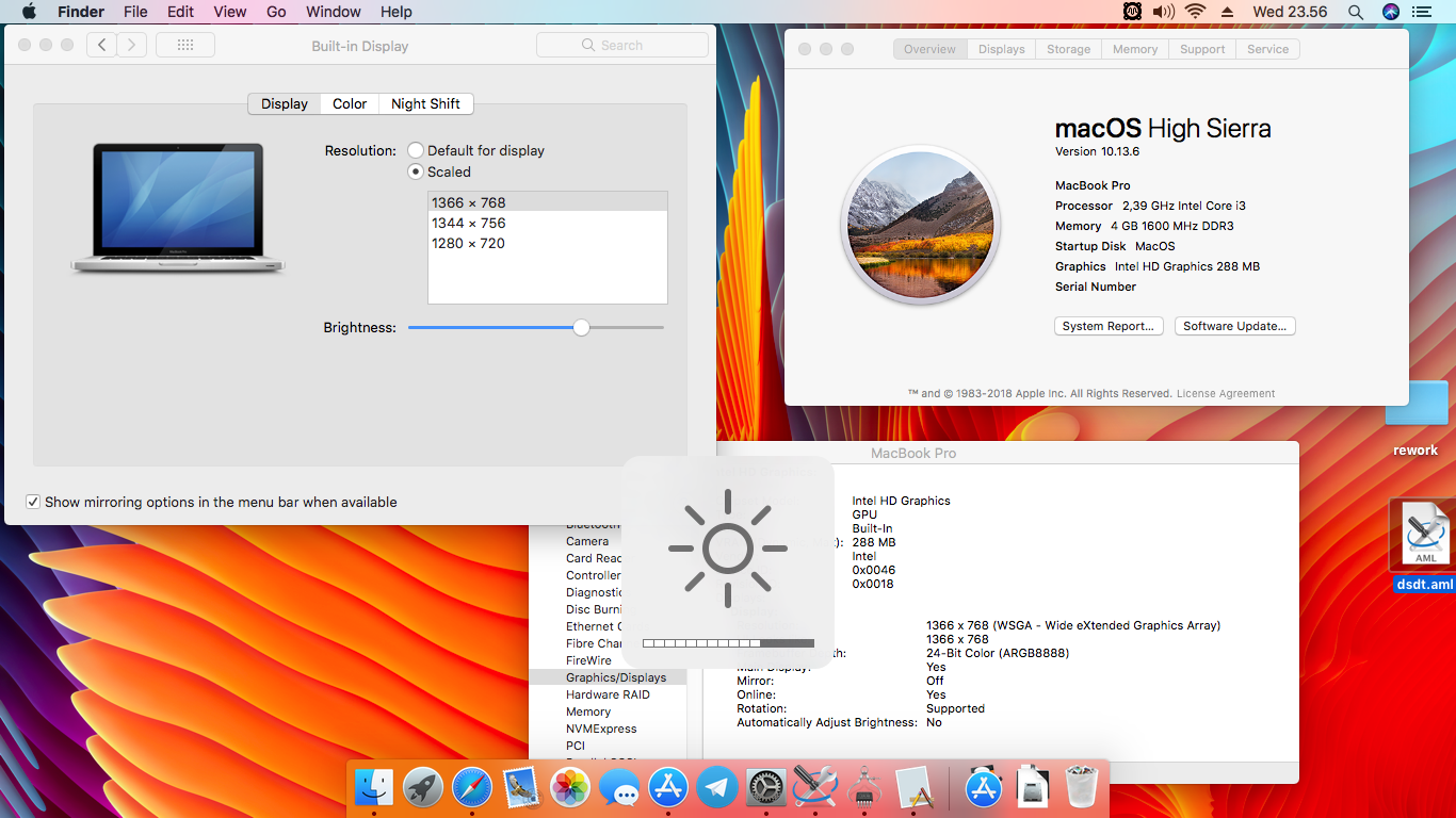

vanmoo Posted October 3, 2018 Share Posted October 3, 2018 (edited) How to enable graphics brightness, please update your guide, im using High Sierra 10.13.6, it shown in the syspref but didn't affect the display, https://imgur.com/a/MqBreOn Edited October 3, 2018 by RiskyRis image 2 Link to comment Share on other sites More sharing options...

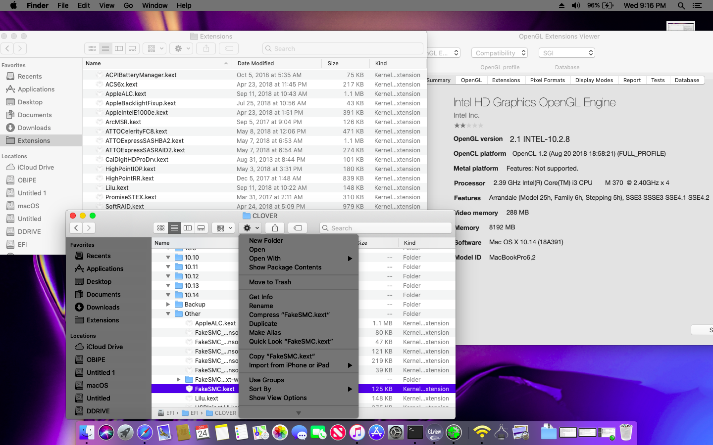

nijhawank Posted October 25, 2018 Share Posted October 25, 2018 On 6/21/2018 at 5:53 PM, Badruzeus said: Fyi, my friend's 1st Gen. Intel HD Graphics is working fine with QE/CI enabled under macOS Mojave Beta 2 using patched AppleIntelHDGraphics*.kext from Sierra (16A323: 1st MAS Release). Have you tried with this? On 6/24/2018 at 5:55 AM, MacPeet said: Wow... I also have QE/CI with Mojave. I have again installed my 5 patched Intel Kext's and IOAcceleratorFamily2.kext from the HS with KextUtility. Now QE / CI non metal works with unsupported SMBIOS MacBookPro 6.1. Now everything works. VLC, Youtube-Video's works DVD player plays DVD's ... Hi Badruzeus, MacPeet, I am able to get full hardware acceleration on my T410i with Sierra Kexts and Yosemite / El Capitan Patched FB Kext. However, I notice that the sidebar of the active finder window or menubar/dropdown-options are very dark (this is not dark mode). See in the attached screenshot. Is it a problem or it is like that? How can I have the sidebar or menubar (including top menubar) with base color white. The sidebar base color is white in the inactive window. I don't see this in Badruzeus screenshot. His top menubar is simply transparent and shows the underneath blue. But your's (MacPeet) and mine top menu bar are not transparent but rather dark grey. Also, is there a way to make the backlight brightness work? Thanks. My screenshot... 1 Link to comment Share on other sites More sharing options...

vanmoo Posted October 29, 2018 Share Posted October 29, 2018 @MacPeet i found workaround for the brightness problem on This graphics. 1. Patch dsdt for brightness using this guide or @mnorthern guide. 2. After that use IntelBacklit driver from rehabman, delete ACPIBacklit 3. Download Brightness By bergdesign 4. Voila you have working brightness on High Sierra Notes : The slider that shown on Syspref became only cosmetic, fn brightness keys works but not affecting the display Proof : Proof brightness control working Link to comment Share on other sites More sharing options...
