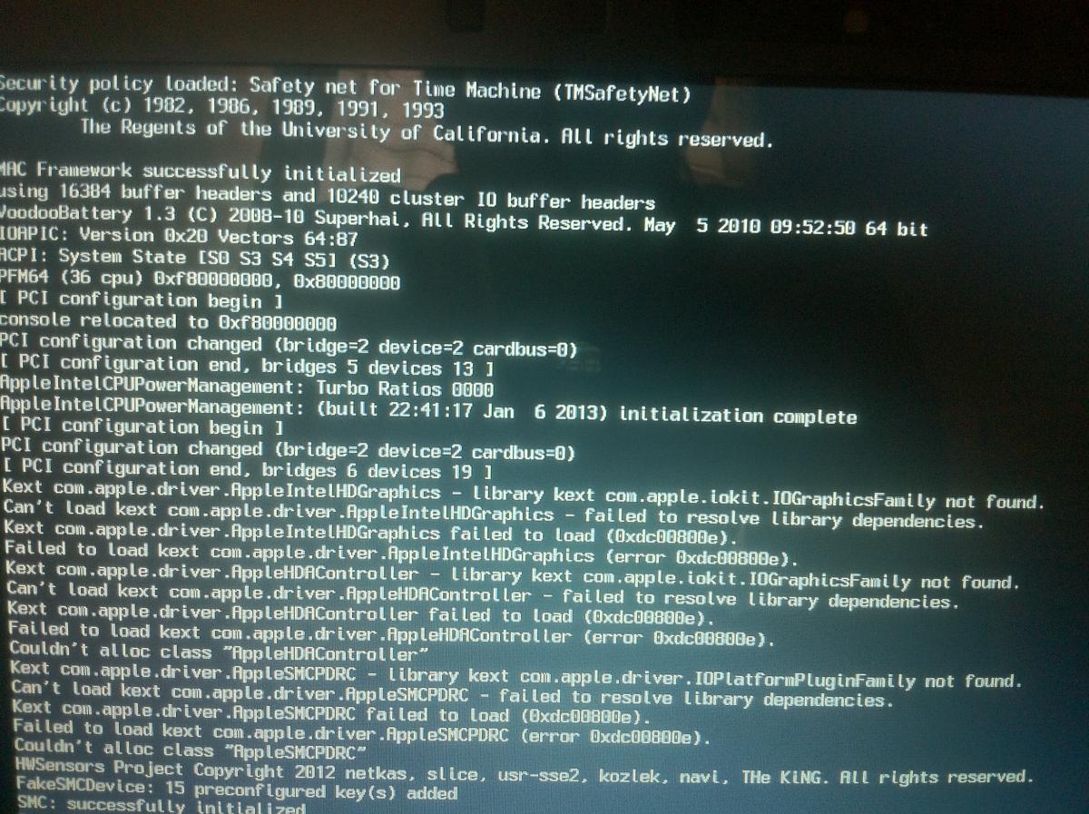

real_didi Posted April 29, 2013 Share Posted April 29, 2013 Hi! I've installed ML 10.8.3 using pandora box to my Toshiba Portege R705 laptop with i3 350m and intel hd graphics. I've deleted all intel hd graphics kexts but after reboot I still have shadows and animations. GraphicsEnabler=Yes When I try to load with attached kexts in first post the AppleIntelHD.kext is not loading and I have distortions on screen. Without graphics kexts I have 1280x800 resolution. But my laptop display resolution is 1366x768. Error when loading patched kext is: IOGraphicsFamily not found. Failed to resolve dependencies. I have tried to delete AppleIntelHDGraphics.kext and install some frame buffer kexts from first post but there was no visible changes - all boots with 1280x800. Display identified as external standard display. Also there is some artifacts while animations. Graphics card is identified as IntelHD2000 64mb. With natit as IntelHD 128mb. Tried macBookPro 6.2 smbios, now using 8.1 smbios. No changes. Please help me to find some way to enable graphics with native res. Thanks for your time. Here is error while loading HdGraphics kext: Link to comment Share on other sites More sharing options...
GhostRaider Posted April 29, 2013 Author Share Posted April 29, 2013 Hi! I've installed ML 10.8.3 using pandora box to my Toshiba Portege R705 laptop with i3 350m and intel hd graphics. I've deleted all intel hd graphics kexts but after reboot I still have shadows and animations. GraphicsEnabler=Yes When I try to load with attached kexts in first post the AppleIntelHD.kext is not loading and I have distortions on screen. Without graphics kexts I have 1280x800 resolution. But my laptop display resolution is 1366x768. Error when loading patched kext is: IOGraphicsFamily not found. Failed to resolve dependencies. I have tried to delete AppleIntelHDGraphics.kext and install some frame buffer kexts from first post but there was no visible changes - all boots with 1280x800. Display identified as external standard display. Also there is some artifacts while animations. Graphics card is identified as IntelHD2000 64mb. With natit as IntelHD 128mb. Tried macBookPro 6.2 smbios, now using 8.1 smbios. No changes. Please help me to find some way to enable graphics with native res. Thanks for your time. Here is error while loading HdGraphics kext: There is something wrong with your Pandora installation. How can you not have IOGraphicsFamily? Maybe you should create a new installer without Pandora. Maybe try myHack or something. Make a USB installer not DVD. It's the best way to avoid errors like that. Link to comment Share on other sites More sharing options...
real_didi Posted April 29, 2013 Share Posted April 29, 2013 There is something wrong with your Pandora installation. How can you not have IOGraphicsFamily? Maybe you should create a new installer without Pandora. Maybe try myHack or something. Make a USB installer not DVD. It's the best way to avoid errors like that. There is IOGraphicsFamily kext in S/L/E i've checked this. checked permissions. I can't understand why it can't be found when loading AppleIntelHDGraphics.kext. I tried ignoreKernelCache yes/no but still no luck. Also I've installed this system from usb. 1 Link to comment Share on other sites More sharing options...
GhostRaider Posted April 29, 2013 Author Share Posted April 29, 2013 There is IOGraphicsFamily kext in S/L/E i've checked this. checked permissions. I can't understand why it can't be found when loading AppleIntelHDGraphics.kext. I tried ignoreKernelCache yes/no but still no luck. Also I've installed this system from usb. You might have a corrupted IOGraphicsFamily kext. Problem is who knows if the other kexts are corrupted too which is going to be real hard to fix and might prevent you from enabling QE/CI. Link to comment Share on other sites More sharing options...

real_didi Posted May 3, 2013 Share Posted May 3, 2013 You might have a corrupted IOGraphicsFamily kext. Problem is who knows if the other kexts are corrupted too which is going to be real hard to fix and might prevent you from enabling QE/CI. I've made a clean install of 10.8.3 using myHack. Now hdGraphics.kext is loading ok. But I can't find framebuffer that works. I've made a lot of reboots with different combinations of kexts and framebuffers. I've managed to boot only with grey screen, all other are stuck after dsmos has arrived. Through VNC i saw "no display detected" in about Mac/displays while boot with grey screen. I got data from edid and intel_reg_dumper under Linux. Edid call is failed. Seems there's no edid for my panel. Panel is lvds x1 width. I patched framebuffer but got grey screen(no network was available to VNC). Also tried to alter values to 0 in info.plist of patched framebuffer - stuck at load. I have no ideas what to do next. I tried native kexts with all framebuffers, 2bad0's package, natit/no-natit/natit-w-only-os-info. Almost all stuck, others got grey screen. Link to comment Share on other sites More sharing options...
