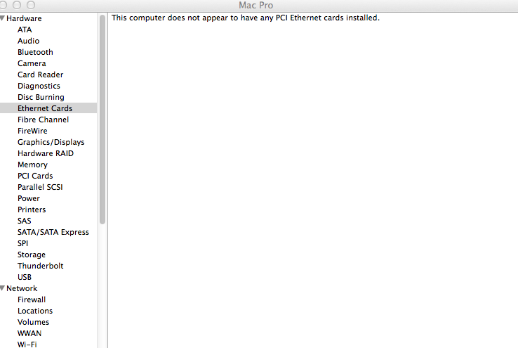

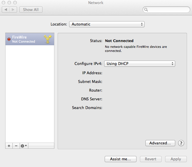

skwakk Posted June 11, 2014 Share Posted June 11, 2014 Hello everyone! I've been following this thread and finally got my build running except I can't get my ethernet, thunderbolt to work. From what I've read they should work right out of the box. I'm running 894M bios version and tried to follow the wiki for vanilla install. Is there anything I need to change to get Gigabit ethernet working? The thing is ethernet is actually 'enabled' but for some reason it doesn't work. Same thing with thunderbolt. I only plan to use the thunderbolt for storage raid devices. I would appreciate any help. thanks! My system: Z77mx-quo-aos 3770K i7 intel cpu Corsair Vengeance 16GB RAM Samsung EVO 250GB ssd Corsair HX750 PSU Link to comment Share on other sites More sharing options...

ntsmkfob Posted June 12, 2014 Share Posted June 12, 2014 Can someone tell me the device id for the intel gigabit ethernet of this board? I'm still trying to get my internet working. This works out of the box. You must have something else wrong. The device is 0x10f6 (Intel is 0x8086). It is supported by Intel82574L.kext in IONetworkingFamily.kext Go to About This Mac and look to see if its shown under Ethernet Cards as Intel 82574L. If not its probably a BIOS issue. Try reset to defaults or reburn the BIOS. Link to comment Share on other sites More sharing options...
THe KiNG Posted June 12, 2014 Share Posted June 12, 2014 "OS X compatible" doesn't actually means "works OOB" You are wrong, it does work OOB(if you ignore the BIOS update...). Hello everyone! I've been following this thread and finally got my build running except I can't get my ethernet, thunderbolt to work. From what I've read they should work right out of the box. I'm running 894M bios version and tried to follow the wiki for vanilla install. Is there anything I need to change to get Gigabit ethernet working? The thing is ethernet is actually 'enabled' but for some reason it doesn't work. Same thing with thunderbolt. I only plan to use the thunderbolt for storage raid devices. I would appreciate any help. thanks! My system: Z77mx-quo-aos 3770K i7 intel cpu Corsair Vengeance 16GB RAM Samsung EVO 250GB ssd Corsair HX750 PSU As a newcomer at first you need to respect the "house rules", add to your signature your specs and more important your BIOS version, if you want to get a reply quick... LAN should work unless is defective or you have other board. Anyway, as a good friend of mine say, without dumps we can't know what is going on there... So, I will save your topic reading time, here is what you have to do: From F12 menu select UEFI: Built-In EDK Shell Once there type bdmesg -b then press Enter Note first line when it say Ozmosis version. Scroll till you see Found Intel LAN Controller if on [] is not [8086:10F6] then you have a problem. Link to comment Share on other sites More sharing options...
skwakk Posted June 12, 2014 Share Posted June 12, 2014 This works out of the box. You must have something else wrong. The device is 0x10f6 (Intel is 0x8086). It is supported by Intel82574L.kext in IONetworkingFamily.kext Go to About This Mac and look to see if its shown under Ethernet Cards as Intel 82574L. If not its probably a BIOS issue. Try reset to defaults or reburn the BIOS. Yeah..that's what I thought too that it might be a bios problem. by reburning the bios do you mean reflashing? because i tried reflashing 894M down to 828M then back again with no luck. I also tried OS X 10.8 instead of Mavericks..but still the same. I plugged in my Windows partition and it works..so it can't be the board itself. You are wrong, it does work OOB(if you ignore the BIOS update...). As a newcomer at first you need to respect the "house rules", add to your signature your specs and more important your BIOS version, if you want to get a reply quick... LAN should work unless is defective or you have other board. Anyway, as a good friend of mine say, without dumps we can't know what is going on there... So, I will save your topic reading time, here is what you have to do: From F12 menu select UEFI: Built-In EDK Shell Once there type bdmesg -b then press Enter Note first line when it say Ozmosis version. Scroll till you see Found Intel LAN Controller if on [] is not [8086:10F6] then you have a problem. Thanks King! I'm using Ozmosis H3B.894M...also the dump does say 'Found Intel Lan Controller [8086:10F6].. I don't think its defective because I plugged in my windows partition and it just worked. I tried reflashing the bios to 828M also with same results. Any ideas what could be wrong? Link to comment Share on other sites More sharing options...
THe KiNG Posted June 12, 2014 Share Posted June 12, 2014 ... I plugged in my Windows partition and it works..so it can't be the board itself. ... I don't think its defective because I plugged in my windows partition and it just worked. I tried reflashing the bios to 828M also with same results. Any ideas what could be wrong? If works on windows then can be: - your internet settings(how is setup on windows, what kind of internet connection you have, is it PPOE, does require you to use user/password?) - your router(are you using one?) - broken OS drivers by user mistake Link to comment Share on other sites More sharing options...
skwakk Posted June 12, 2014 Share Posted June 12, 2014 If works on windows then can be: - your internet settings(how is setup on windows, what kind of internet connection you have, is it PPOE, does require you to use user/password?) - your router(are you using one?) - broken OS drivers by user mistake The thing is in OS X..I can't even setup the internet because the ethernet is not recognized. Under system profiler>Ethernet Cards..it says "This computer does not appear to have any PCI Ethernet cards installed." Also when you go to System Preferences>Network..There's no ethernet either..only Firewire. I tried flashing different bios versions (894M, 828M, 820M). I reset CMOS. I tried Mountain Lion and Mavericks..but same result. I even tried using different USB flash drives on different usb ports for the flashing and installing. Link to comment Share on other sites More sharing options...
THe KiNG Posted June 12, 2014 Share Posted June 12, 2014 The thing is in OS X..I can't even setup the internet because the ethernet is not recognized. Under system profiler>Ethernet Cards..it says "This computer does not appear to have any PCI Ethernet cards installed." Also when you go to System Preferences>Network..There's no ethernet either..only Firewire. Use http://www.insanelymac.com/forum/topic/282794-darwindumper/ , make full dump and upload the zip. Link to comment Share on other sites More sharing options...
skwakk Posted June 12, 2014 Share Posted June 12, 2014 Use http://www.insanelymac.com/forum/topic/282794-darwindumper/ , make full dump and upload the zip. PMd you the zip..thank you! Link to comment Share on other sites More sharing options...

THe KiNG Posted June 12, 2014 Share Posted June 12, 2014 PMd you the zip..thank you! Found the error: Jun 11 23:39:03 localhost kernel[0] <Debug>: 0x1fad9eef, 0x00000000 Intel82574L::start - NVM Checksum incorrect Jun 11 23:39:03 localhost kernel[0] <Debug>: 0x1fad9eef, 0x00000000 Intel82574L::validateEEPROM - EEPROM checksum is incorrect Jun 11 23:39:03 localhost kernel[0] <Debug>: 0x1fad9eef, 0x00000000 Intel82574L::start - failed to validate EEPROM Did you tried to play with LAN eeprom(flash/update)? You need to fix LAN eeprom checksum, if you don't know how, I will try to put an easy way for you to do it, let me know... 3 Link to comment Share on other sites More sharing options...
