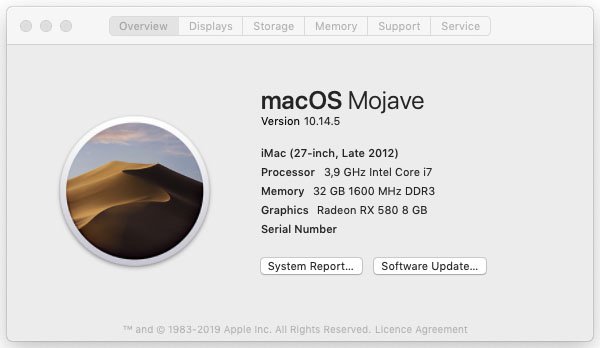

Hi! I used a preinstalled system 10.14.5 and could not proceed (blind screen after fruit logo)
Finally, succeeded by adding the following options to Defaults.plist (It is possible that only some of them are directly necessary).
Z77MX-QUO-AOS@167X-XMAX-E
i7-3770k
32GB RAM
RX580 Sapphire
i7-3770k
32GB RAM
RX580 Sapphire

Success! :thumbsup_anim: Thank you!
I have been trying with different BIOS settings according to how it was supposed to be set back in the days, obviously, it does not work anymore. This combined with different defaults just made too many combinations to get sorted.
I'm just wondering about the internal GFX, do you have it activated? Because for me with AUTO, it is disabled.
17 minutes ago, elviejo said:
You must use the latest rom posted by IronManJFF at the top of this page and a plist actualized to the last firmware ( several pages back I posted one with macmini8,1 configuration ) you could integrate the plist on the rom or use it in the Oz EFI folder, obtain the serial number with clover configurator. Good luck
Yes, it seems to be my BIOS settings that made this upgrade way harder than it actually was...
Thanks to everyone helping me! And a special thank you to IronManJFF for the BIOS! :D

I recently installed Sapphire Nitro RX580 card, and then experienced significant slow downs and freezes, especially when using Photos.
I didn't make the connection with the RX580 card and the issue right away.  I have a large Photos library (500gb) and first performed repair of Photos library, and even recreated the Library (and imported the master images). Then I reformatted the startup drive with clean install of High Sierra, but still had issues with slow down and freezing.  Finally, after I pulled the RX580 card and used integrated graphics again, the computer was back to its stable self.
I found reported cases of freezing with this card and Photos which was related to mediaanalysisd in background with fix using the following:
sudo rm /System/Library/LaunchAgents/com.apple.mediaanalysisd.plist"
Others stated resolution with upgrade to Mojave.  I tried updating to Mojave, but got stuck mid-install due to my inability to add disable_nvflags=1 option to  fsx:\macos Install Data\Locked Files\Boot Files\com.apple.boot.plist.  So for now I am still using High Sierra.
Anyone else experience similar issues with this card?
