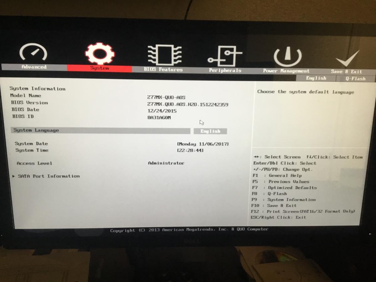

jonahlee Posted November 6, 2017 Share Posted November 6, 2017 Have you recently added some new usb bus powered devices .. Maybe you a simply requesting too much current from the USB bus ... Other things you can try : Clear NVRAM, revome files in /Library/Preferences/SystemConfiguration/ Sent from my iPad using TapatalkIf you remove the Wacom tablet .. Do you still have issues with the mouse right-click and vice-versa ? Sent from my iPad using Tapatalk I tried zapping PRAM, but now it is booting directly to the EFI shell. I can hold down option and get to the system selector, but when i try and start from my hard drive, the system just shuts down. The same thing if I try for the recovery partition, or if i directly try and boot from the bios options. I tried plugging in a backup system via USB 3, but the same thing happens. When I try and start from it the system just shuts down after the screen going black for a while. Does anyone have any ideas. The system will not boot at all now. The system is running El Capitan with the following defaults plist. It was working except the usb issues until i trued zapping the pram. <?xml version="1.0" encoding="UTF-8"?> <!DOCTYPE plist PUBLIC "-//Apple//DTD PLIST 1.0//EN" "http://www.apple.com...yList-1.0.dtd"> <plist version="1.0"> <dict> <key>Version</key> <string>1.0.1</string> <key>Date</key> <integer>0</integer> <key>Defaults:7C436110-AB2A-4BBB-A880-FE41995C9F82</key> <dict> <key>boot-args</key> <string>-v</string> <key>csr-active-config</key> <integer>103</integer> </dict> <key>Defaults:1F8E0C02-58A9-4E34-AE22-2B63745FA101</key> <dict> <key>DisableNvidiaInjection</key> <true/> <key>BootEntryTemplate</key> <string>$label</string> <key>DarwinDiskTemplate</key> <string>$label $platform.$major.$minor</string> <key>DarwinRecoveryDiskTemplate</key> <string>$label $platform.$major.$minor</string> </dict> </dict> </plist> Link to comment Share on other sites More sharing options...

IronManJFF Posted November 12, 2017 Share Posted November 12, 2017 I tried zapping PRAM, but now it is booting directly to the EFI shell. I can hold down option and get to the system selector, but when i try and start from my hard drive, the system just shuts down. The same thing if I try for the recovery partition, or if i directly try and boot from the bios options. I tried plugging in a backup system via USB 3, but the same thing happens. When I try and start from it the system just shuts down after the screen going black for a while. Does anyone have any ideas. The system will not boot at all now. The system is running El Capitan with the following defaults plist. It was working except the usb issues until i trued zapping the pram. <?xml version="1.0" encoding="UTF-8"?> <!DOCTYPE plist PUBLIC "-//Apple//DTD PLIST 1.0//EN" "http://www.apple.com...yList-1.0.dtd"> <plist version="1.0"> <dict> <key>Version</key> <string>1.0.1</string> <key>Date</key> <integer>0</integer> <key>Defaults:7C436110-AB2A-4BBB-A880-FE41995C9F82</key> <dict> <key>boot-args</key> <string>-v</string> <key>csr-active-config</key> <integer>103</integer> </dict> <key>Defaults:1F8E0C02-58A9-4E34-AE22-2B63745FA101</key> <dict> <key>DisableNvidiaInjection</key> <true/> <key>BootEntryTemplate</key> <string>$label</string> <key>DarwinDiskTemplate</key> <string>$label $platform.$major.$minor</string> <key>DarwinRecoveryDiskTemplate</key> <string>$label $platform.$major.$minor</string> </dict> </dict> </plist> What is the last thing you see when you try to boot the system ? Sorry I am very late , @work been crazy lately I've established that I can do a fresh install of 10.13.1 to a USB drive, using a real Macmini, and it runs on the Quo without problem. I've removed IronmanJFF's SSDT, although it did boot OK once prior to removing it and I believe I have the right firmware info in my Defaults.plist (attached). I can't get past the firmware error if I try to update 10.12.6, though and feel I need to be able to do this before moving my working system to HS. Has anyone managed to do an update as yet? Defaults.plist.zip You can try these values, they work for iMac13,2 ... don't know if they will for MacMini <key>FirmwareFeatures</key> <integer>0xE907F537</integer> <key>FirmwareFeaturesMask</key> <integer>0xFFFFFFFF</integer> Link to comment Share on other sites More sharing options...
