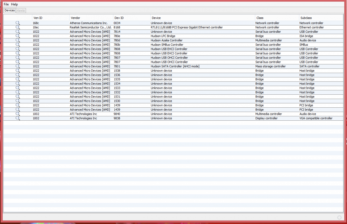

I disassembled an old GT210 and I installed it temporarily on A4-3400 .. now boot, it not stops at "System uptime in nanoseconds," but it gives me an error "PCI Parity ERROR" Press f1 or f2.. Keyboard freezed.
How do I fix it?
I can't disable AGP, but I can select PCIe Graphics (PEG)..
Edit:
I use a USB flash disk with OS X Install version, hdd is on Sata0 (i tried the other Sata1, sata2, sata3..)
3097-SystemInfoWin.zip don't work..
You have fixed the problem with your BIOS settings?

PCI Parity Error appears when I start any OS X that exceeds the "System uptime in nanoseconds" (ie with mckay_kernel 10.9 and 10.8 Bronya's kernel, -v cpus=1); with both the APU 6410D with both the GT210 ..
some bios settings wrong?
Virtualization Enabled
AHCI Enabled
AMD C6 support Enabled
COOL'n'QUIET Auto
Usb Controller Enabled
Usb Legacy FunctionEnabled
Usb Storage Function Enabled
Onboard LAN Function Disabled
HPET Support Enabled
---(no 64bit selection)
the bios has the latest version..
EDIT:
I did check the motherboard by a technician who has complete control with a pci card (a more elaborate version of memtest from what I understand, screen very similar) and did not detect any damage ..
Now I try to restore the CMOS..
EDIT 2: CMOS restored, no changes..
Edited by lfmg
